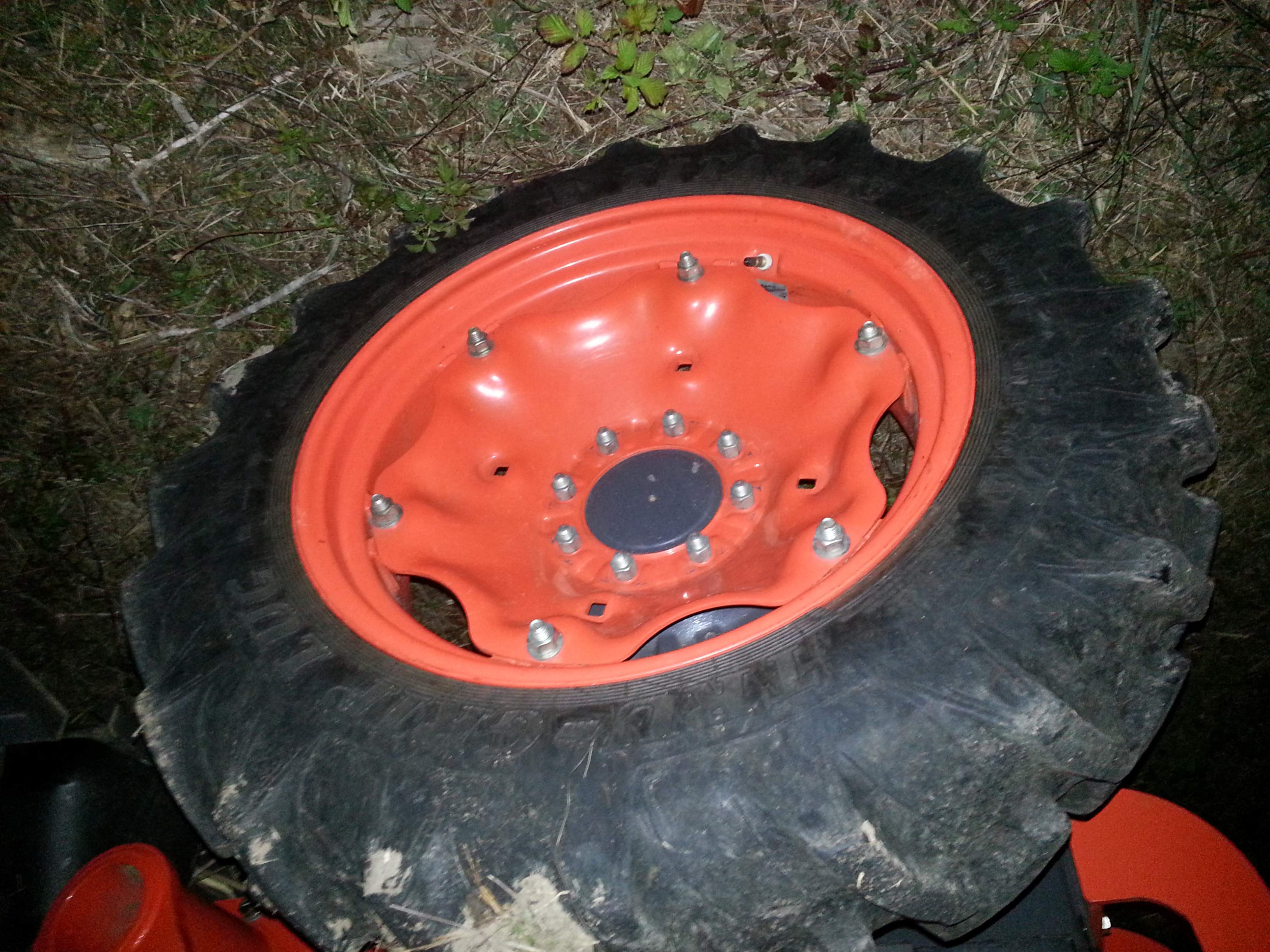

My left frt tractor get's nowhere close to touching the toolbox in a left hand turn. What size frt tires does your tractor have? Mine has 9.5X24's.
They dont come close at factory settings but widen your front stance by turning your rims around and see...
   / Toolbox for M7040 cab #12
I'm having a difficult time seeing how widening the frt tire spacing is going to get tire closer to the toolbox. Just how wide are your tractors frt tires?? I don't go to Casino's but I've been known to make a wager.
#13
I didn't think clearance would be an issue when I moved my tires either.... until they were moved, and it became an issue!
I don't have my tractor handy to take a pic of the wheel setup, I'll try to get a pic tonight when I go feed cows.
   / Toolbox for M7040 cab #14
Would a wider tire come closer to toolbox? Same diff. moving the tire out 6inches....
   / Toolbox for M7040 cab #15
I was thinking larger diameter not width.
#16
Here is the pic of my tire/wheel setup. I flipped the dish, then swapped sides on the rims. Seems like I went from a 59" center to center, to a 66 or 68" center to center, ~4" on each side..
I didn't realize the pic was upside down until I uploaded it....
