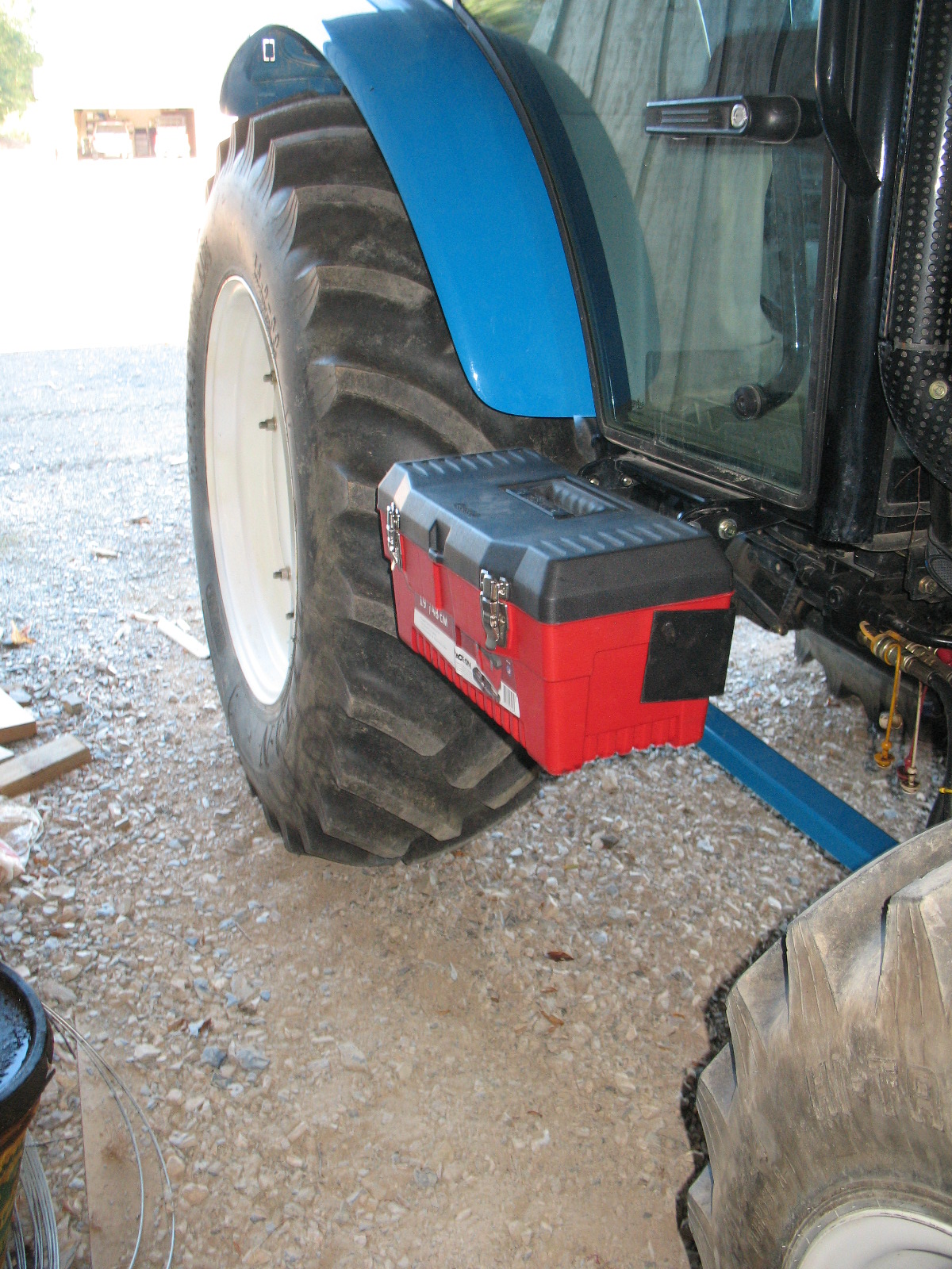

This is what I did to my M8540, works great!

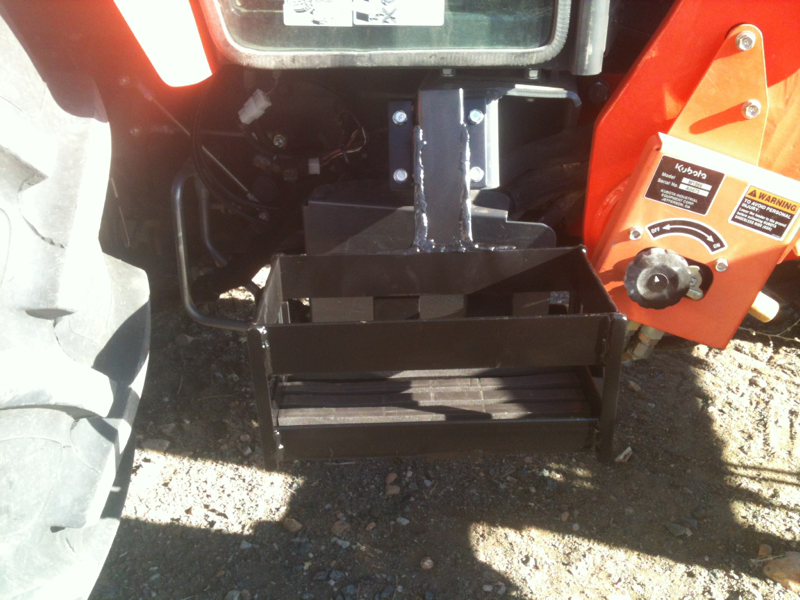

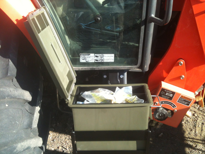

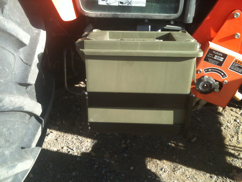

This is what I did. Since I hardly ever used the right side steps I removed them and used the mounting point to attach my tool box bracket. It is as high as I could get it and still open the cab door. NOT a huge box but plenty big to keep a 4 pound shop hammer, 15" crescent wrench, pins etc

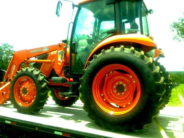

Here is the pic of my tire/wheel setup. I flipped the dish, then swapped sides on the rims. Seems like I went from a 59" center to center, to a 66 or 68" center to center, ~4" on each side..
I didn't realize the pic was upside down until I uploaded it....
