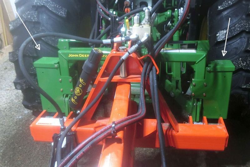

I decided to use KennyD's iMatch Chain Box (Bolt on Hooks) to hold a few tools . . . wish they were bigger, and I'm considering attaching two of the boxes side by side to hold more, but it would be easier if Ken would just make a bigger one with the same attachment setup.
FredSG
Very nice...where'd you get them? Link, if possible

Roy,
We're neighbors! Here is the link: John Deere iMatch™ Accessories - BoltOnHooks LLC
Just scroll down and you will see them. I have a pair on both of my JD Tractors - JD4310 & JD 4052R.
I'm in Northern Maine.
Fred

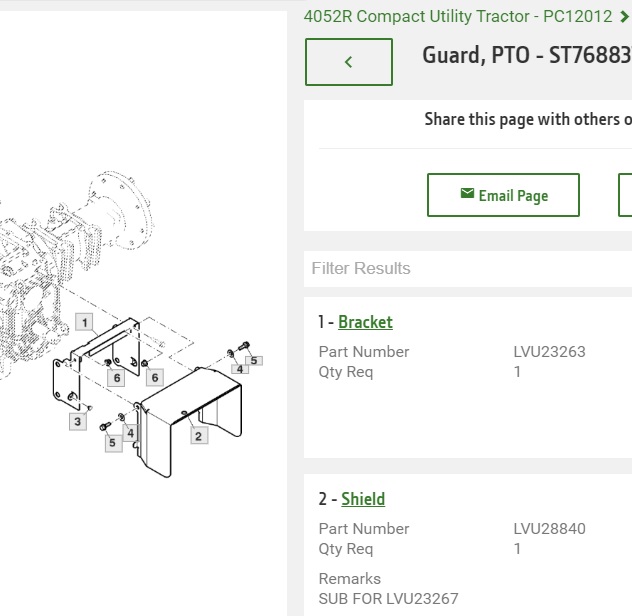

What I've found to make connecting PTO shaft to the tractor PTO easier is to remove the shield (PTO guard) from the tractor.
To me, just something else "in the way".
Keep thinking there should be a tool like a lever that will assist pushing the PTO shaft forward onto the stub while at the same time holding the spring-loaded collar back. The combination of pushing the shaft forward while pulling the collar backward will test the arm strength for sure.
Anyone have an idea or a method that works for them?
What I did was replace the spring in the collar with a softer one. That made attaching my 660 rototiller a lot easier.

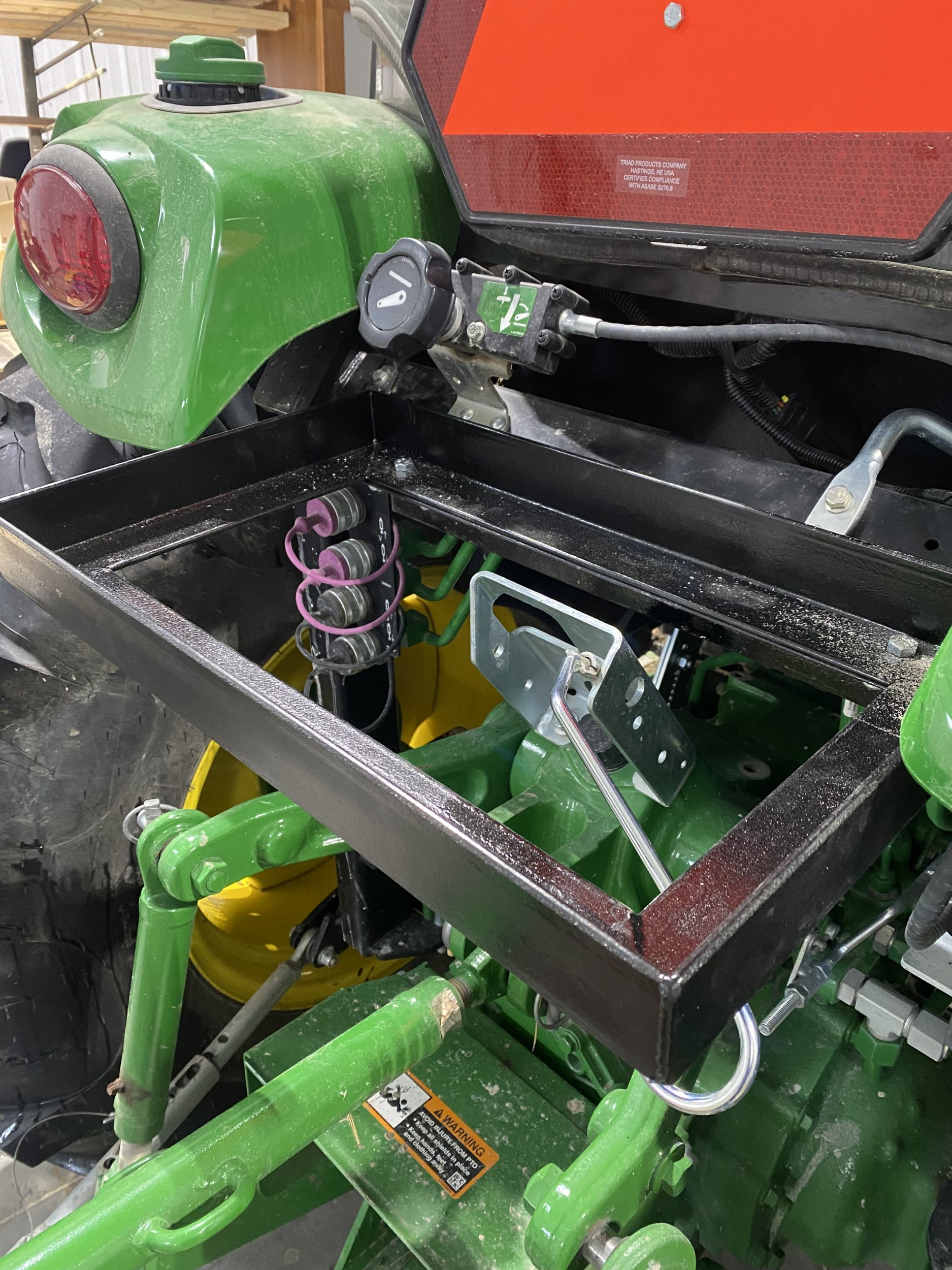

I'd like to add a tool box for things like a crescent wrench, lynch pins and such...unlike the 4520 with a Curtis Cab, the cab of the 4052 is quite nice and I'd like to keep it that way as long as possible.
I don't see any good place to mount a decent sized tool box...saw a picture of one mounted on the loader masts, but it wasn't Deere tractor and I'm not real crazy about drilling into that heavy cast iron of the H180 loader.
I've also seen pictures of an ammo box mounted on the quick hitch...I'm thinking there's adequate clearance even when the 3PH is fully raised and the QH is closest to the fenders. Right now, since the QH never comes off the 3PH, that would be the best option
I'm open to other suggestions...pictures, if possible
I am in the process of building a frame that will mount at the rear of my 4052R to hold a toolbox 20" x 9", I will post a picture when I am done.
/ Toolbox for 4052R Cab #33

#34
Good idea...except for limiting access to the windshield washer reservoir.
It's already pretty limited and I had to rig some plastic tubing to a funnel to fill mine

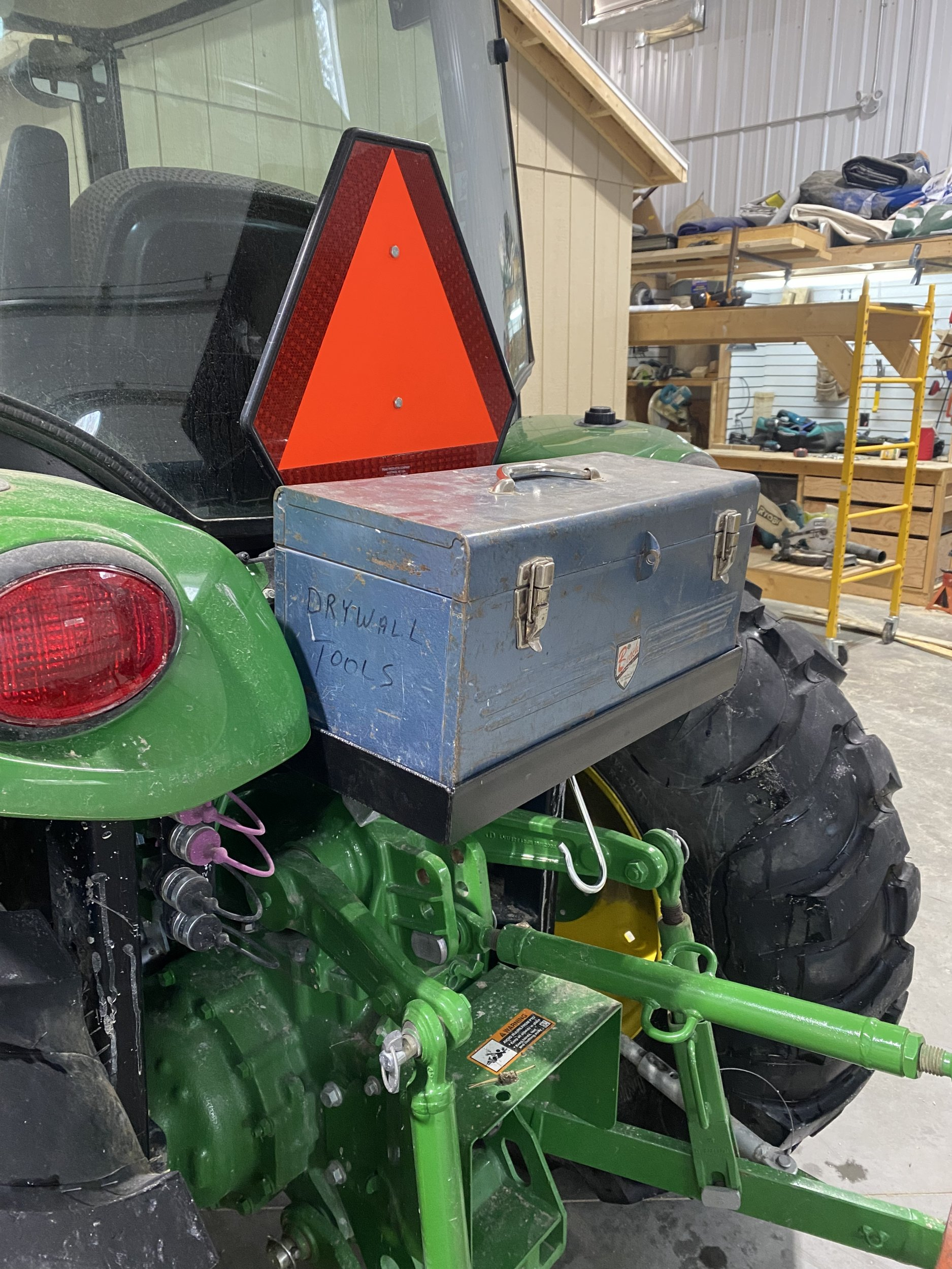

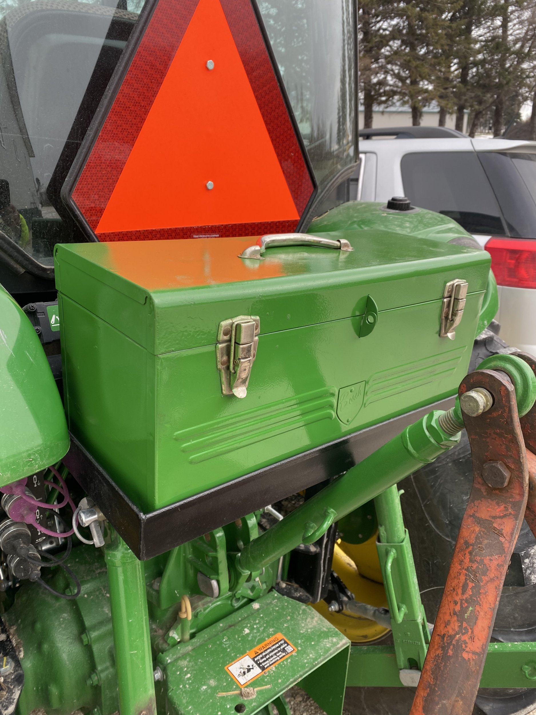

/ Toolbox for 4052R Cab #37
Finished product, very happy with it. John Deere wants $87 for this toolbox, I painted this one that I have had for over 40 years.
