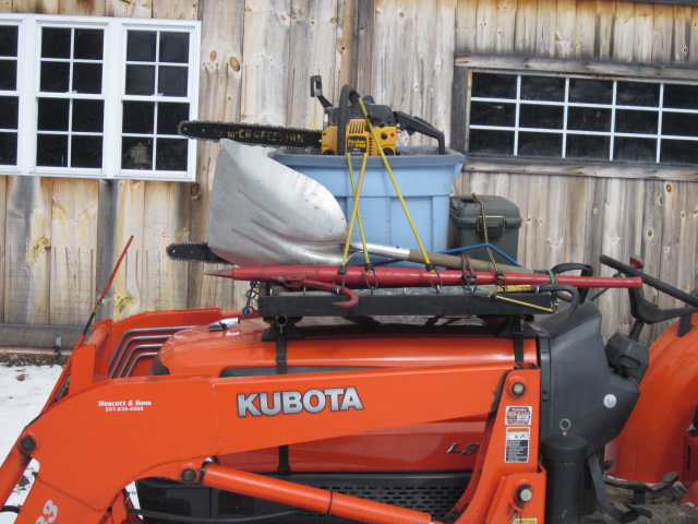

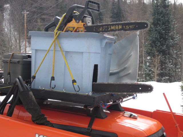

As I mentioned, that was an extreme load on the platform, which it handles fine. The Rubbermaid box contained a chainsaw, gas and oil containers, files and bar wrench and wedges - My self contained chainsaw kit. But heading to the woods for the day it's nice to have two saws, so I strapped a second one on top Rides fine when bungeed on. Returning from the woods pulling a full load in the trailer and a full load on the forks, it was nice to have a place for all the tools. More often, the platform gets loaded with hand tools depending on the job, and they sit low and don't affect vision.
But even with the big load you can see around it. Just like Casey Jones driving the steam engine.

I looked around for a place to carry shovels, rakes, and even chainsaws, without interfering with the bucket or 3ph. I decided that the area over the hood was an untapped resource. I modified a set of car-top carrier brackets to fit, and bolted on a piece of flakeboard with a 1x2 edge. Added lots of screw eyes for bungee cords. It's amazing how much can be carried there, and it's right up where you can keep an eye on it.
The platform doesn't interfere with opening the hood, just have to unload it first. All the equipment loaded on in the pictures is extreme, that was for going into the woods to cut firewood.

Regarding that platform on top of the hood, the project started out as just the pair of car-top carrier tubes. I used it like that for years, for carrying long tools like a shovel or a rake or a broom. In that form it wasn't too heavy. To hold the tools on, I wrapped a bungee cord around each tube, barber-pole style. I would slide the tool under the bungee cord to secure it. Just last year I got the bright idea to attach a platform on top of the tubes to be able to hold small things also. I like it so much that if it didn't work with the straps attaching it, I would bolt it right to the hood.
