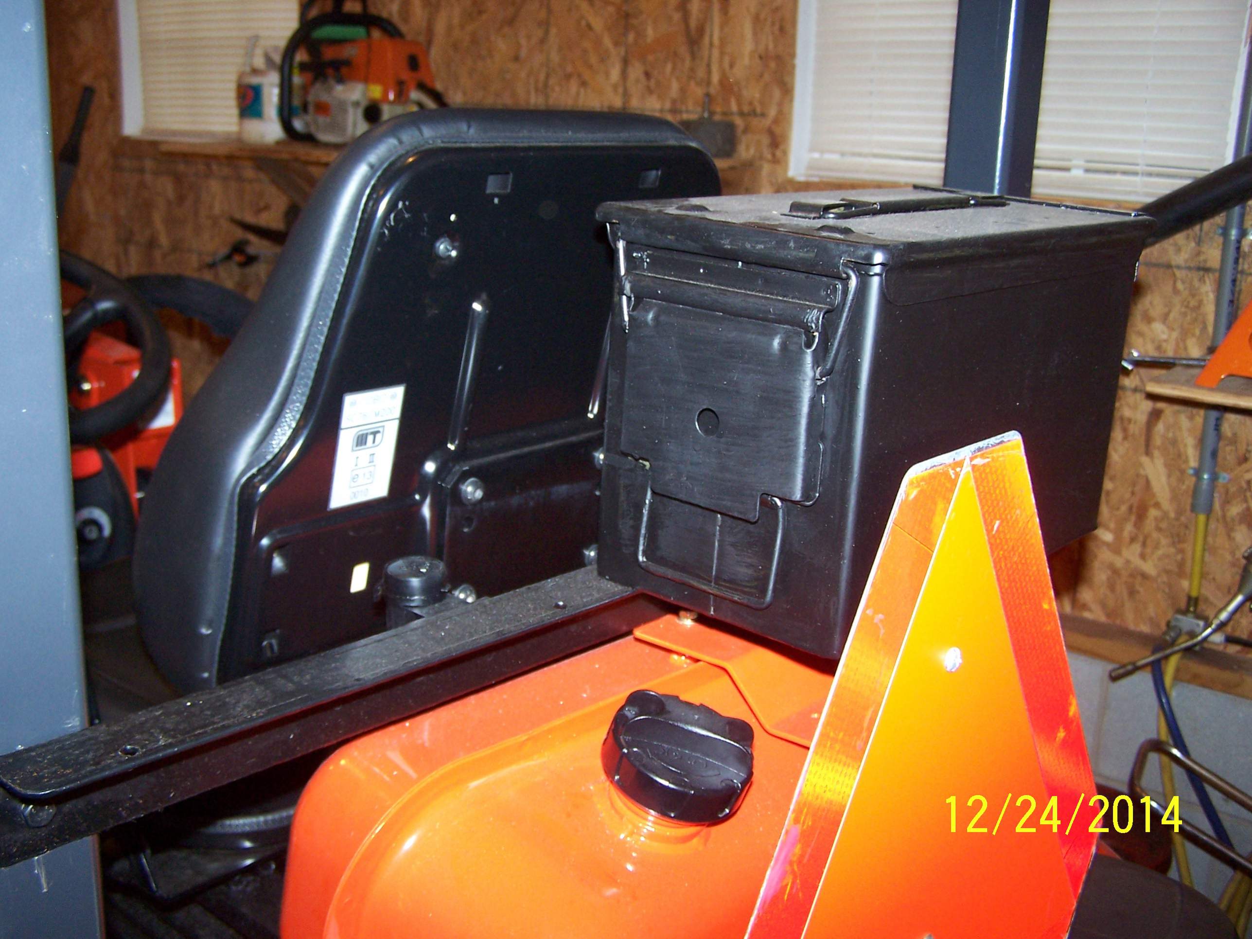

Hi PNWKioti,
I'm in the PNW as well! And I've got a 2015/2016 CK2510HST.
I put some angle iron between the roll bar posts, on top of that some aluminum plate and bolted to that an ammo box -- the slightly larger (wider) type. See pics. I can still see the ground in the back while sitting down.

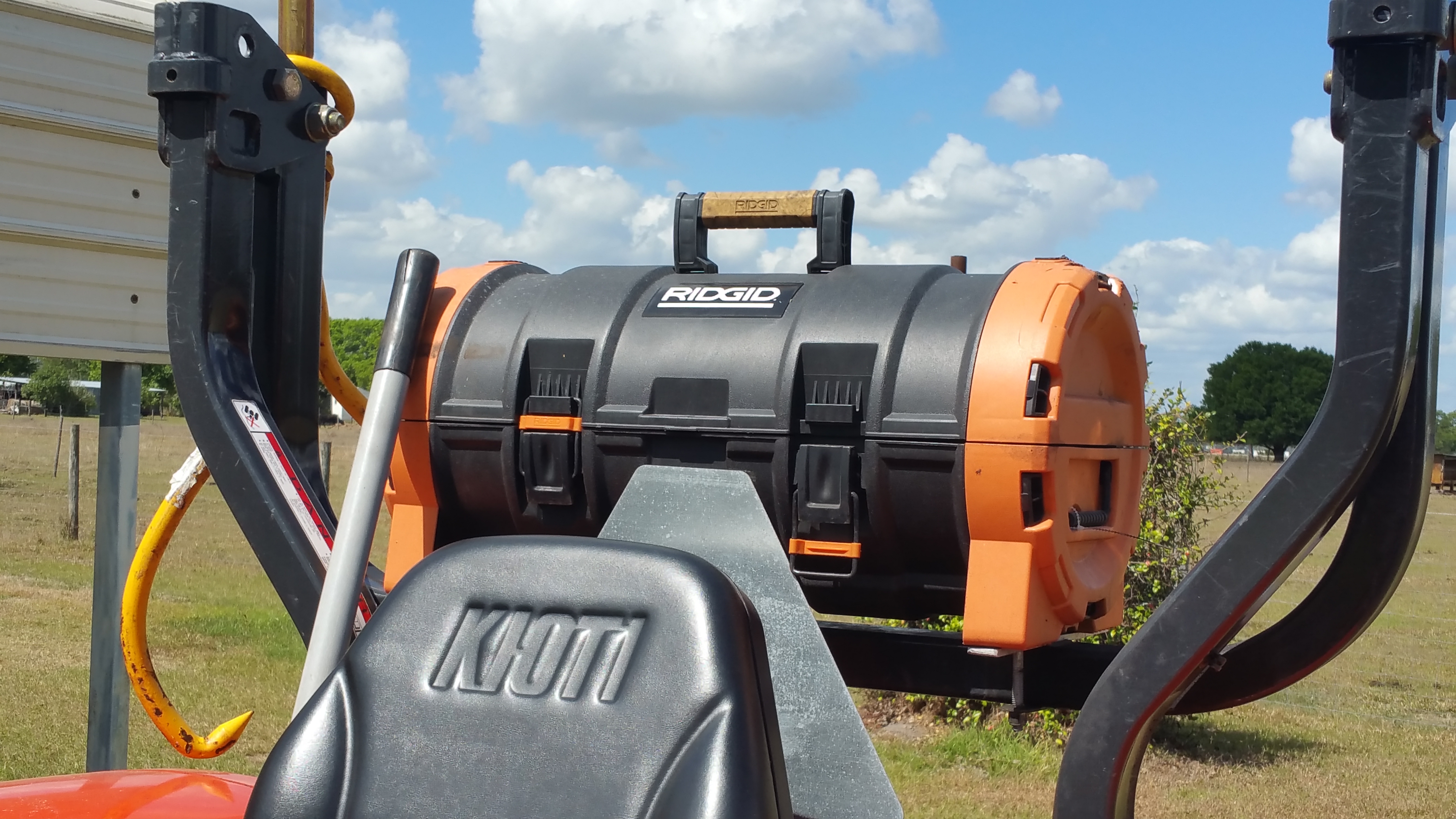

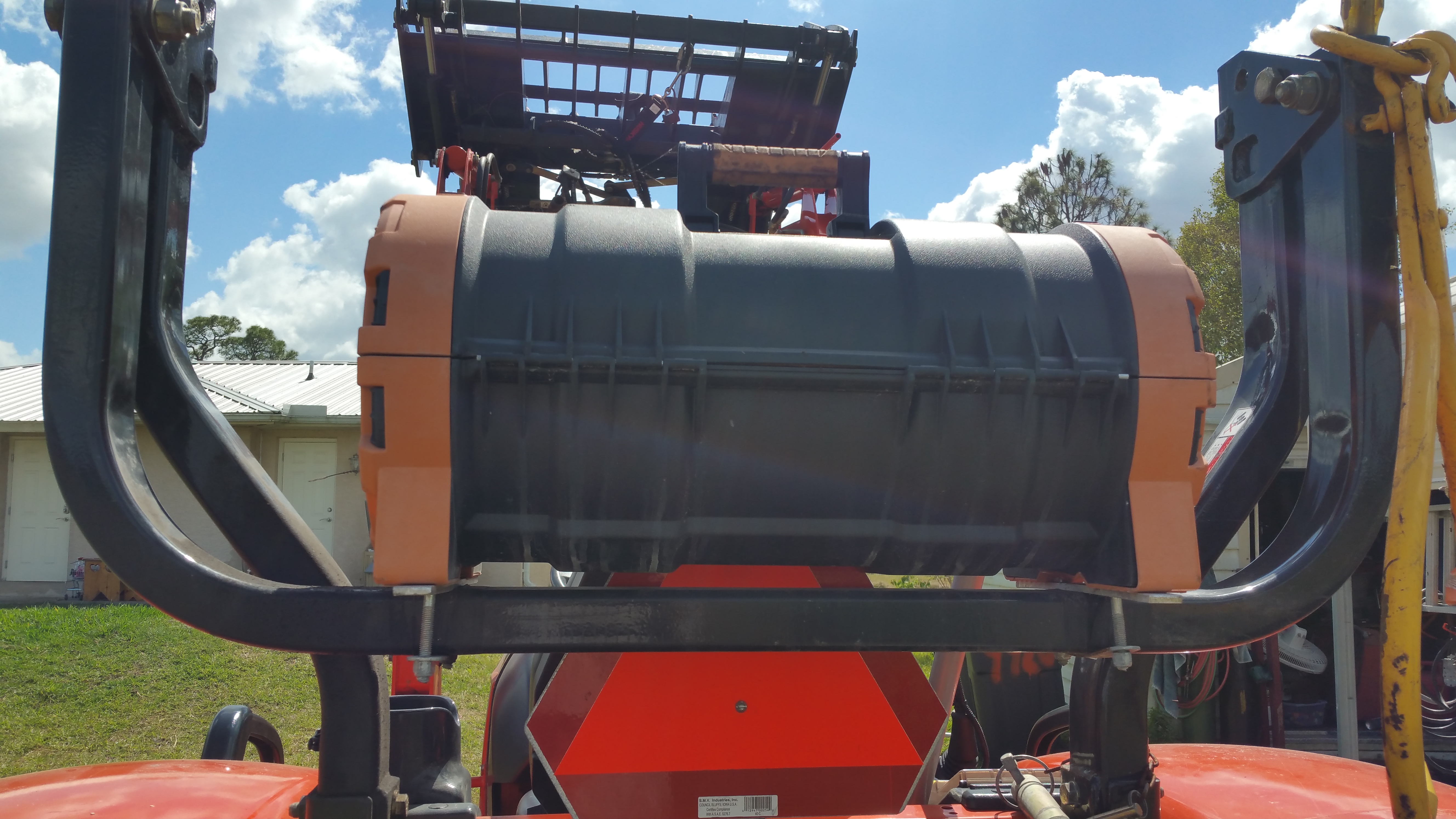

Few month old thread but I figured it would be the best place to post. I added this to my NX4510 recently, it holds everything I need and with it being round when I need the ROPS I just fold them up and everything just rolls down. Double walled and for $19.99 at H.D. it works perfect, only other advantage is it comes in orange.

That is a great idea. I'm planning on folding up my ROPS too as I really do not need it. I like your log tongs hanging there also.

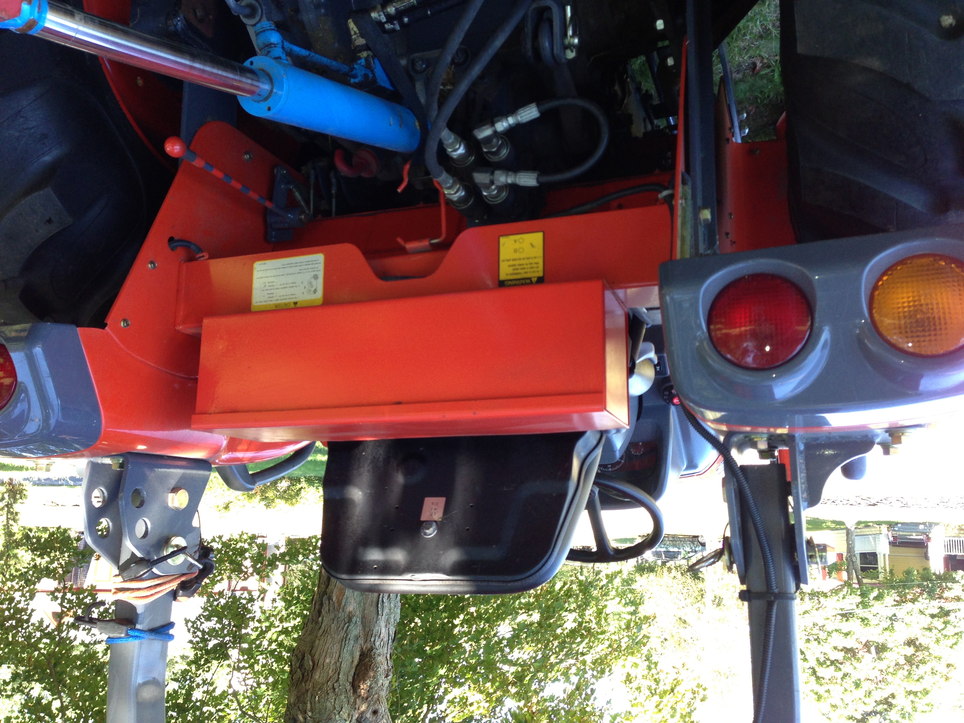

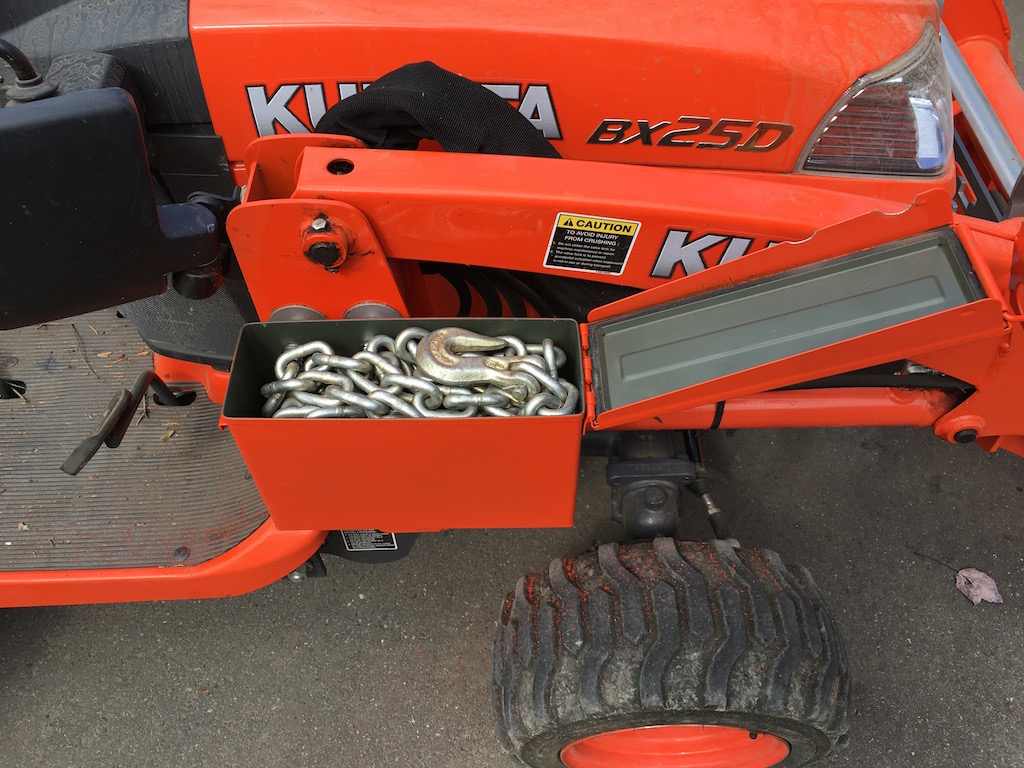

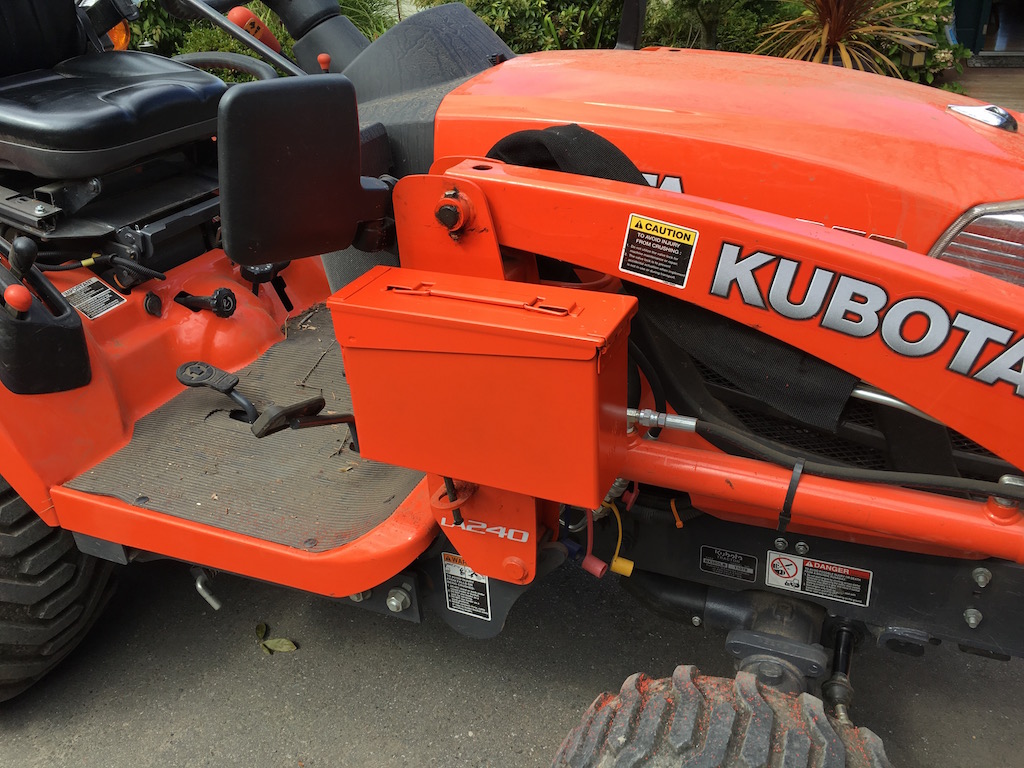

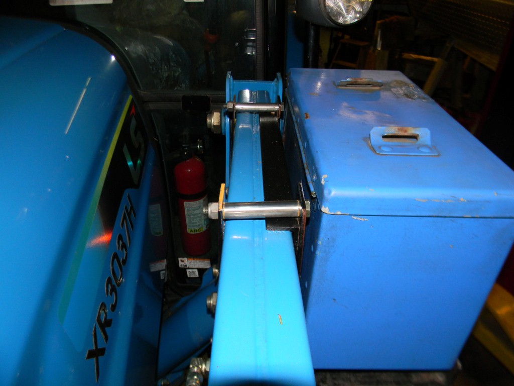

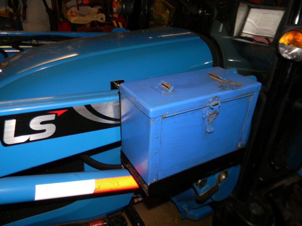

Originally I mounted a tool box on the back of the tractor. Bolt holes were already there and I thought it was a good place. Turns out I had to move it because it was too hard to get at the remotes to plug in or out.
I decided to attach the box to the loader arms. I put a piece of angle on top and bottom and welded most of my original toolbox bracket to vertical flat stock. Made two inside brackets out of flat stock and passed 4 bolts through round tubing to hold it in place. Pics attached of original location plus now on the arms.
