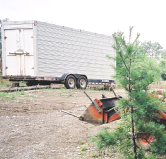

Yes, I have to get the rear tires up about 5 inches so the back hoe frame doesn't drag when loading.:D
My trailer was originally used to move household goods so it had a box on it. At that time the axles were also over slung so it sat lower. The axles have since been under slung so the trailer rides level, higher and allows for more clearance on the frame and suspension components. Previously it would bottom out on some rough roads and bent one axle. Also, in it's previous configuration I kept ripping the ramp holders off as they were quite low to the ground. :D
Dove tails definitely have their place and can be very versatile. With real equipment that is what I would probably have!:D
Picture of old set up with ugly box.
