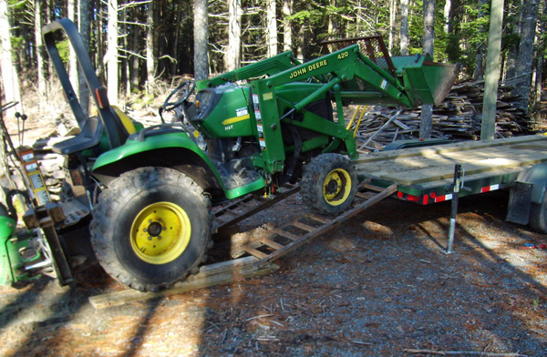

Picture showing tractor being loaded with rear jacks on trailer.:D

Glade the out come was positive on...whew.
Egon attach to me best way to go..also chalk tires.

Egon looking at your trailering pic. sure does remind me of how much I like my dove tail. Don't get me wrong I have to watch not to drag it. I'm pretty flat here in GA. and hasn't been a issue yet. I just throw a couple of wood blocks under the tail when I load or unload just to be safe. Plus it also inables me to leave my attachments on.

The dove tails would be nice. Unfortunately my trailer had to serve for other purposes not compatible with a dove tail.:D

It looks like EGON has to lift his Rear up to keep from draging the back hoe. Doesn't look like it would even go on if he didn't. Looks alful to close for me. Issues like that is why DT for me :D

Yes, I have to get the rear tires up about 5 inches so the back hoe frame doesn't drag when loading.:D

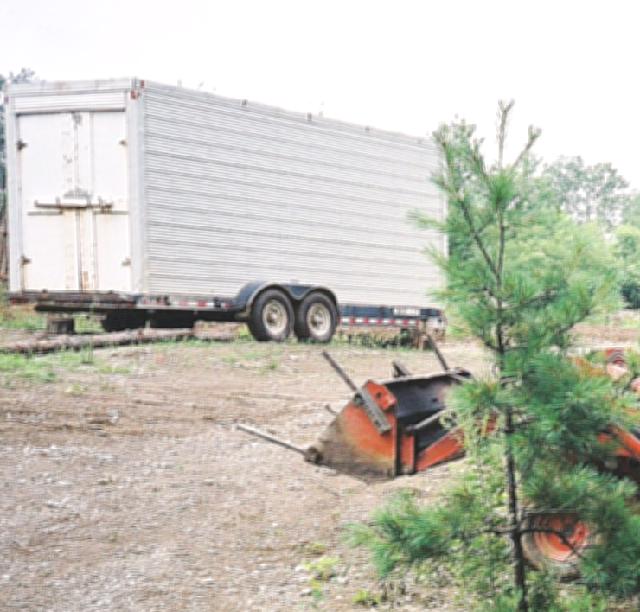

My trailer was originally used to move household goods so it had a box on it. At that time the axles were also over slung so it sat lower. The axles have since been under slung so the trailer rides level, higher and allows for more clearance on the frame and suspension components. Previously it would bottom out on some rough roads and bent one axle. Also, in it's previous configuration I kept ripping the ramp holders off as they were quite low to the ground. :D
Dove tails definitely have their place and can be very versatile. With real equipment that is what I would probably have!:D
Picture of old set up with ugly box.
