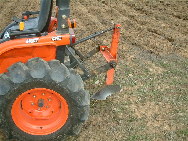

I pulled a small King Kutter middle buster with my Kubota B7510 HST (21 hp engine, 17 hp pto, no info on drawbar hp). Used it to plow the lawn area around my new house prior to rototilling. The soil was pretty dry.
Your tractor is a lot more powerful than that little Bota so you should be able to handle a double buster.
