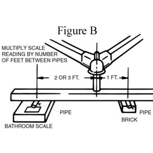

It depends how much tongue weight you want. I've used a bathroom scale set on blocks at the same hight as the hitch. Scale I used will go up to 350lbs and I've not needed any more tongue weight than that.
/ Tongue weight scale
As I understand the setup used for GN trailers, pin weigh should be 15-25% of the towed load. So with a fully loaded 10K GN, the pin weight could be as high as 2500 lb. Can't handle that with my bathroom scale.

I've used this method before.

Interesting device the little tongue scale. I have successfully used the bath scale and the board for weights exceeding the scales limits.

Keep in mind that the weight on the jack does not equal the weight on the ball.
/ Tongue weight scale #14
When I use the Sherline Trailer Tongue Weight Scale it is inserted into the the Hitch Ball Socket, not further back. The weight shown on the scale "IS" the actual weight on the ball.
Jim
/ Tongue weight scale #15
Jim
Correct! That IS one of the advantages of the Sherline scale, you CAN measure at the ball socket in the coupler.
