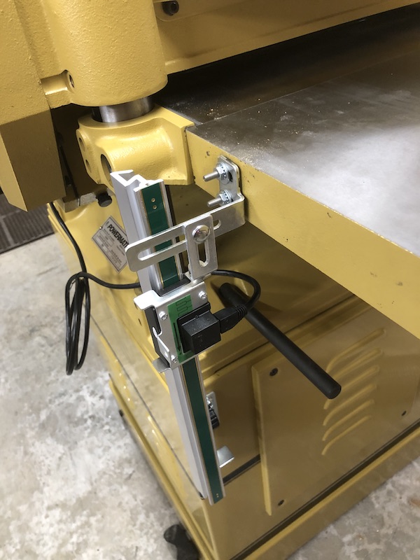

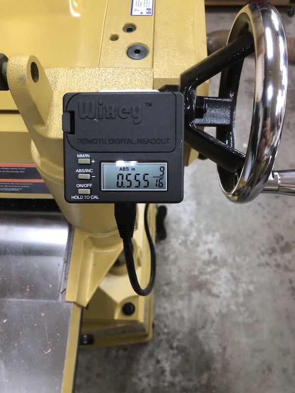

Should've done this mod a while ago. Added a Wixey Digital Readout to my planer. Wow! Now I can dial it in to .005in accuracy in a jiffy. Always hard to go back and make additional boards at the same thickness without a lot of fussing using a tape measure or rule on the machine.
Thinking I might 'need' one for my table saw as well. :cool2:
