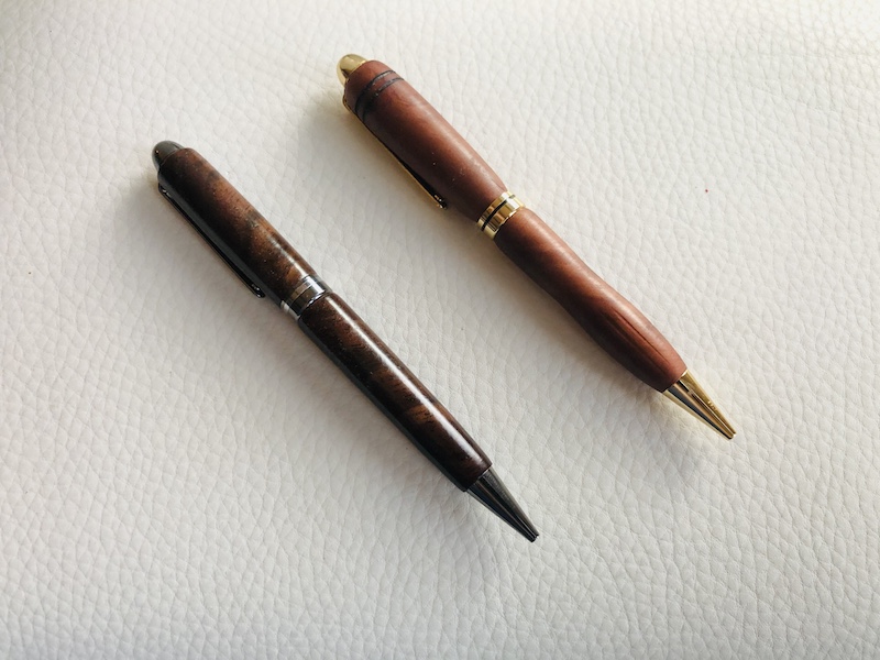

The base wood is some kind of California black walnut/eucalyptus if IIRC from what the guy at Woodcraft told me. The top handle is from rotten vine maple from my back yard that I stabilized with some cactus juice (infused resin). The decorative ring is gold glitter applied with CA glue prior to turning.
Beyond my ability.. Nice work !
/ Todays shop time. #883
Thanks... here are my first two pens I turned this weekend. Getting back into woodworking this winter after I finally dug out some of my buried tools and machines in the shop along with playing with my new lathe.

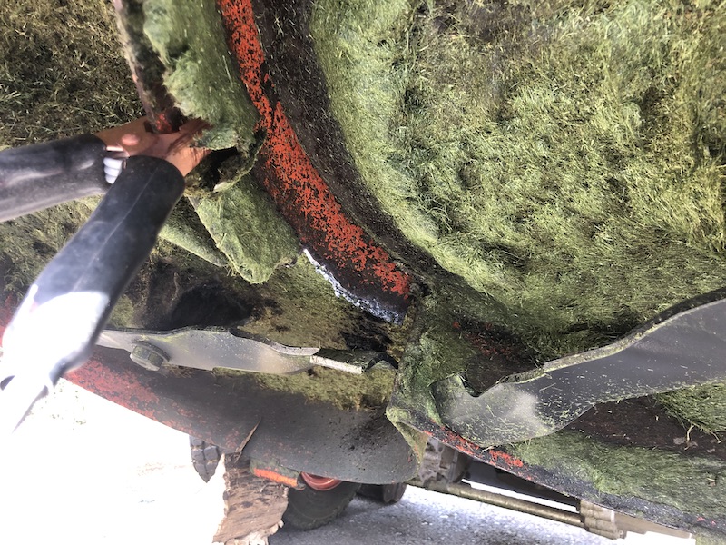

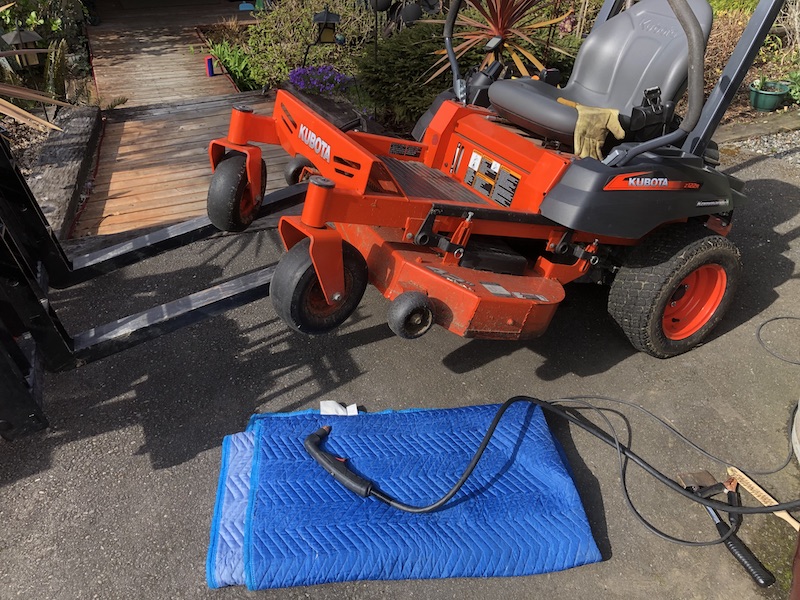

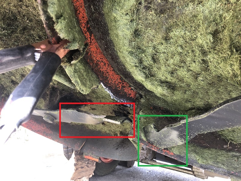

Since I didn't see an 'Under the Seat Time' thread, I thought I would post this here. Replaced my mulching blades this winter and the new ones must be a little bigger than the ones that came with the OEM mulch kit. :confused3: Even though they are also from the Kubota dealer, one blade was hitting the mulch shroud between the two blades.
Got the Z-turn close to the shop door, lifted it with my tractor forks and did some crude carving with my plasma cutter. That was fun but I nearly had a fire from the grass stuck to the underside of the mower deck. :eek:

Hopefully you tried turning the far blade right side up first (red box is upside down, green box is right side up)?

Crap!!!!!!! No wonder! What an idiot! :mur: :duh: Thanks Aaron! :ashamed:
