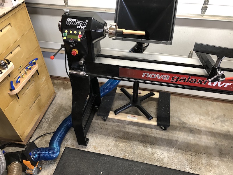

Nothing special... just some cheap magnets from Harbor Freight.
Lathe I am super happy with... a Nova Galaxy. What a dream... digital variable drive. I bought a couple Vicmarc chucks and now I just need to live up to the equipment I have. Of course I went straight to bowl turning rather than hone my skills on simpler spindle type projects but that's me. Currently making my first box with mortise/tenon lid thanks to a couple YouTube vids on technique.

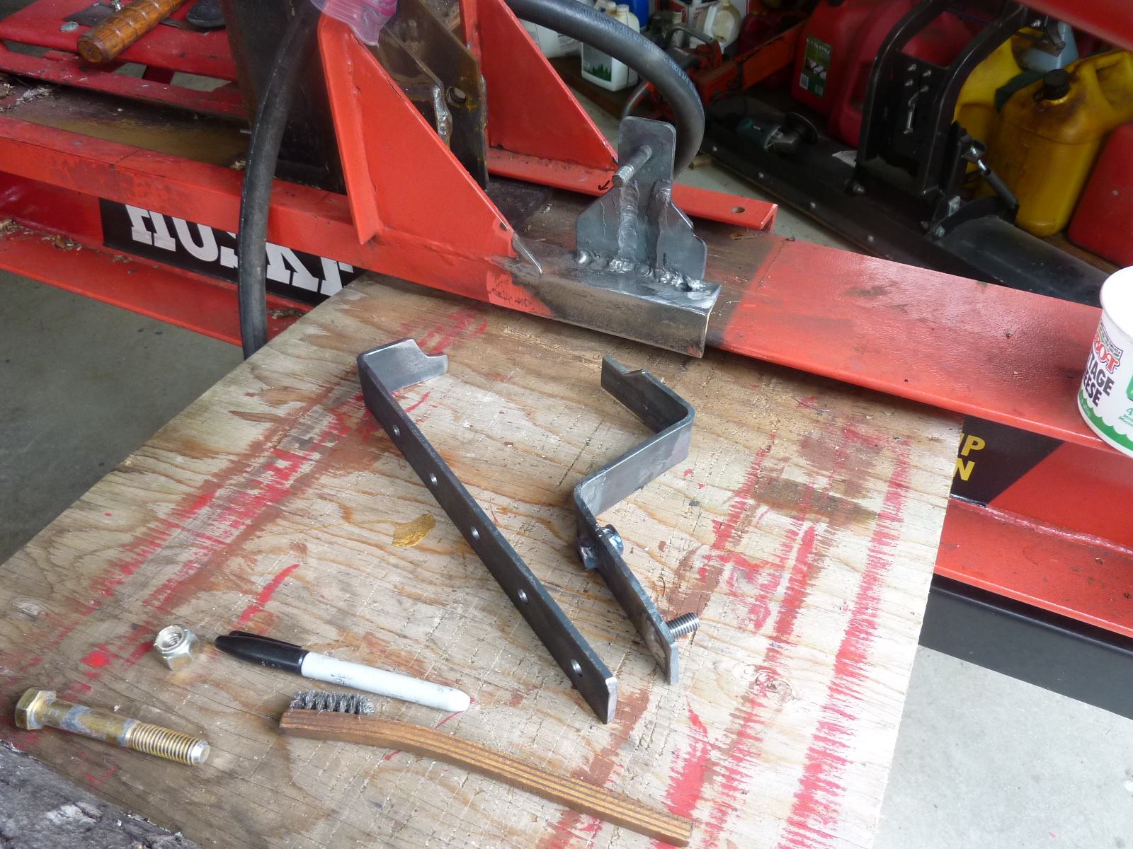

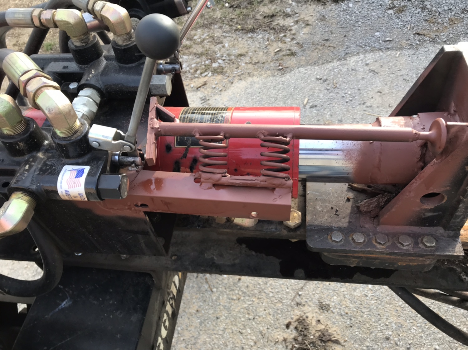

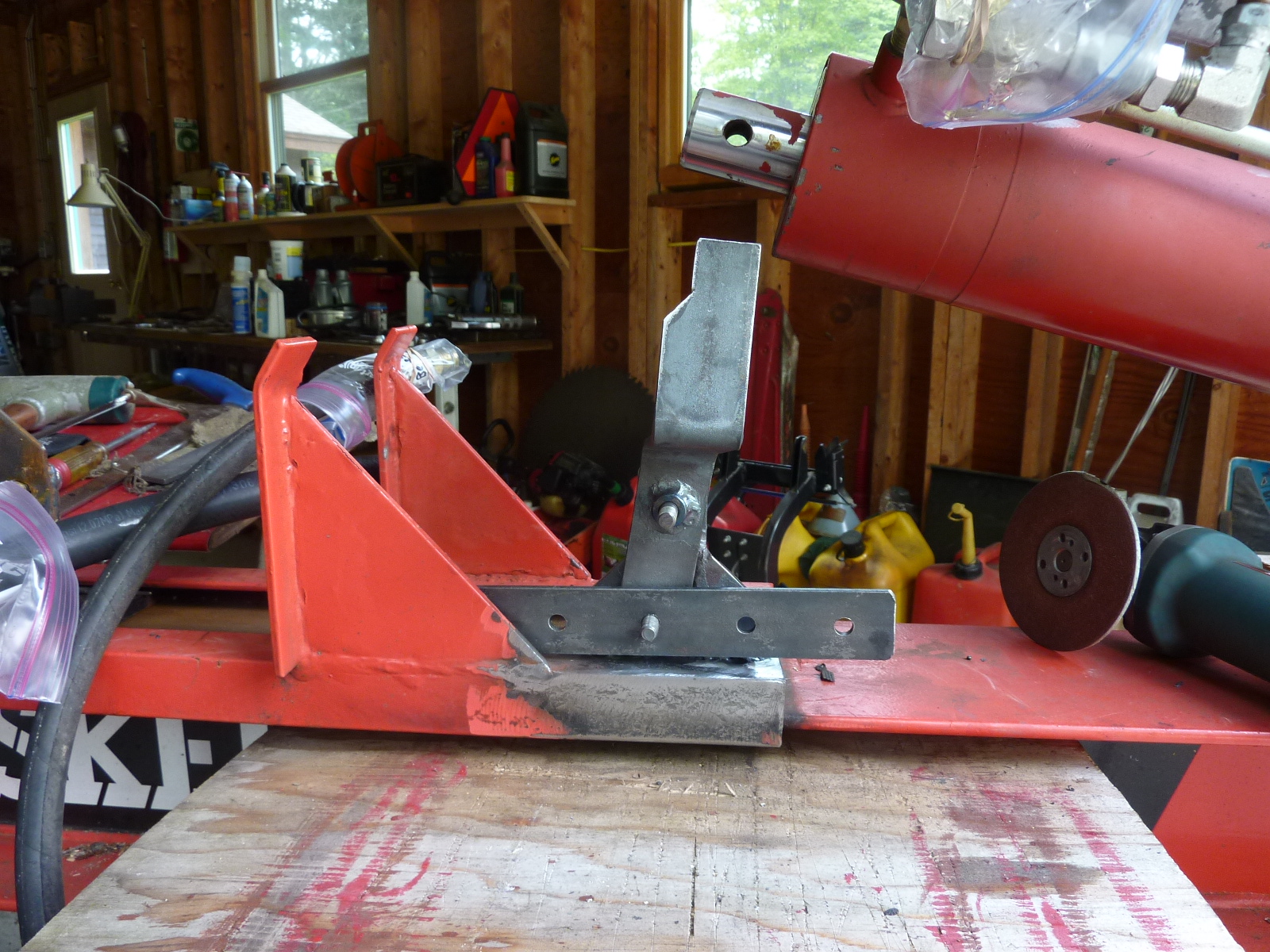

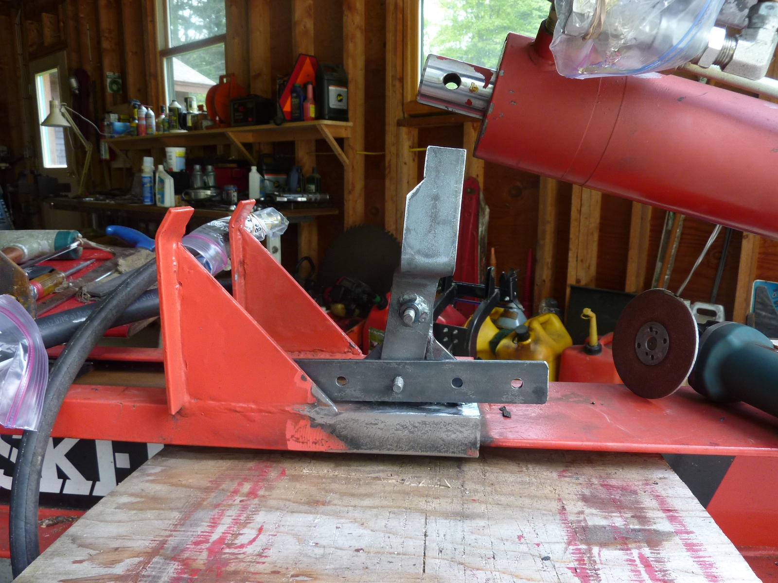

My wood splitter has a 30” stroke and I don’t split 30” wood so I had bolts in the beam flange to stop it short to save time. After a couple years of doing that it broke the end off the cylinder. So after I fixed that I rigged up this contraception to knock the valve back to neutral. IMG_8081.JPG

Thats a cleverly simple way to do that with the spring rather than a slide.

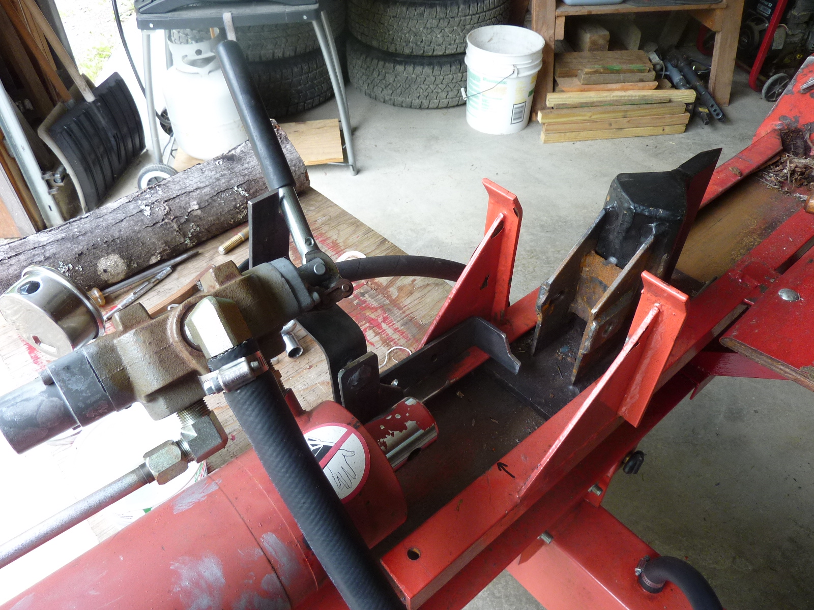

I did the same thing about 6 years ago. Splitter stops at 26" and I split 18" or 16" mostly. So I made a plate stop bolted to the beam. I tore out the wedge bolt holes. Fixed that and made an adjustable lever contraption to throw the the lever to stop. On mine I had to push the lever the opposite direction of the wedge travel so I needed a pivot. Saves a lot of time stopping the splitter in the right place.

The direction of mine and yours is the same. Mine hits the valve body instead of the handle. But yours is a lot cleaner job than mine.

Oh ya I see - you were smarter than me !!

I’m trying to figure out how to get it to auto return. I know I could buy a valve to do it but I think they’re like $300. I want to do it with a lever. Pushing the valve back to neutral wouldn’t be that hard but it would have to store energy to finish the movement. I haven’t figured out the storing energy and resetting it for the next cycle part.

Does that chip collector sitting on the HF dolly work well for you?
Where did you find that?
/ Todays shop time.
#870
My guess is it works decent for small stuff like the picture. For turning bowls and stuff the chips are coming off too hard and in too many directions to catch many of them. I put a shower curtain around my lathe to contain most of them. If you don’t already have one an overhead air filter makes a huge difference. Not just for a lathe but every tool. I’ve got 2 in my shop. They make the shop experience way better.
/ Todays shop time. #871
I didn’t rig it up so much for chip collection but for sanding dust. I reverse my rotation for sanding and it is very effective as long as your dust collector ‘sucks’.
I bought it from woodcraft. You can buy the chute itself, or with adjustable height/tilt function. I put it on a HF dolly and I can easily position it wherever I want behind the lathe.
A bit of a luxury but my new push this year is to dramatically improve my dust collection for health reasons in addition to the obvious desire to have a cleaner shop.

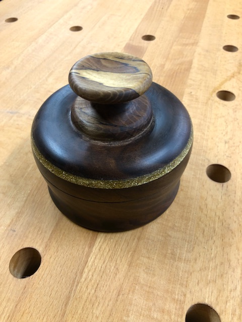

Some shop output... a little jewelry box turned for the wifey for Valentine's day! Was a couple days late and that made it a surprise. :D

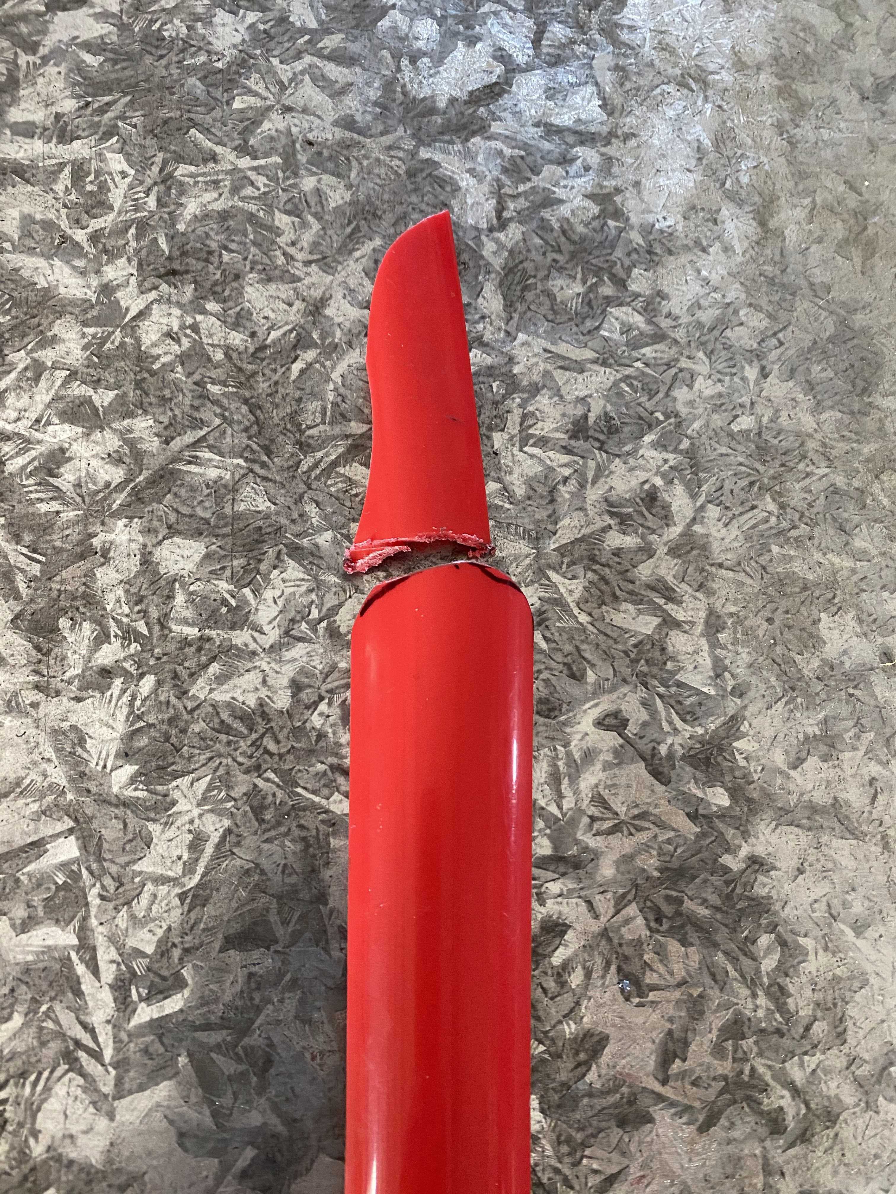

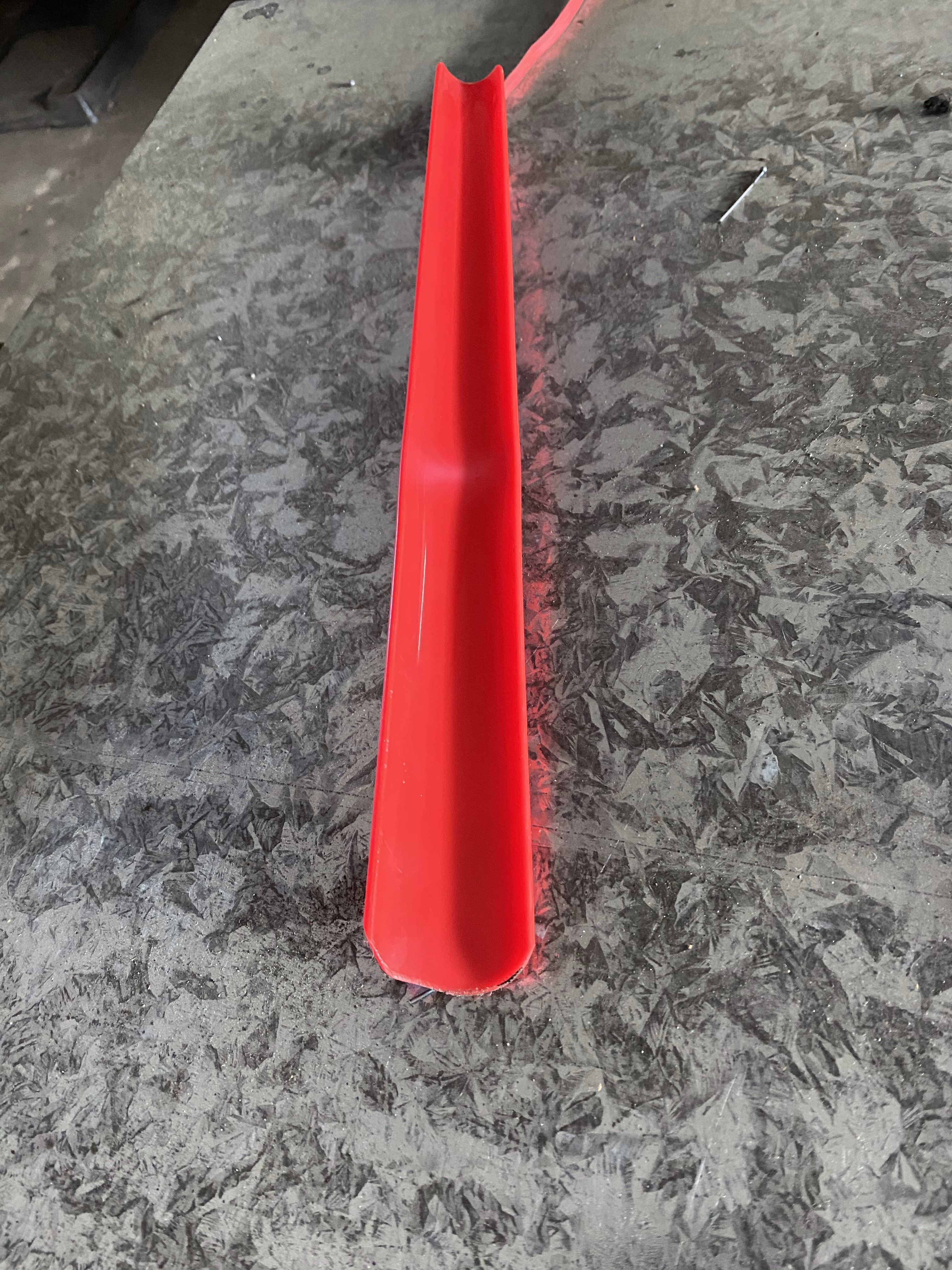

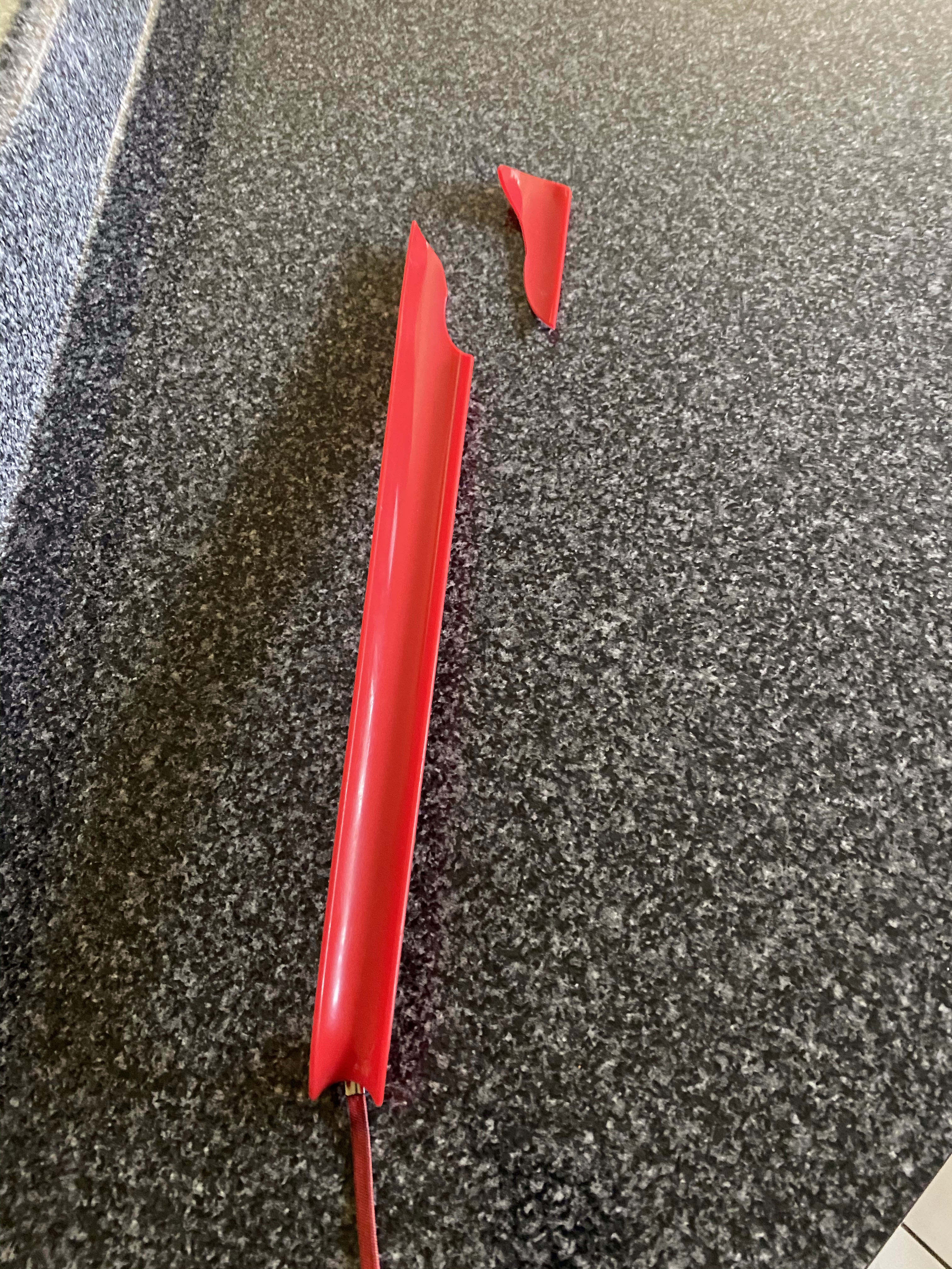

I broke my extra length plastic shoe horn this morning.
After seeing how much Amazon wanted for a new one I retrieved it out of the garbage and rounded off the broken end with a zip cut wheel. Take note of the precision layout.
Repair job works fine.

Very nice, Mark! Black walnut?
Thank you.
The base wood is some kind of California black walnut/eucalyptus if IIRC from what the guy at Woodcraft told me. The top handle is from rotten vine maple from my back yard that I stabilized with some cactus juice (infused resin). The decorative ring is gold glitter applied with CA glue prior to turning.
