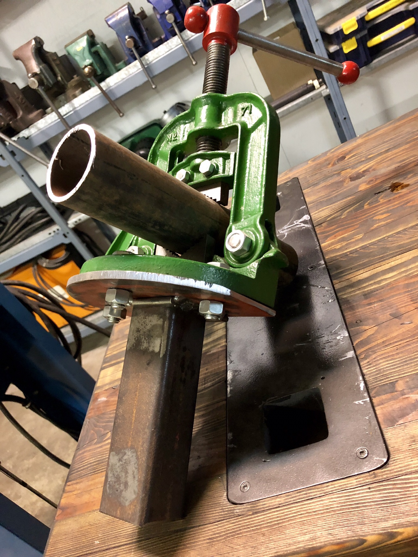

I picked up this Made in Canada pipe vise the other day for $30. Since it’s not a tool I use everyday I receiver mounted it to make it easy to use when needed.

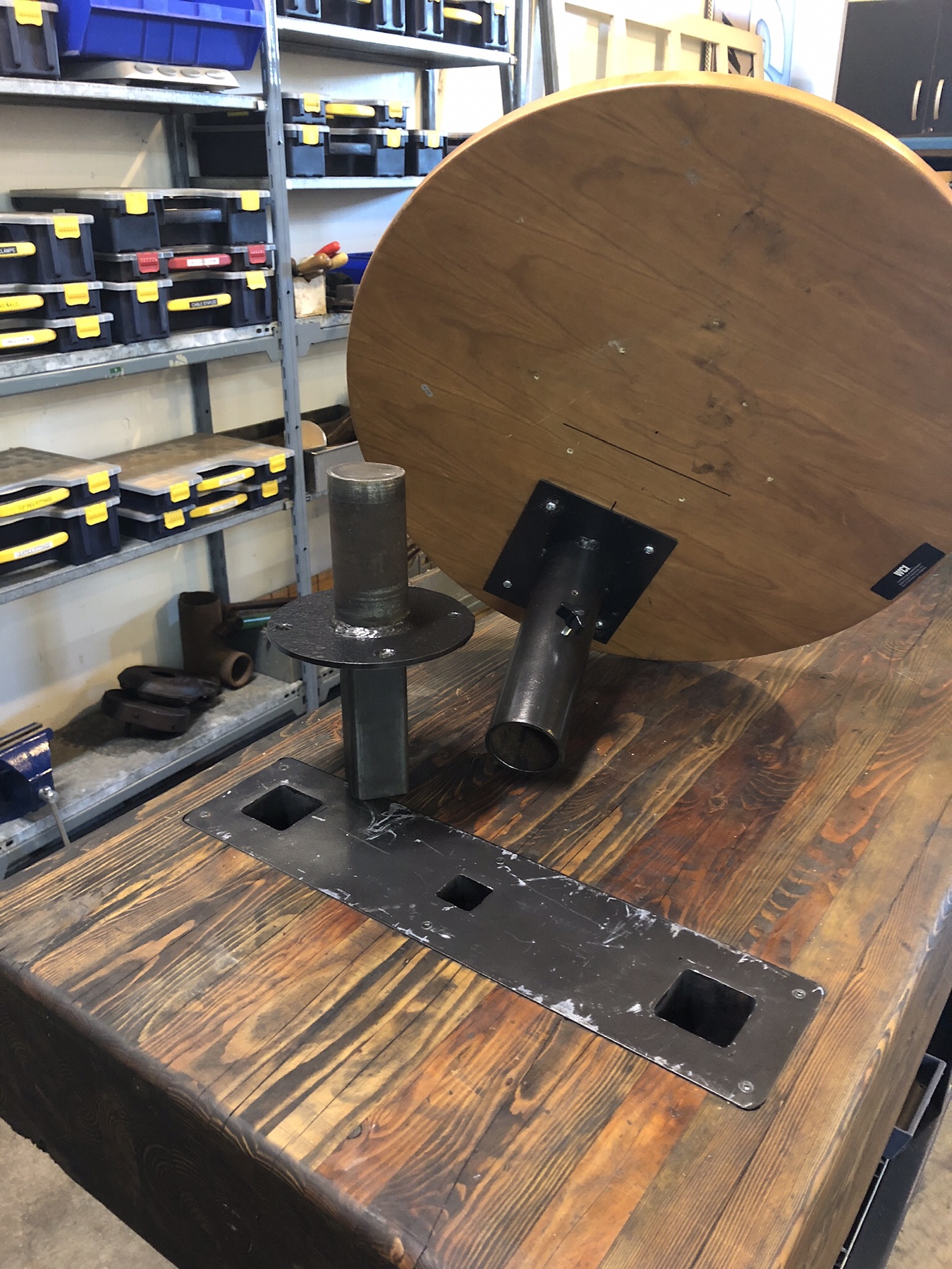

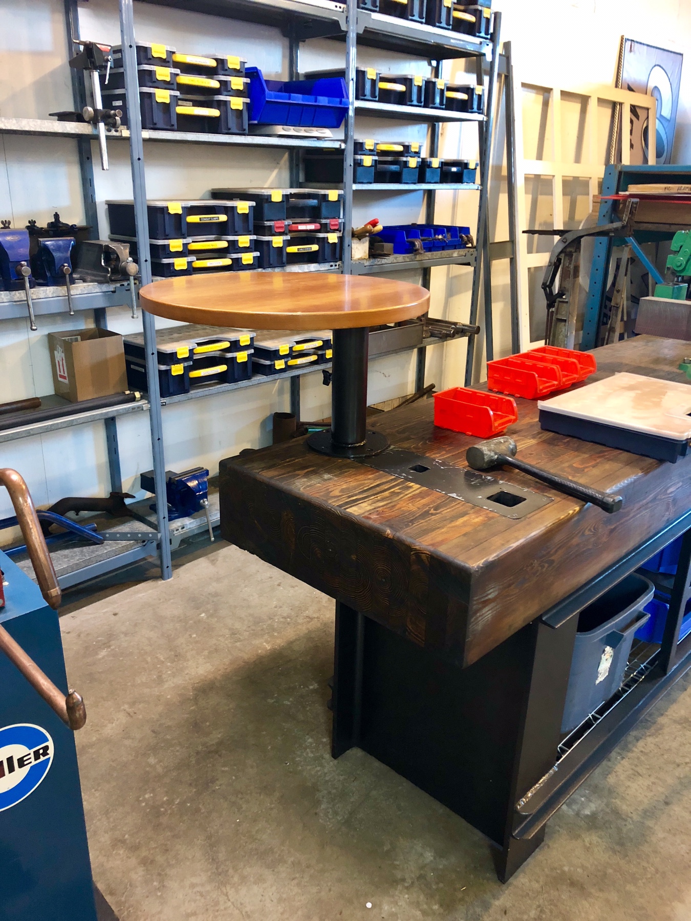

I made a vertical receiver mount with a rotating base today. Should be useful for future fixtures. For now I can utilize it for a 360 degree rotating table.
The 24 inch diameter one inch table top was a result of dumpster diving.

I like that table idea. Looks high enough to not have to bend over to look closely at something. Every year it gets harder to see stuff.

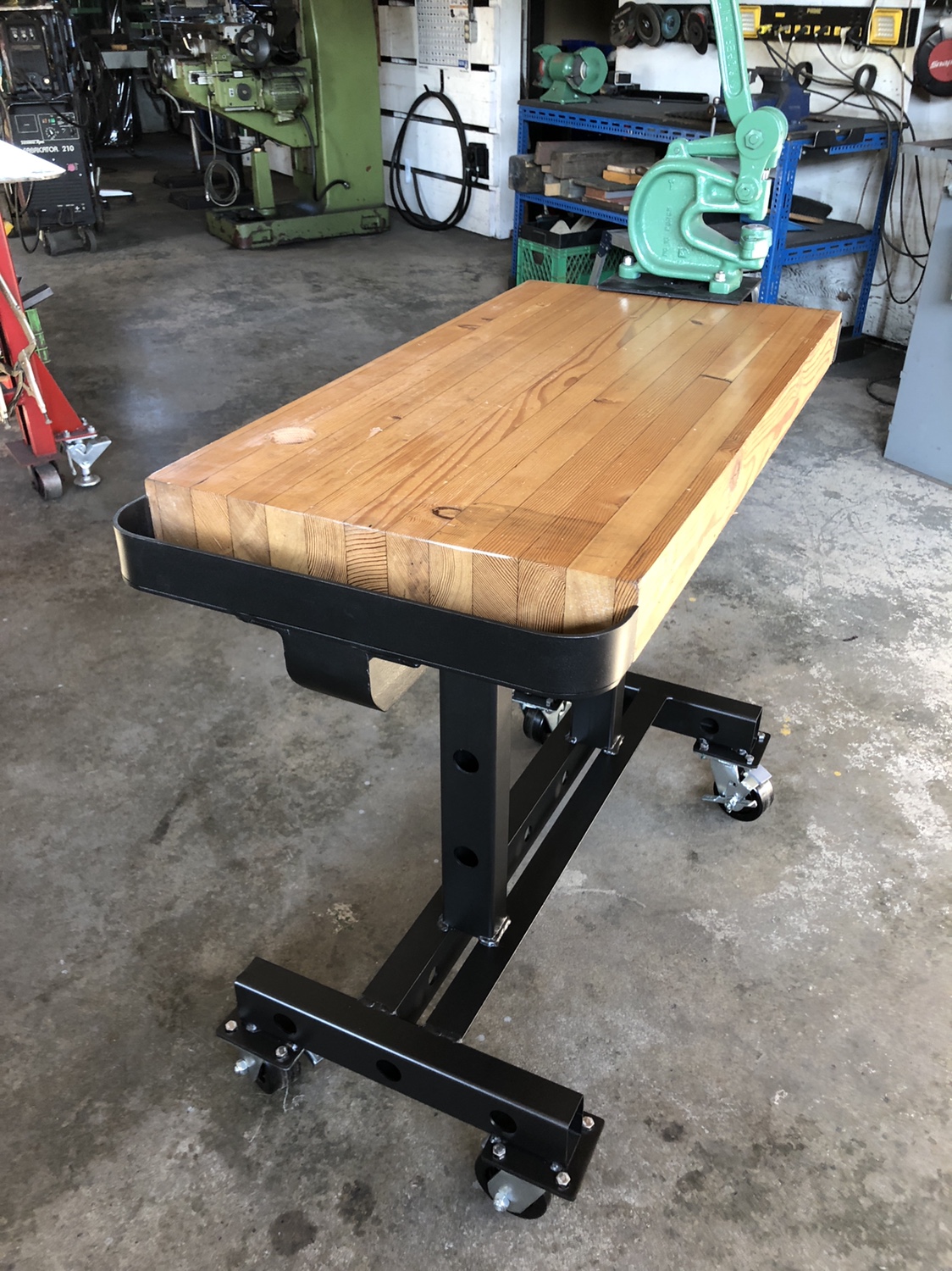

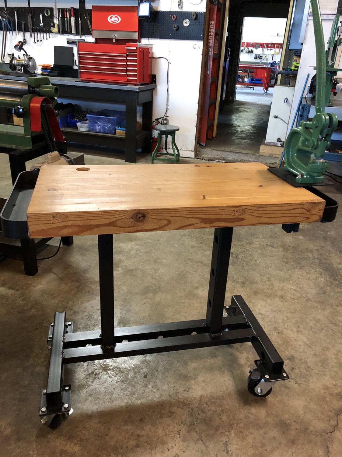

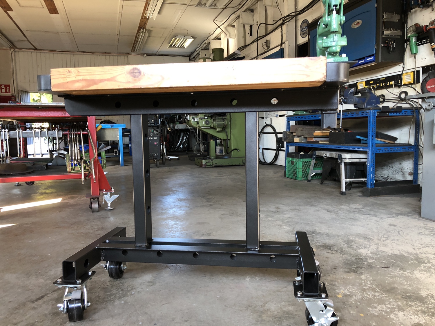

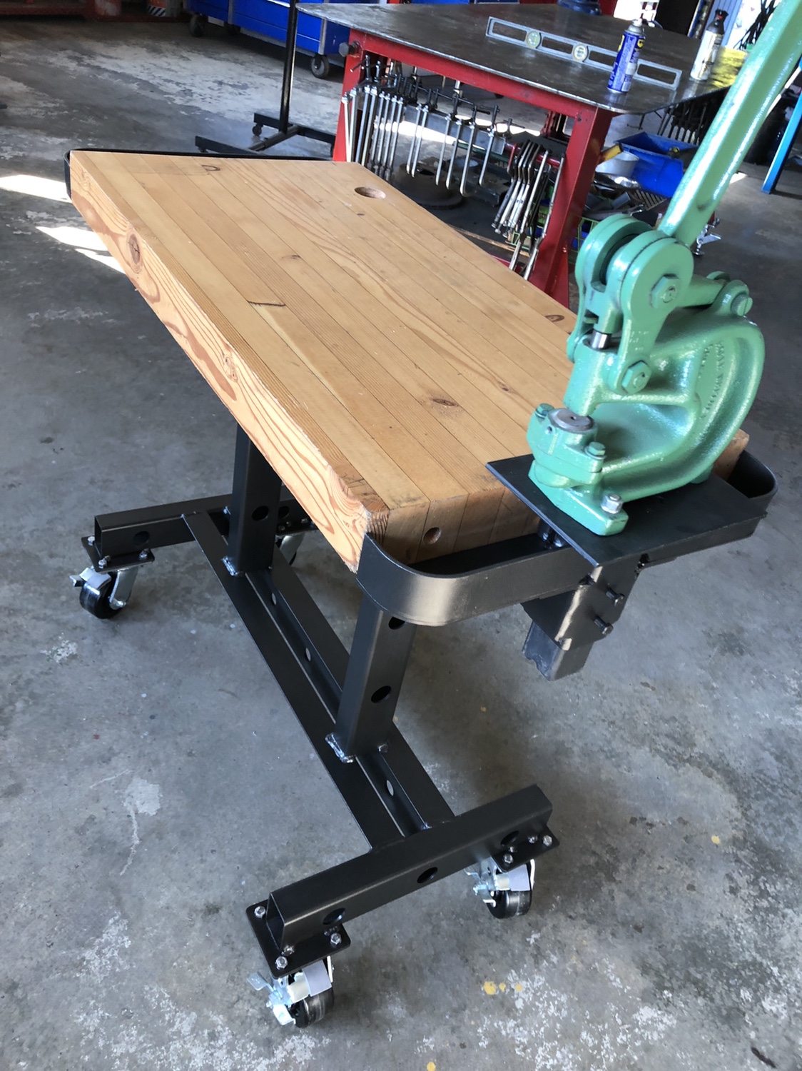

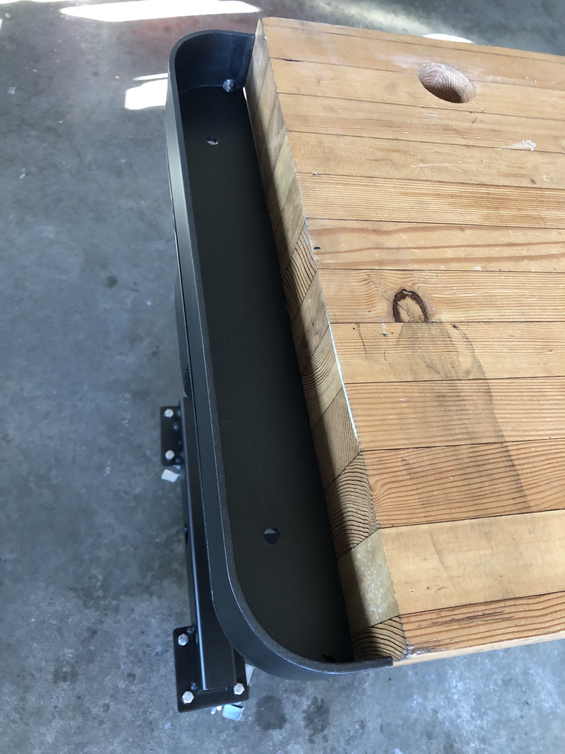

I made this mobile table for the shop.
36”x 19” x 3” laminated wood top
2”x3” square tube
2”x3”x3/16 angle
4” greaseable swivel casters
2.5” receiver tube mounted vertically
36” working height to match work benches, welding and burning tables.
Total weight 145 pounds
/ Todays shop time. #653
Big Barn, very nice. You're on a tear!
Do you have special source for your steel stock?
Now if you tell me you milled that butcher block top yourself, I'll know for sure I'm not worthy. :)
36肺 19 x 3 laminated wood top
2肺3 square tube
2肺3肺3/16 angle
4 greaseable swivel casters
2.5 receiver tube mounted vertically
36 working height to match work benches, welding and burning tables.
View attachment 575440View attachment 575441View attachment 575442
Terry, I had to wait to get home to see your pics on something bigger than my phone. I like it a lot!
Did you laminate the wood top yourself?
What are the holes in the structural members for?
Thanks Threepoint.
No special source for steel stock. The supplier I frequent treats me well though.
I can’t take credit for the laminated wood top. There was an ad on Facebook for various lengths. The lady was keeping the only six footer for herself so I took the next longest piece for forty dollars.
Dragoneggs: the holes are purely cosmetic. Most my projects reflect a holier than thou attitude.

I figured as much! :drink: Boy do I need a Magdrill!
Actually the holes in the rectangular tube were done with sheet metal cutters on the drill press. (I don’t have a fancy setup for my mag drills like BuckitCase). It was easier for me to keep the holes parallel using the dp vise.
I used the iron worker for the holes in the angle iron. Easy peasy
I have that problem also, and I’m shorter than average!
Just not fair! :hissyfit: The iron worker is on my bucket list.
I love how clean and organized your shop is.. this is for big barn
