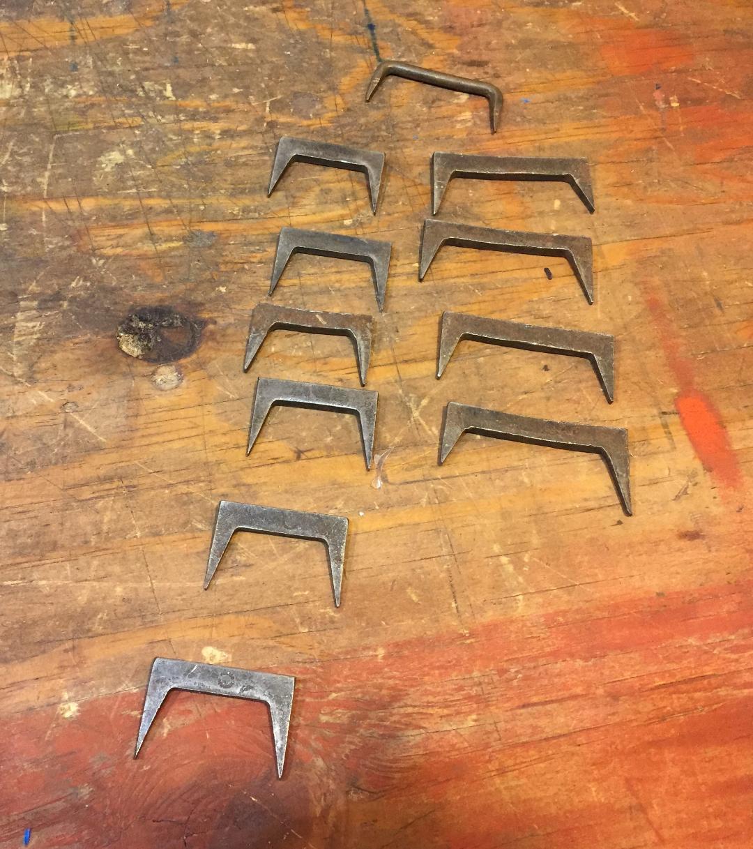

In the shop today I opened up a box of woodworking odds and ends that came to me recently along with a Rockwell wood shaper.
I am stumped by these metal gauges or spacers. They are 2" and 3" except for one that is bent to 2 5/8". Does anyone know what they are used for?

They are dogs to hold two boards together side by side by hammering them into the end grain. I think used when glueing the boards together. The inner taper will draw the boards tight. I found a bit of a description in this quick google search. Making Your Own Timber Dogs - Paul Sellers' Blog
