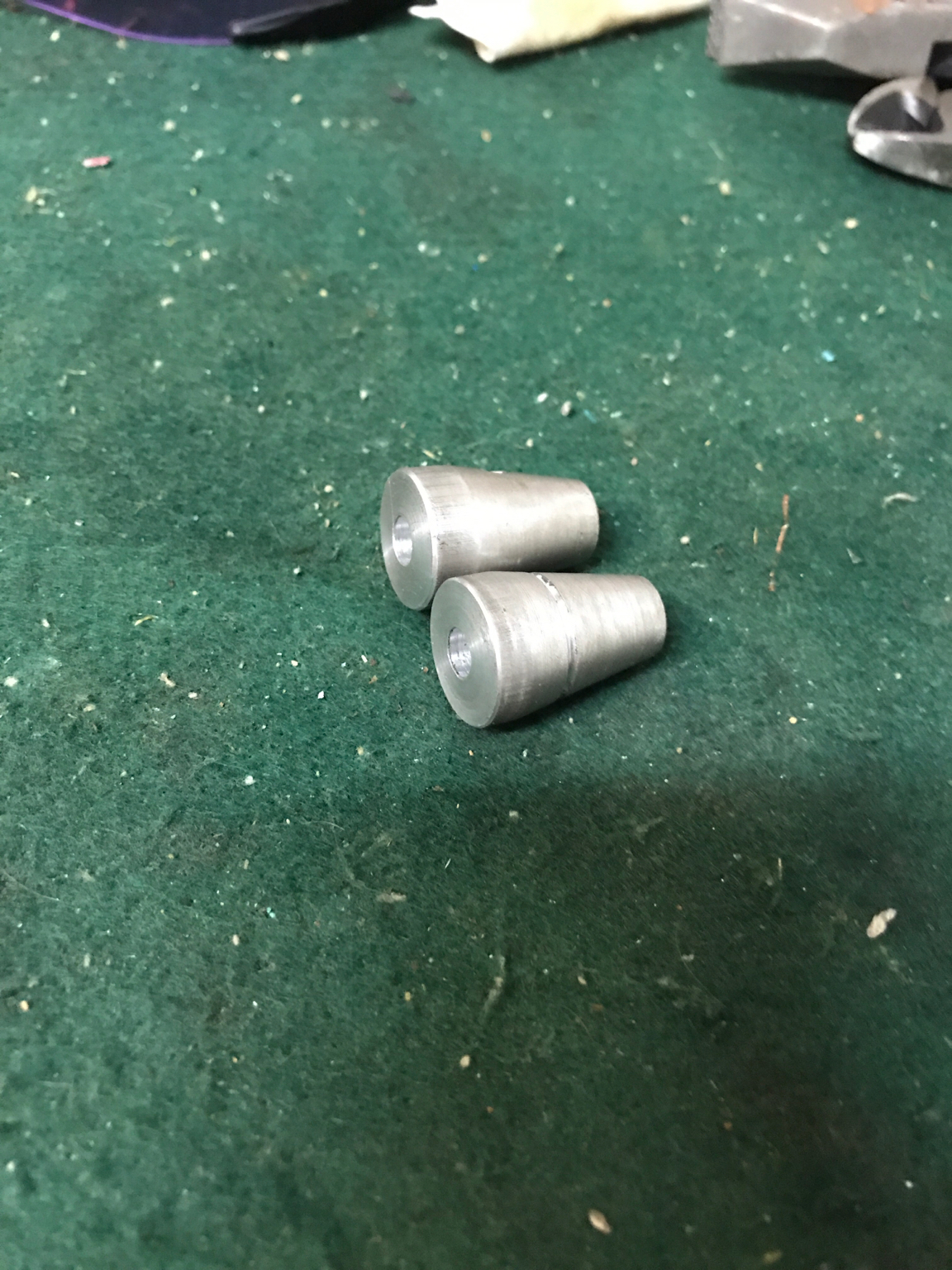

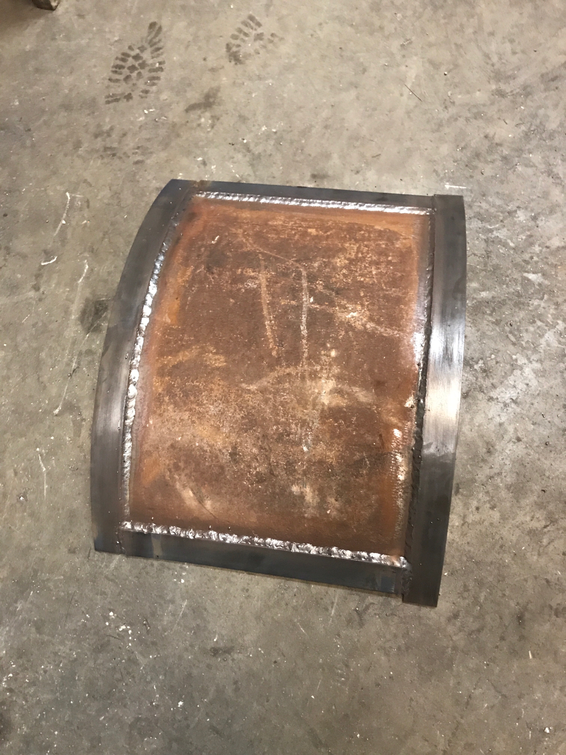

I worked on a wood stove door and made a set of guides for my timberline chainsaw sharpener. IMG_0648.JPGIMG_0649.JPG

I worked on a wood stove door and made a set of guides for my timberline chainsaw sharpener. View attachment 528622View attachment 528623
Your wood stove door still looks bowed, bigger hammer required, or was there something else wrong, maybe it was straight and you had to put more of a bend in it or there was glass in the door and had to be removed? but some nice welding on the inside plate.
You wore the guides on that Timberline sharpener, how much does the replacement parts cost? But sometimes it's still more interesting making parts yourself, I'd say you have a metal lathe for making those, nice.
The wood stove door is bowed because it's a round stove. It's a long ago propane tank I'm converting into a stove. I never looked at the replacement part cost. I needed them now and making them was satisfying. Edit, it appears the parts are $17 plus shipping.
I have one of those tanks and I mean 40 year long ago, how thick are they? look forward to pictures of your stove. See you saved yourself $17+, that's enough to buy breakfast at the local restaurant.
Mine was ancient and is 3/8 thick. I think the newer tanks are thinner.

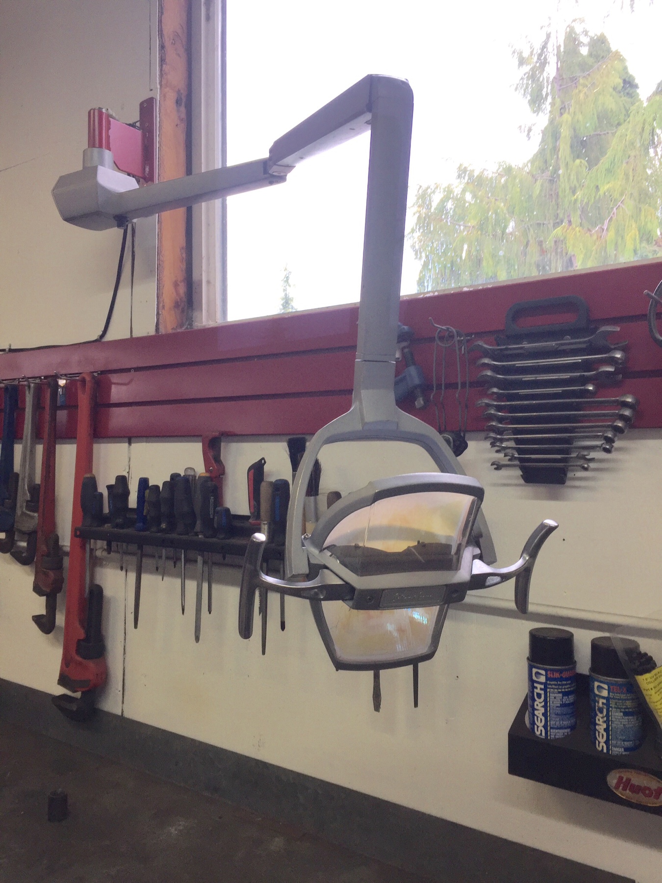

"Let there be light"
I had a double head ceiling mount dentist light fixture that I finally got around to mounting. I separated the units and fabbed up new wall mounts.
Very cool! World's most expensive work lights. But do your teeth start to ache when you look at it?? ;)

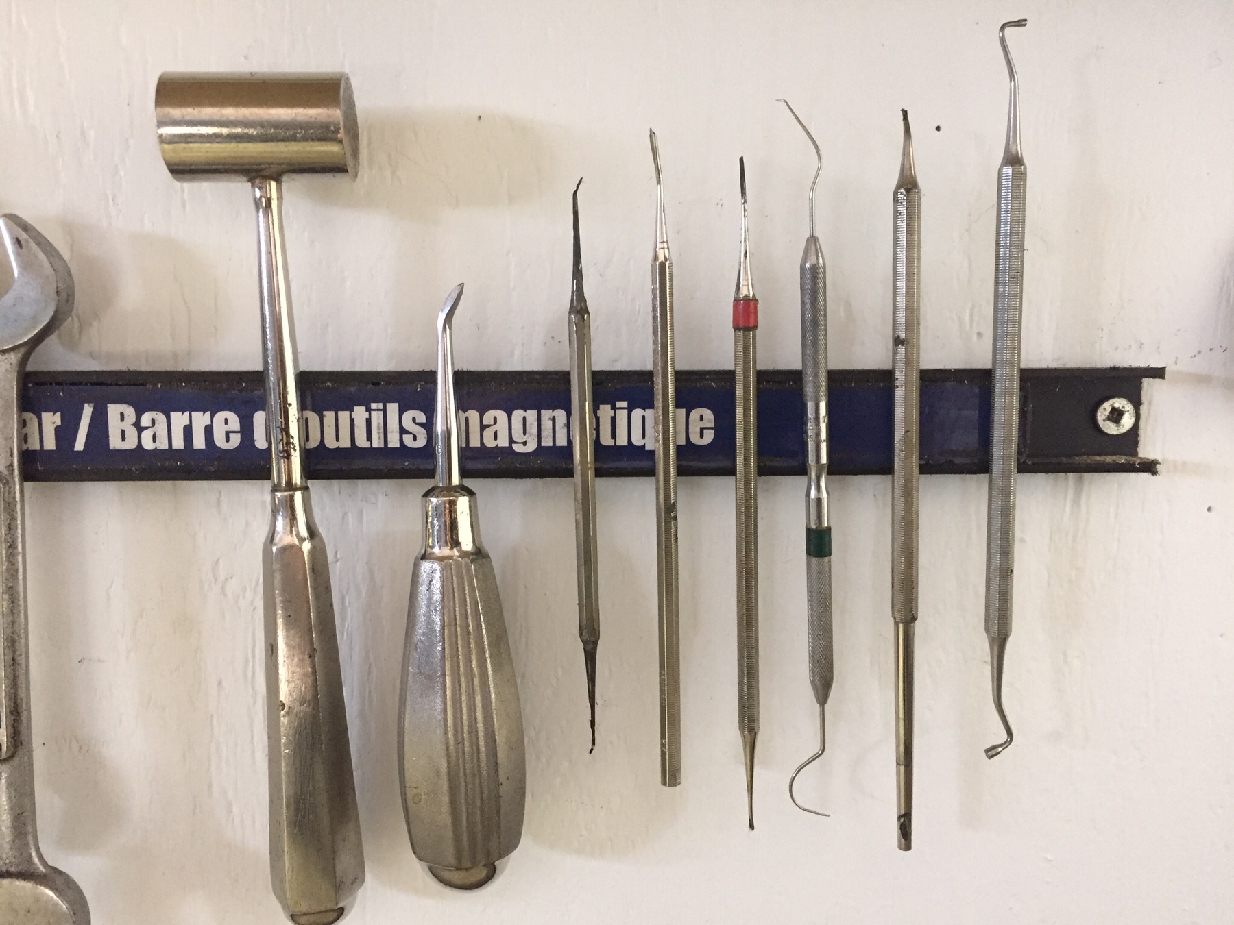

No, Drew but looking at my dental picks will......

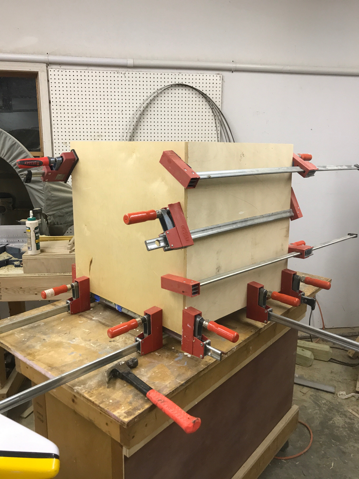

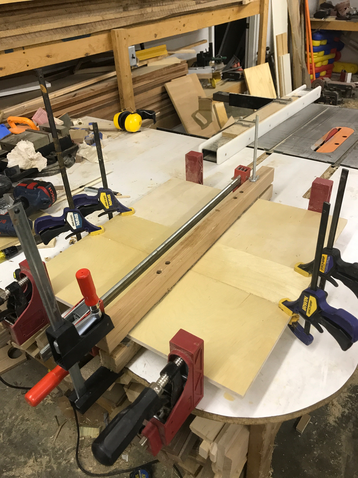

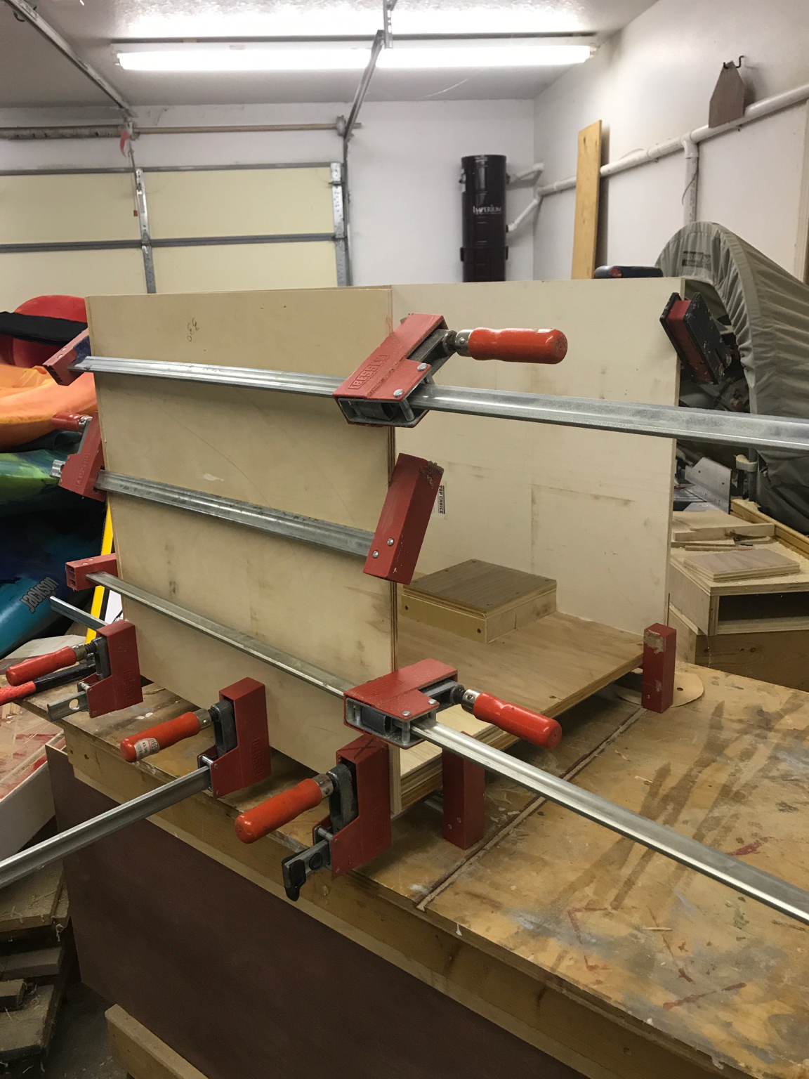

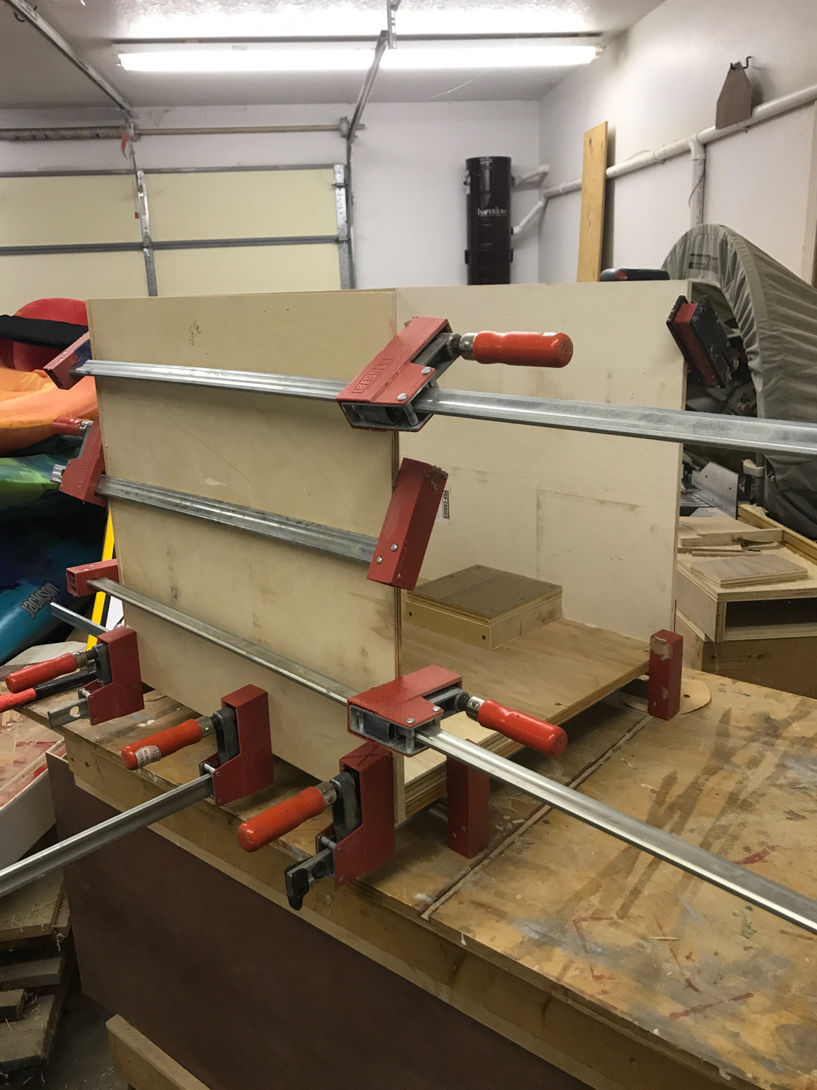

I worked on my wheeled box for moving firewood in the house. I ran out of plywood for the 4th side. I glued up scraps of plywood for that side. I've never done that before so we'll see how it turns out. IMG_0668.JPGIMG_0669.JPGIMG_0670.JPG

4570Man,
If you haven't used biscuits or dowels, I am not optimistic about the panel you have made from three pieces.
The way you have orientated the panels, all your gluing is to end-grain, which is basically useless.
At least, for the other joints, where you have joined two panels at a corner, a bit more than 50% of the joint is long-grain to long-grain (depending on the number of plies in your sheets. Even here, you would get significantly stronger joints with biscuits.
How are you planning on reinforcing the corner joints?
For the fourth panel, you would have done better to put the two larger pieces together to maximise effective glue area. The smaller panel would still be a problem, but at least most of the panel would have a bit of strength.

I worked on my wheeled box for moving firewood in the house. I ran out of plywood for the 4th side. I glued up scraps of plywood for that side. I've never done that before so we'll see how it turns out. View attachment 528995View attachment 528996View attachment 528997
this is a very cool project. Always wanted a fire wood door (like a doggie door) but that slided, sealed and insulated, and just pull the firewood box in from out side. Getting a straight shot in is a challenge. Do you have a door near the fireplace?
