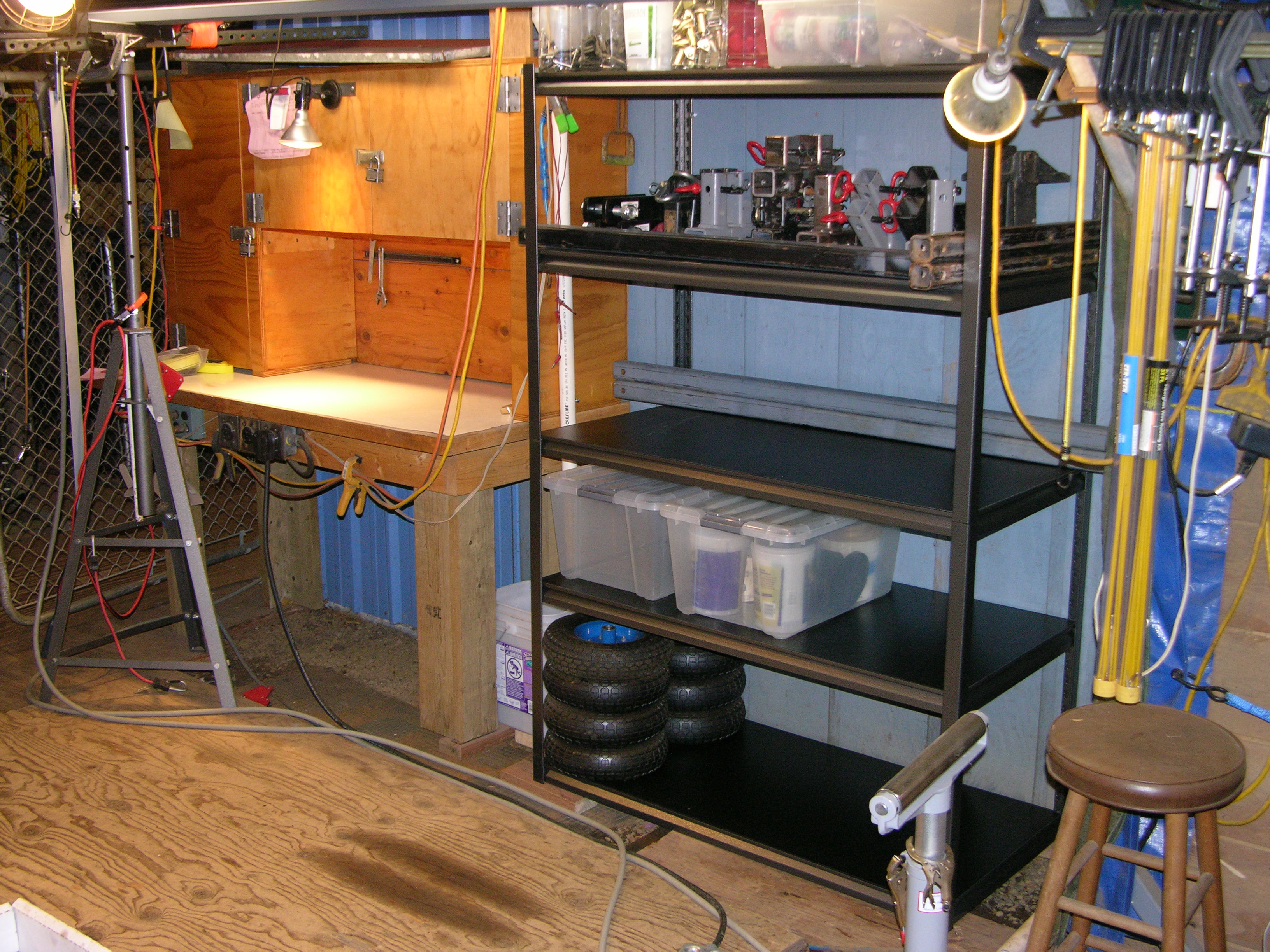

Nope, not quite; I can see where things coulda got confusing - the shot of the green container is the only thing with a roof (yet) - it's a 20', roof is 24'x24', which leaves an open covered area about 14'x24' with 11' headroom, so I can get my 580B in there this winter - 7 cylinders need kits, brakes barely work, diff lock stopped this summer, and more hydraulic changes (diverter valves, couple more articulation options, custom QA system for loader so I can swap bucket/grapple/pallet forks/brush forks/brush bucket in about 30 seconds, 'nuther couple minutes for anything with hydraulics involved -
The OTHER container area is down behind my shop, 2 40 footers end to end - one's getting all the "inventory" that's in my way in the wood shop, other's getting the bridge crane/small weld table/mig/tig/stick/plasma (all of which are inverter based and can run on the 30 amp 240 that's available NOW, plus the milling machine, slip roll and 20 ton press. Everything that's NOT weld-related will be curtained off at the back half of the container.
Since I already have ample air at the wood shop, I'll run a conduit across the 12 foot alley-way that's big enough for air hose AND 120-240 power, and put a small panel inside the weld area rather than mess with extension cords and hoses.
I started a thread yesterday on the container weld shop, so far just cutting down a freebie to make a small-footprint cart for the new MM211 (inverter) mig since my mm252 appears to be able to do maybe 14 gauge on the limited power...
The plasma is already sitting on a rollaway with air filter setup and there's room on top for the little programmable tig/stick machine to sit on top, so that should help congestion a bit.
I'm pretty sure I'm gonna skin the wood floor with 16 ga. steel for at least the front half of the container rather than take a chance on sparks, got 3 sheets of it now so another 3 should do it - another $170 is worth it NOT to hafta have a firewatch... Steve

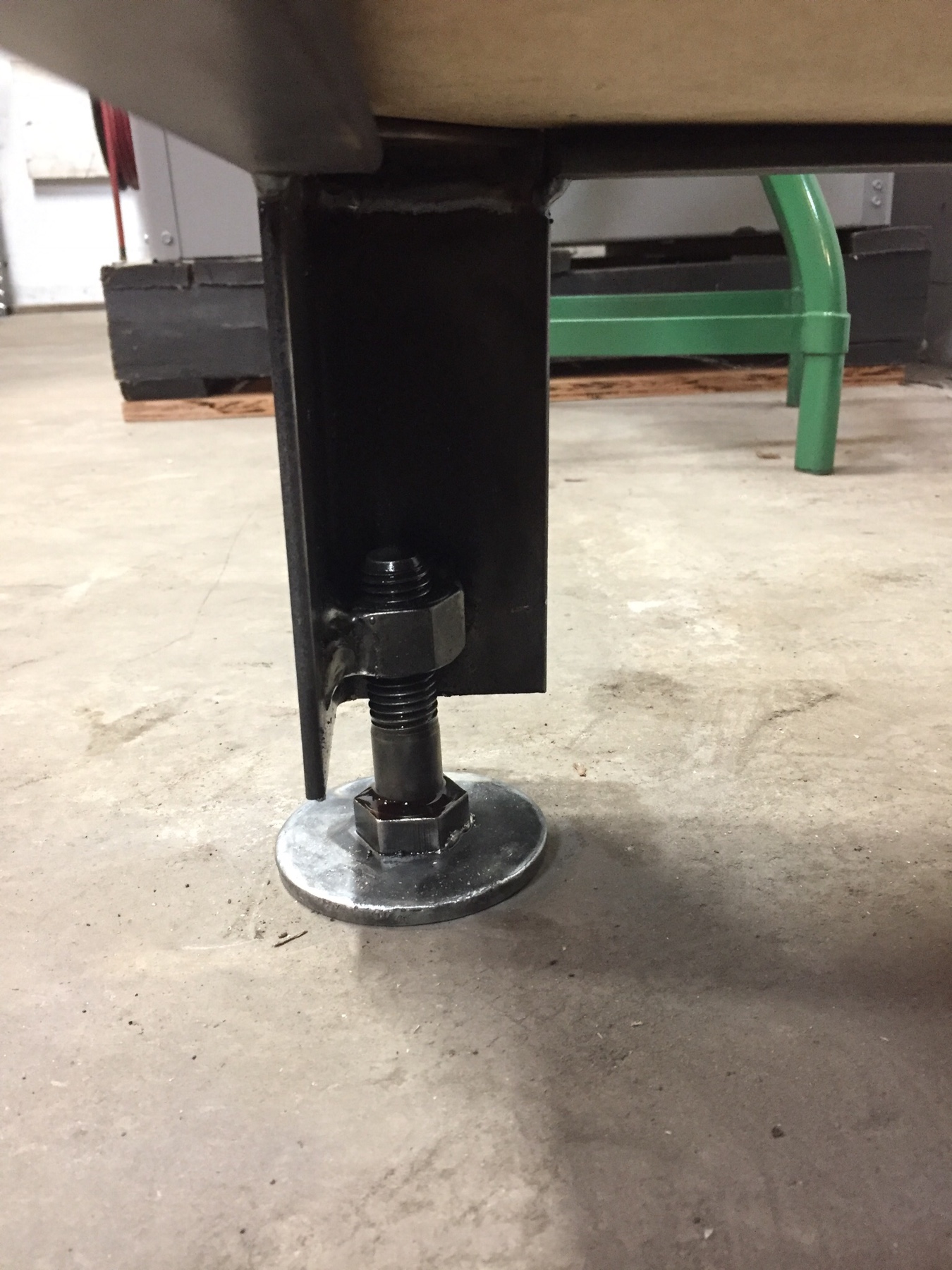

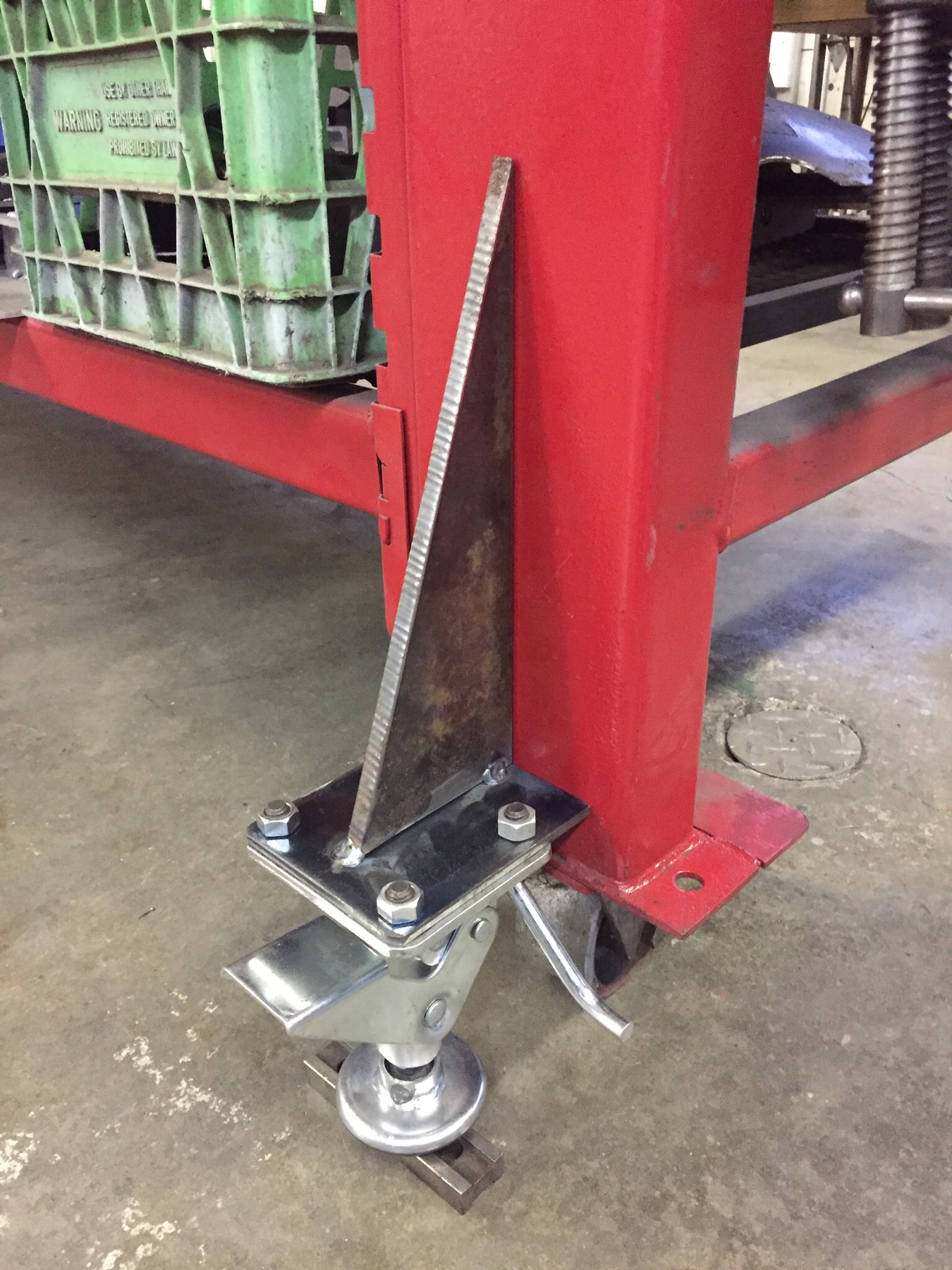

I needed an easy way to level my 4'x8' welding table every I moved it around (which is like, OFTEN).
Then... behold the current Princess Auto flyer. (Cnd Harbor Freight wannabe)
Their website showed what APPEARED to be a threaded adjustable foot but as it turns out it ISNT.
A brief online search only yielded $75USD ($100+ CDN items. THAT certainly wasn't gonna happen.
Sooo...I picked up the $12 ones and MADE them adjustable. Pics should tell the story. They're not as pretty as I'd like, so I will just call them "working prototypes".
OEM on the left. Big Barnified floor lock on the right.
Tentative mount for welding table leg. (One of four)
These floor locks have a 1" throw/lift and (now) 1" of vertical adjustment for levelling.
Maybe this will help someone else for their project(s).

Oh, those are sweet.. Would be a definite upgrade from my "bolt with a plate welded to the head" floor locks!!!!
Nice work Terry. You need to produce and sell those. With your bracket it would be easy to add them to almost any table!!!! Especially mine!!!! What's one of them ole kids in the last picture cost anyway?????
/ Todays shop time. #310
Richard-- I'll still do the bolt/plate adjusters for stationary benches. Just too easy to make.
I usually face a 3/4" bolt head in the lathe then plug weld to a heavy galvanized washer.
Here's where I plan to mount the adjustable floor locks on the weld table. I used 3/8" plate for the mount and gusset.

I still cant picture how those floor locks work, what exactly turns to adjust the height, the bars, the butterfly effect or the round wheel on the floor? It is better to have a level table to square work, nothing worse than being a half bubble oof.
/ Todays shop time. #313
Oldpath:
Turning the round floor pad (welded to 3/4" bolt) accommodates levelling.
Using your foot to press down on the flat lever RAISES your table (or whatever) ONE INCH, effectively RAISING your existing caster wheels off the ground eliminating rolling.
To lower back onto the casters PUSH either of the winged round stock levers ahead with your foot.
Of course I'm assuming that's how they work. The store only had two four inch units in stock and had to give me a rain check.

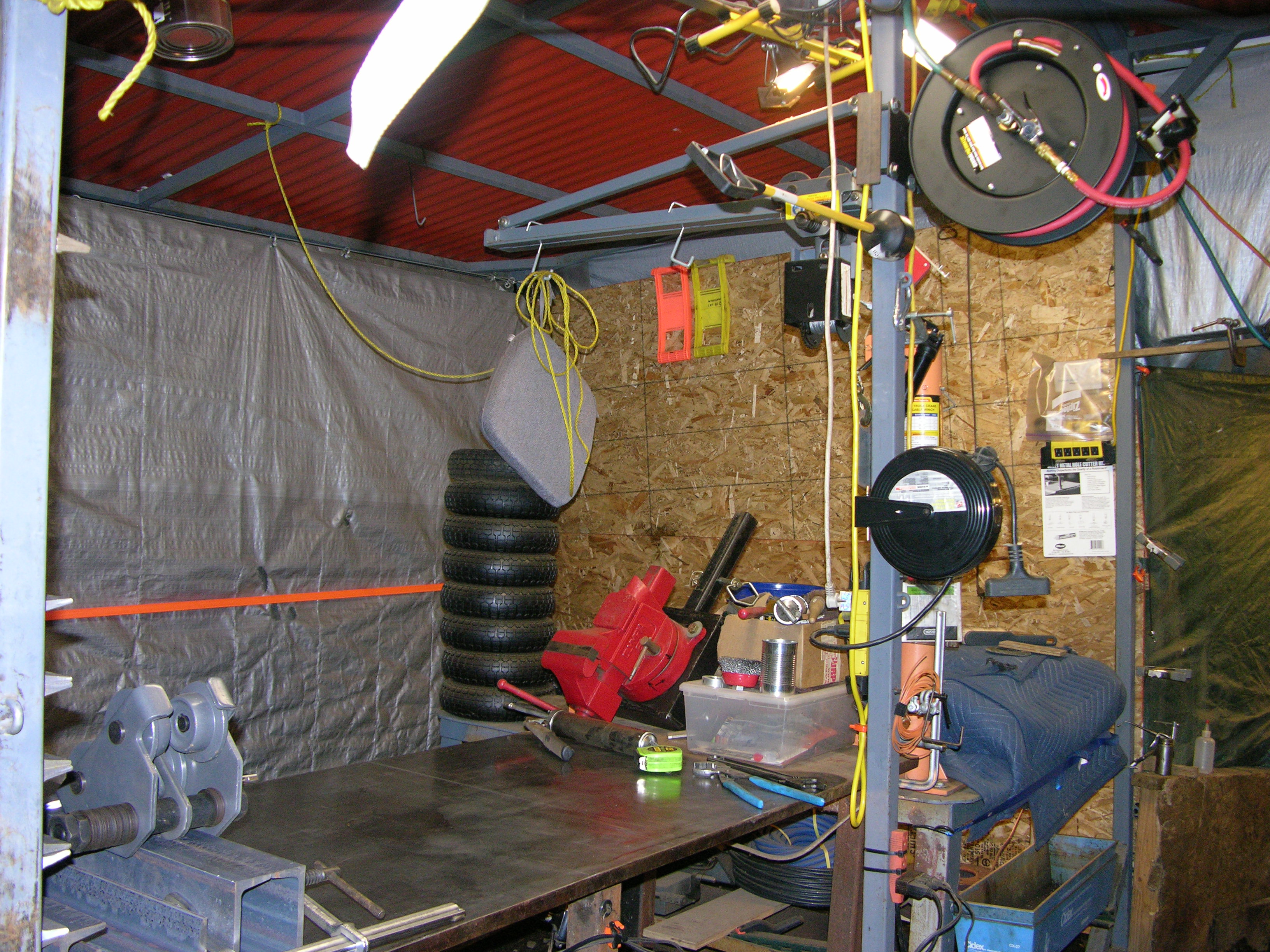

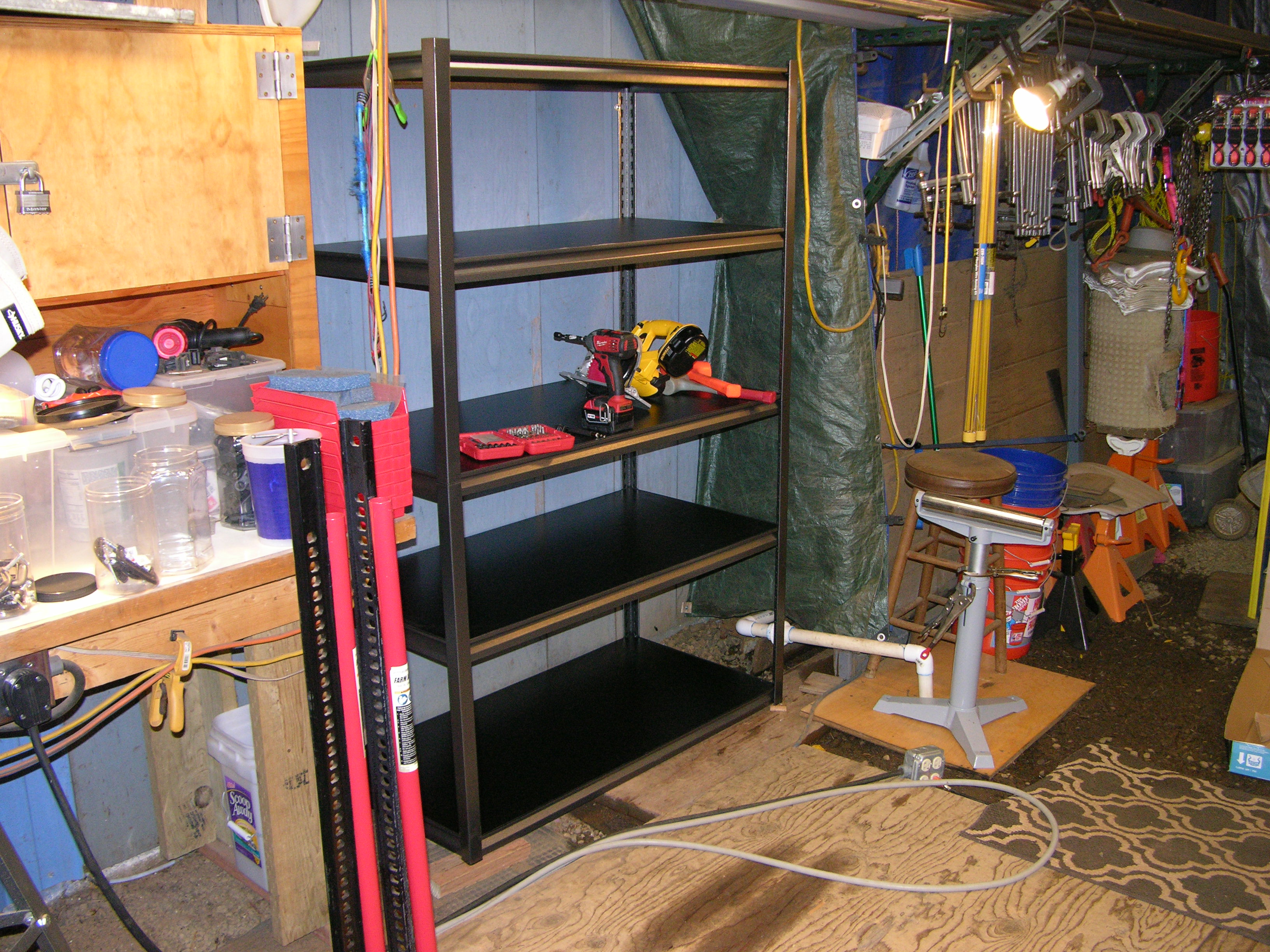

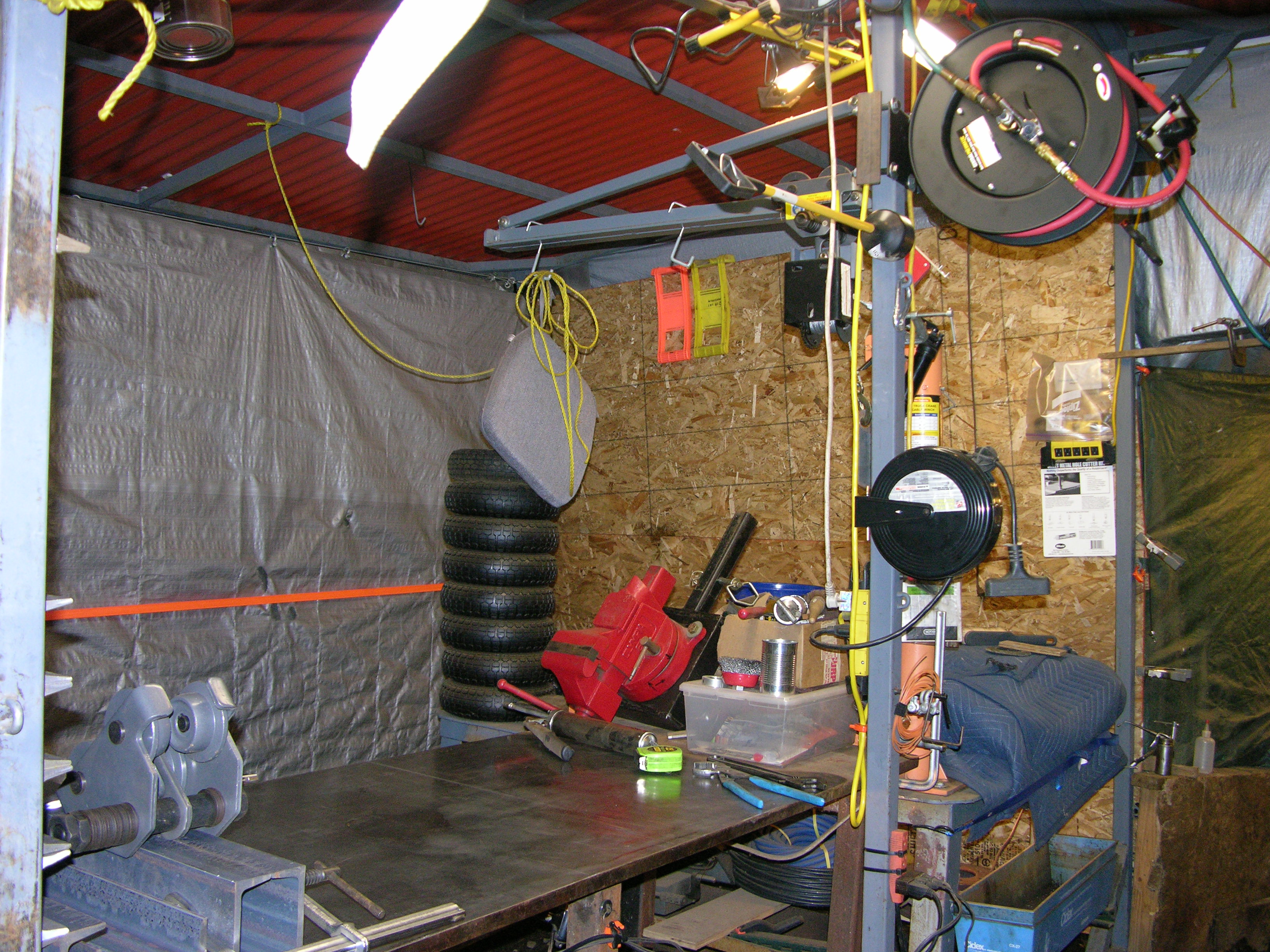

Got a little closer to being able to actually DO something the last couple days - my weld table (30"x84"x1" top) was NOT EVEN VISIBLE when I started - somethin' about flat places attracting crap - once I got MOST of the stuff off, it ALL looked like the part under that clear tote on the right -
A 9" Hitachi grinder with a 7" 36 grit flap disk and two arms that didn't work much afterward, and most of it is now clean - I put 3 mag-base 100 watt bulbs under it to slow down flash rust, and promised meself I wouldn't let it get this bad EVER AGAIN (or until I forget what a PITA it was to clean :rolleyes:)
The first pic shows a new 2'x4' storage shelf I put together today, blocked it up level and screwed to the wall - the honey oak stained object to its left was SUPPOSED to be a WORK bench; now, maybe it CAN...
The other pics are more relevant to the Container Weld shop thread so they'll go there... Steve

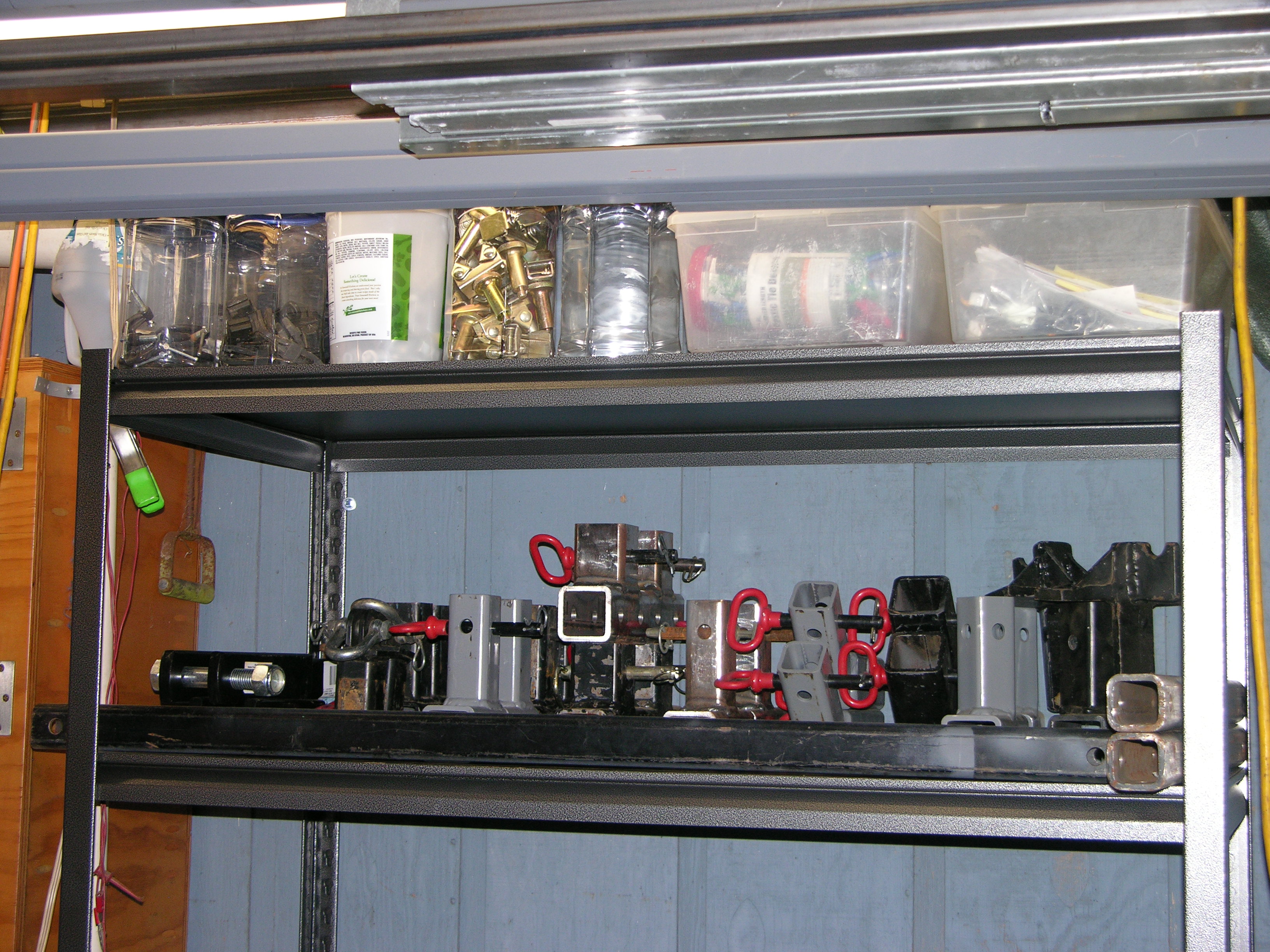

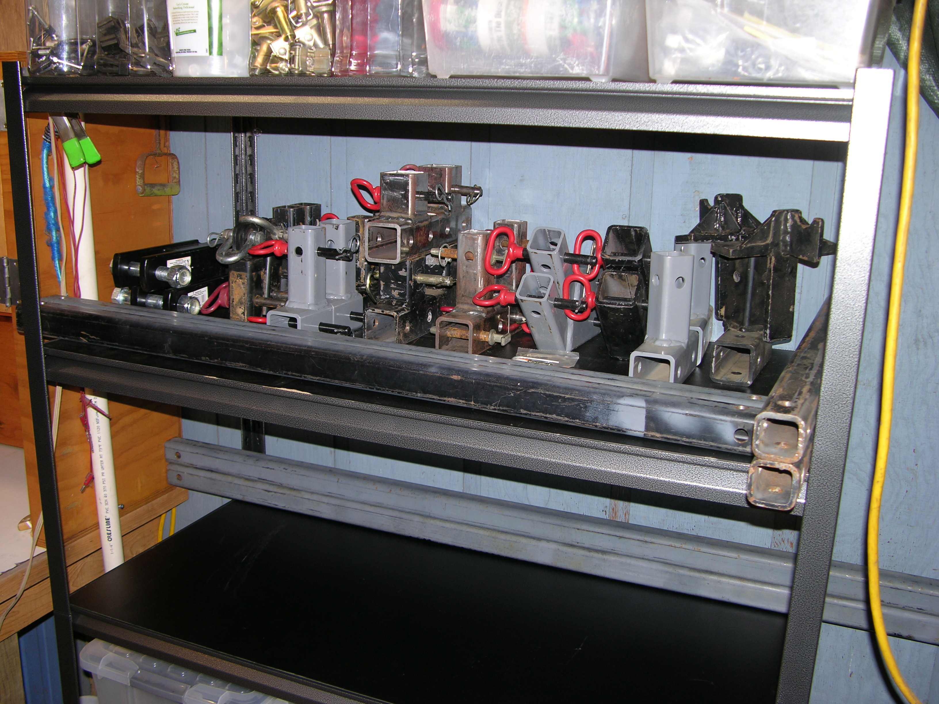

Got things a little more organized today, should be about ready to get back on the "quickie" cart for the new MM211 - then (hopefully) back on the "porch roof" for the weld shop container, then on to the bridge crane -
Been meaning to consolidate all my "tinker toys" I build for doing various rigging, etc, with the backhoe FEL - any time I can't see a way to accomplish a particular task with what I already have, I add another "toy" to the set - it's reached the point now that I seldom need to build another adapter to rig something for a job -
There's a couple "store-bought" pieces in there, but nearly all are built by me. Some are male-male, some male-female, some female-female, some tees, 45* in several different directions, whatever seemed like a good idea at the time :D
One of the "toys" isn't there, but is in one of the earlier pics - the receiver mount vise seen on top of the weld table... Steve

Love that first pic, Steve. My job time has seriously interfered with my shop time. Walked out this evening and couldn't find a pic and story that was worthy of posting. Can't wait to xmas time and I can get back at it.
/ Todays shop time. #318
Thanks Dragon - until I put that shelf up, half the time I coudn't find the particular "toy" I needed - now, all I gotta do is remember to put stuff BACK :confused: Earlier today I found a couple of the "TT's" in one 40' container, 4-5 more in the 20' container, 3-4 more in the wood shop, another 3 on my 18' flatbed under a tarp along with several implements, and a bunch on the smaller steel "mag drill" bench (still not cleaned off, BTW)
I keep thinking I should build a "rigging stand" that could be moved by hand truck/pallet jack/forks, etc, but when I see all this stuff together I doubt anything but the old Case could MOVE it :rolleyes: ...Steve
