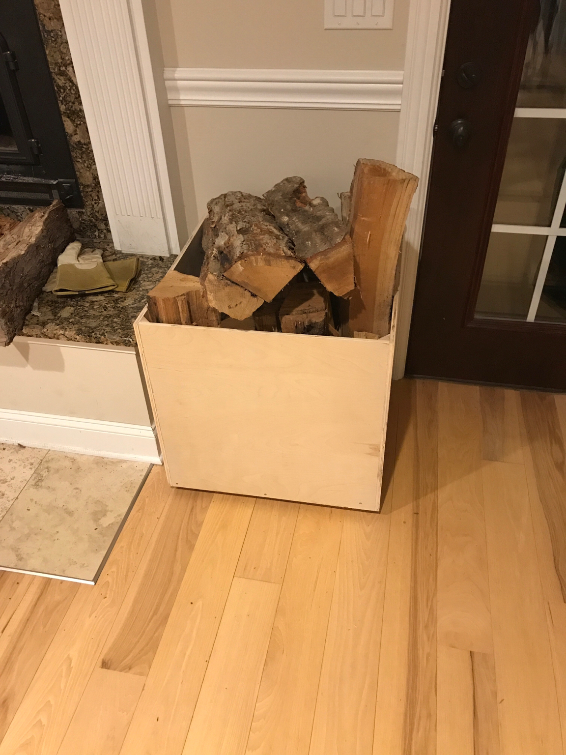

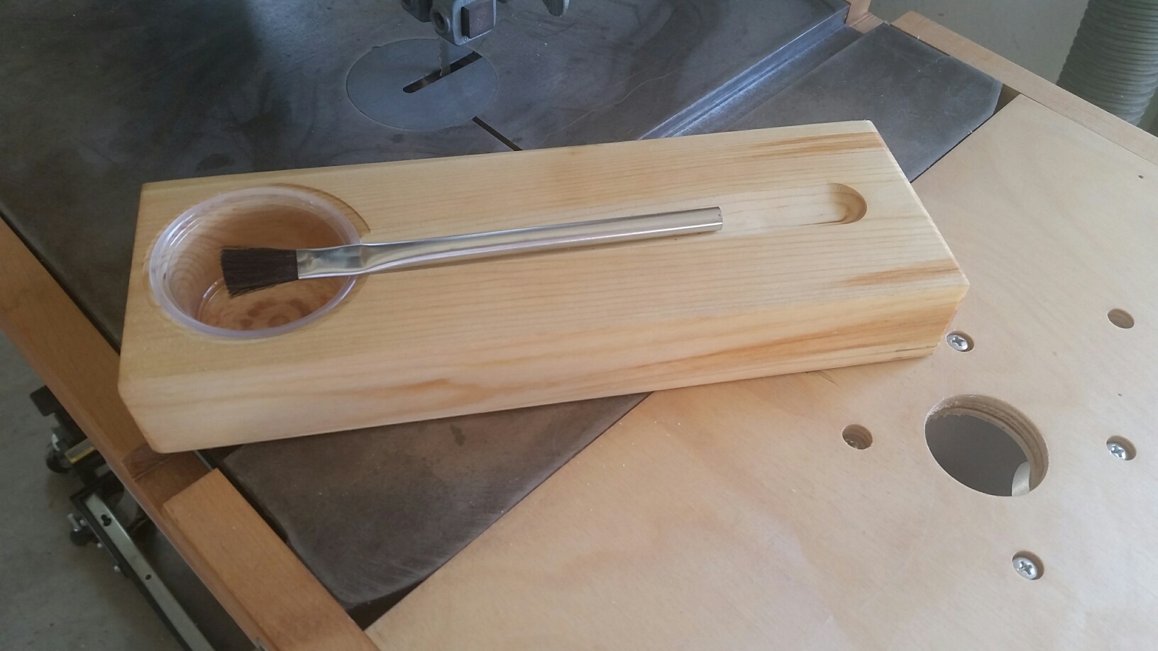

I got my box done. I failed to realize most of my wood is cut longer than 23" so I have to stand it up. IMG_0682.JPG

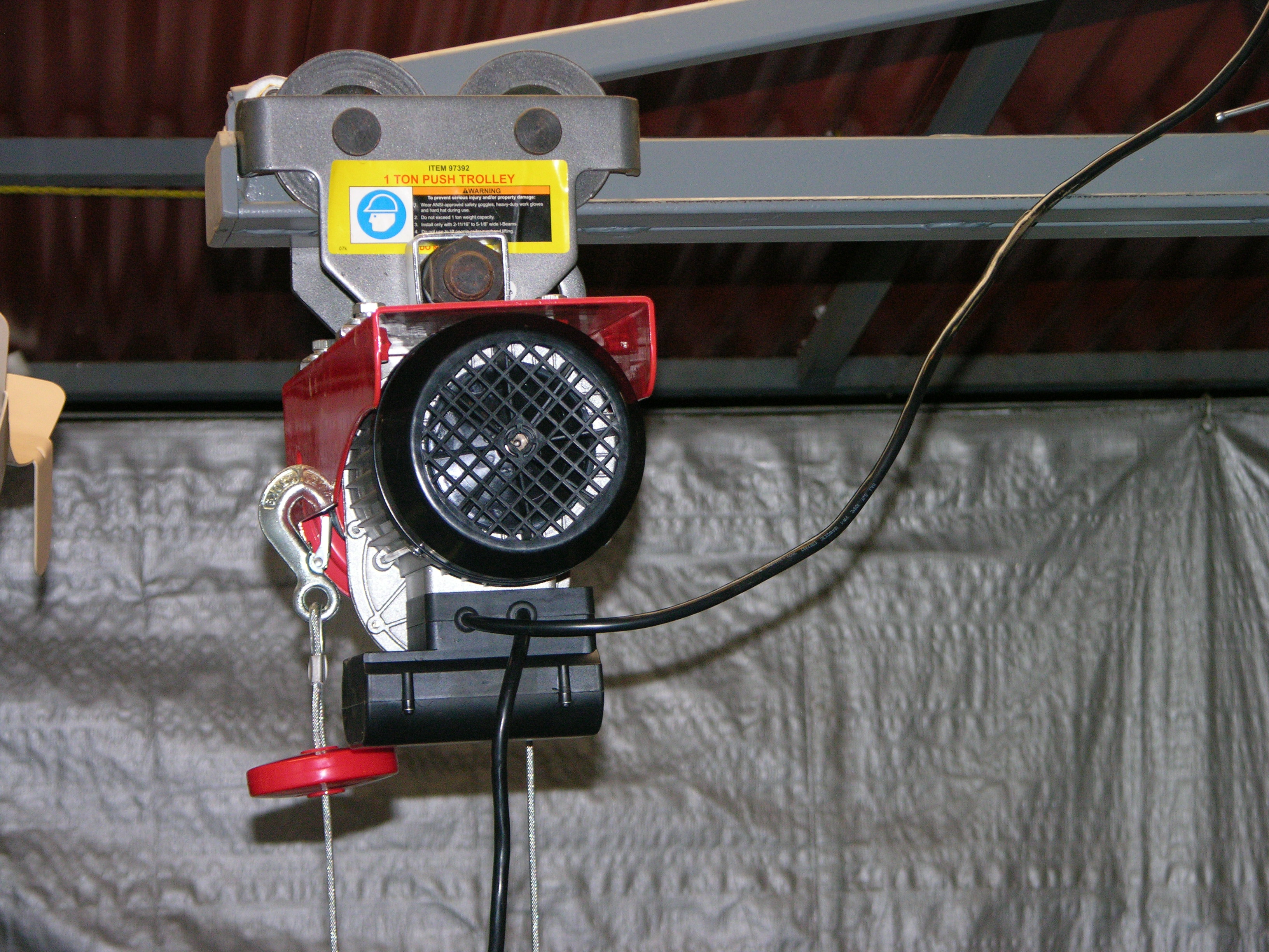

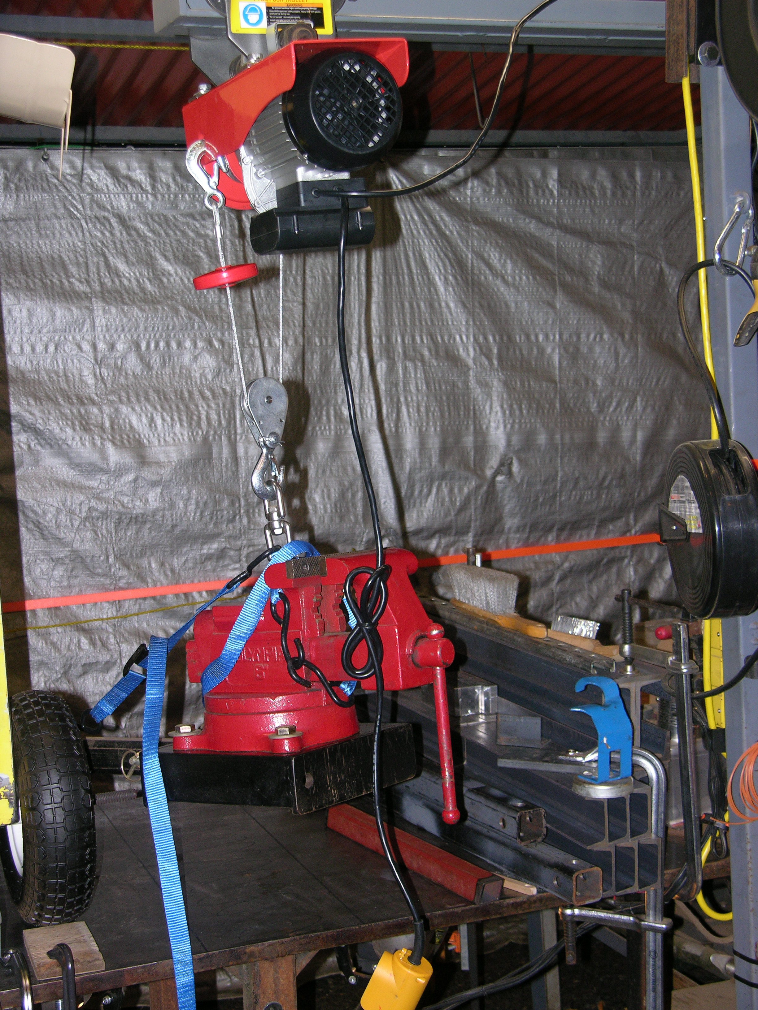

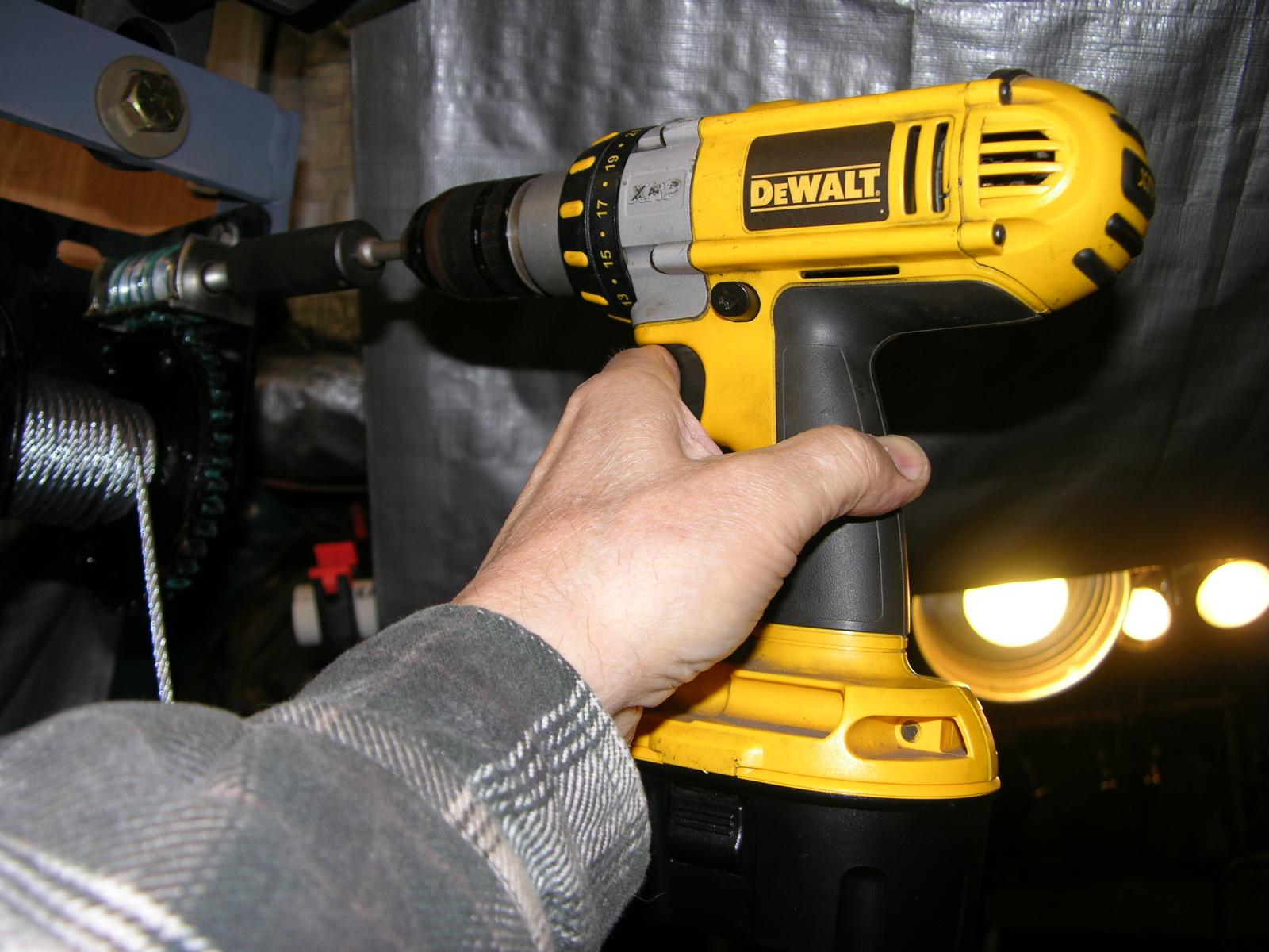

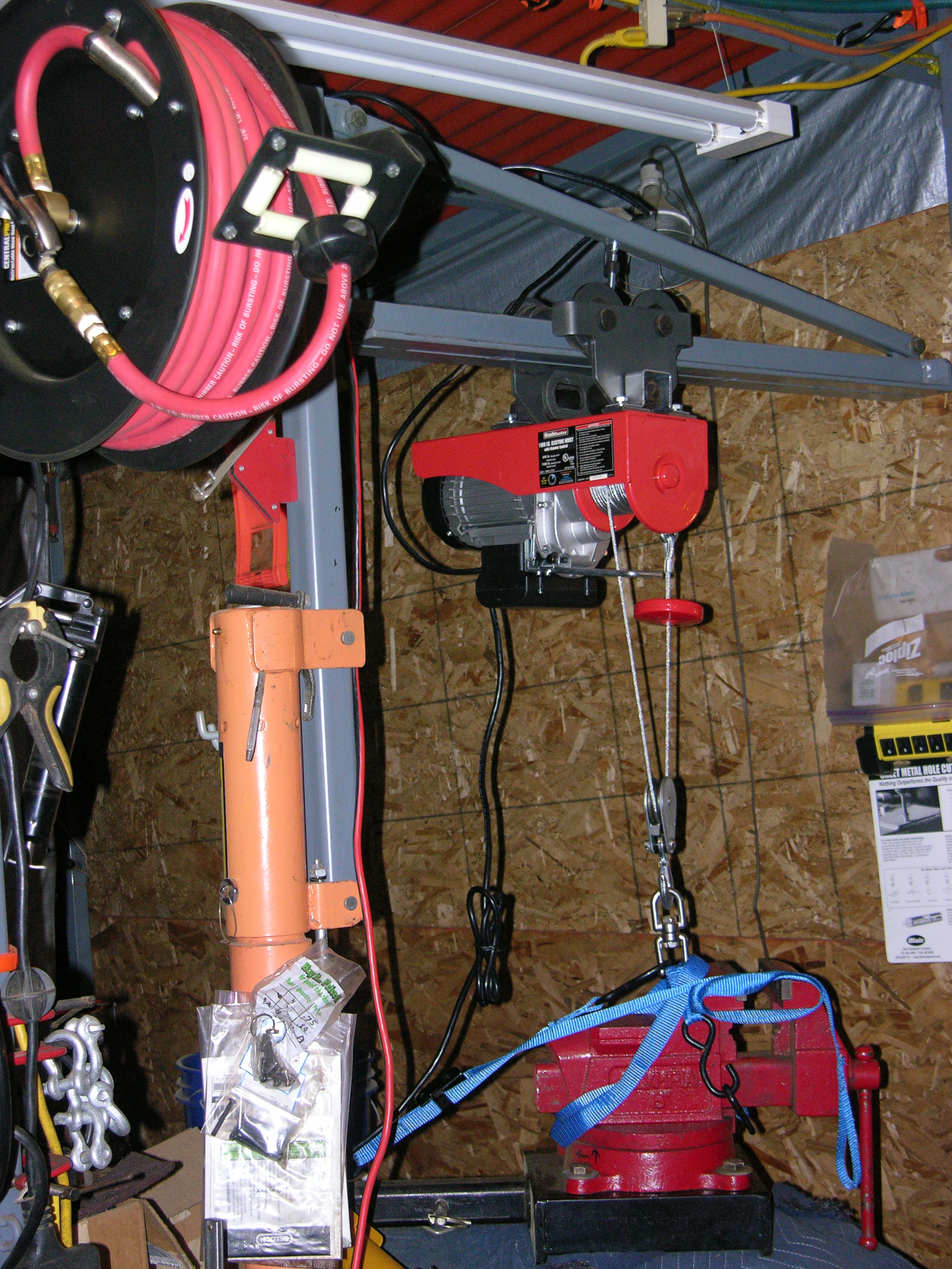

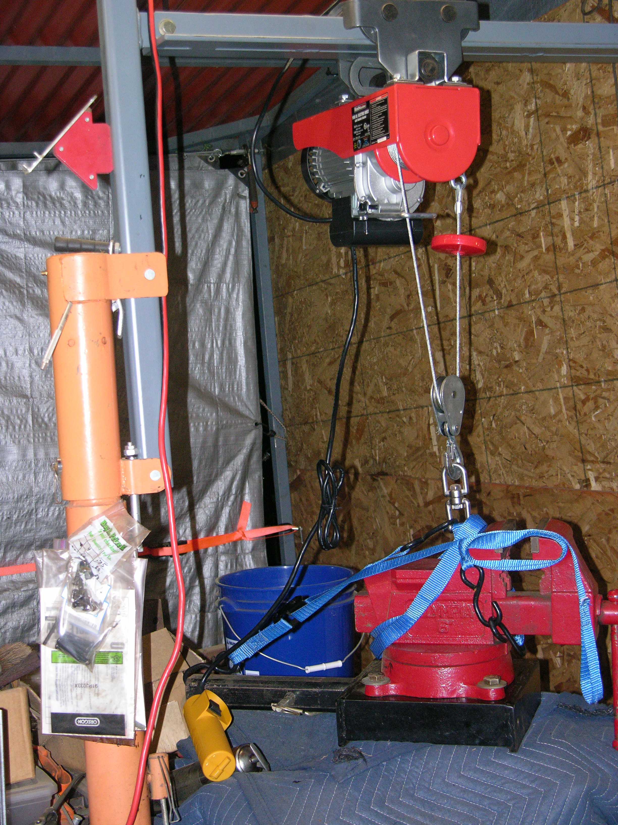

Got tired of tryin' to find/assemble a 19mm socket, hex adapter and drill when I wanted to move something a bit heavy, so I changed this DSCN1957.JPG
Couple minor bugs to massage, like keeping the trolley from running over the power cord :rolleyes: but that vise in the pics weighs about 100 pounds - moved it by hand the other day, spent the last TWO waitin' til I could take more Ibuprofen :confused:
Now, I just moved that vise from one table over to the other one and back, put it on the floor and back, and I'm still movin' :cool2: ...Steve

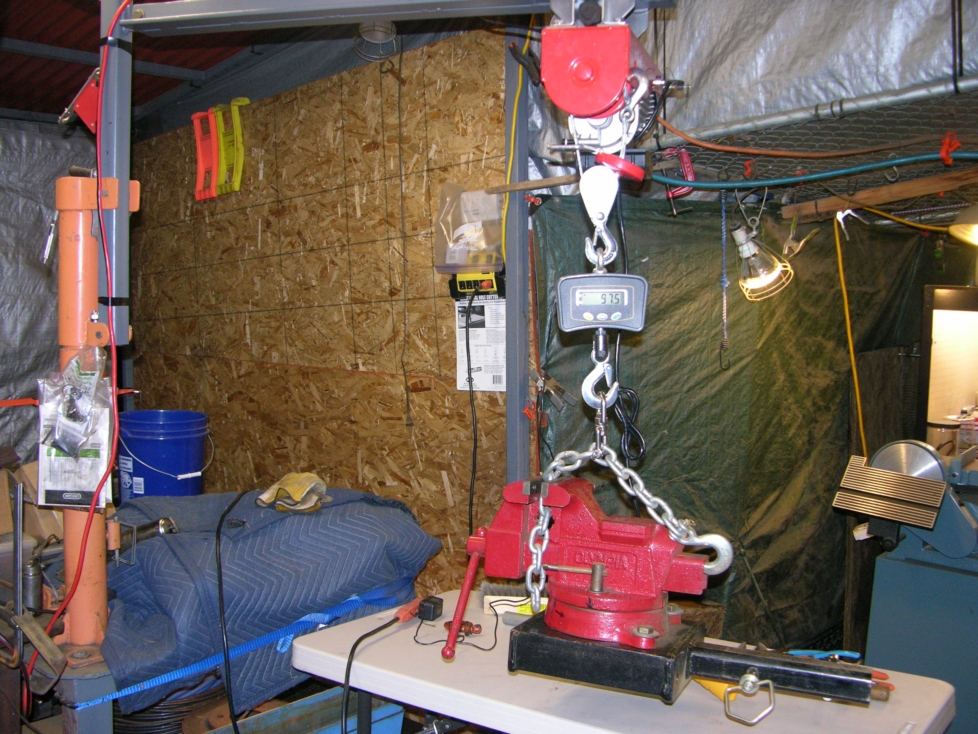

Fixed the power cord thang, couple other adjustments - looks like I wuz off on my weight estimate - only 97.5 lbs :rolleyes: Hadn't used the small crane scale for quite a while, looks like I'm gonna hafta open it up and find out what kind of battery it takes - won't work unless it's plugged in... Steve

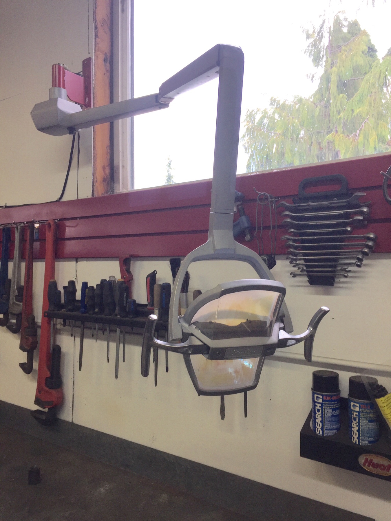

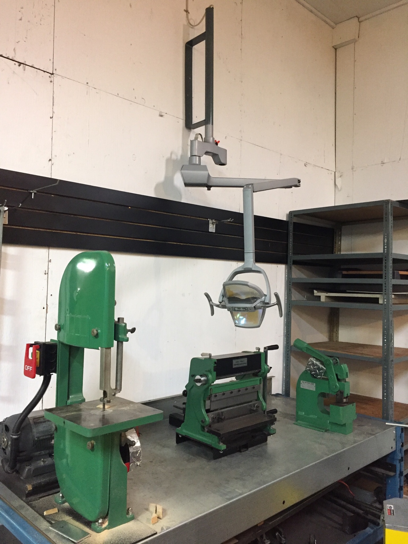

"Let there be light"
I had a double head ceiling mount dentist light fixture that I finally got around to mounting. I separated the units and fabbed up new wall mounts.
I went to the dentist last Fri. and those lights are bright, sun glasses are required. So you going in the dentistry field to, hope your up to date on epoxy tooth welding................
So you say, show me instead with a better picture and I'll let you know if you fixed the power cord thang, your telephone pole might not be space out right. The lift does look to be on a swing around jib crane, I must've missed that build, how'd that happen.
I was thinking of one of those power lifts on my Jib crane but at the time they was just a little to much$$$, I'll revisit that idea at a latter date, chainfalls at $50.00 was more affordable and more portable. I had to mark UP/DOWN on it so I know which way to yank the chain

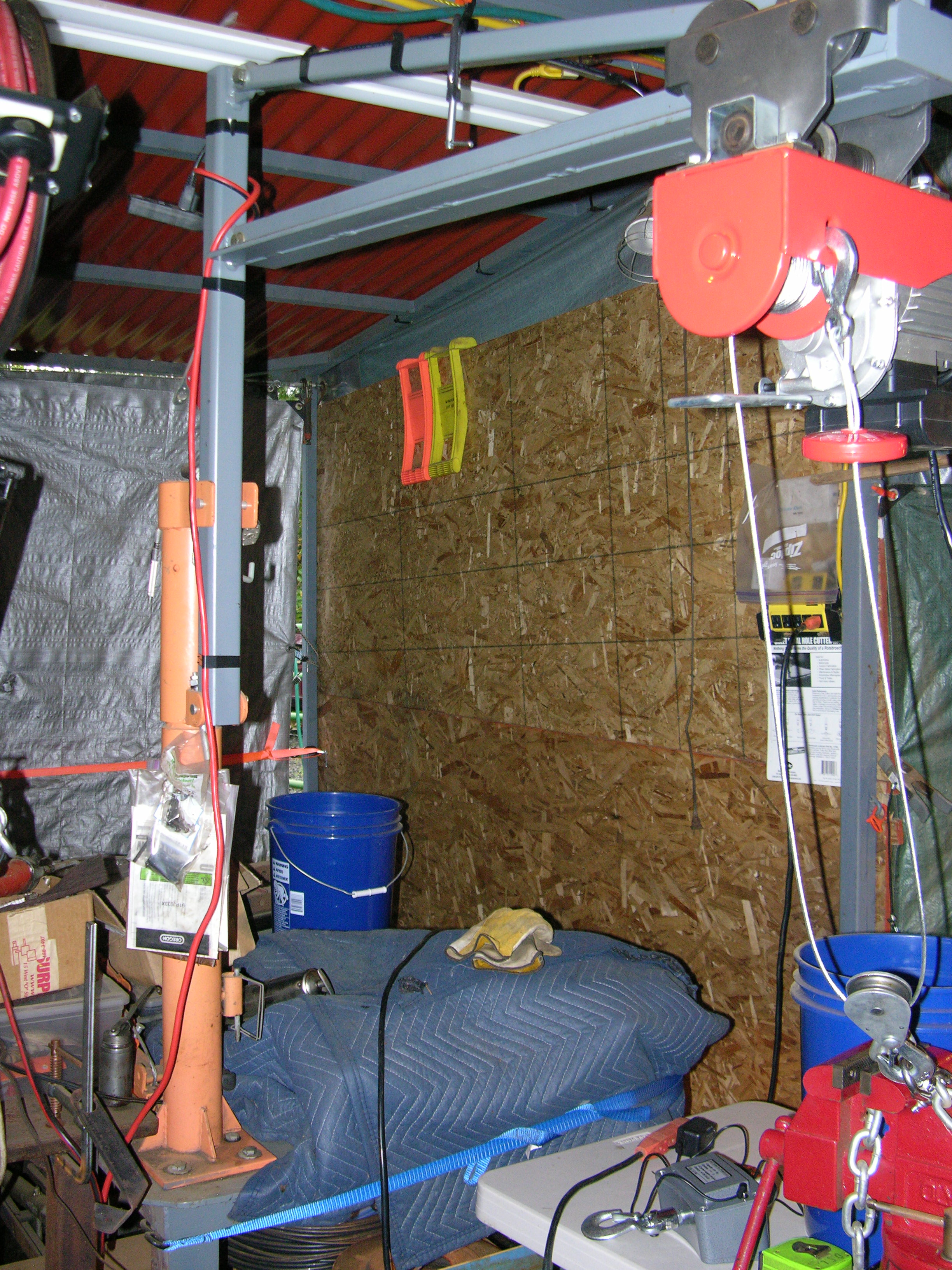

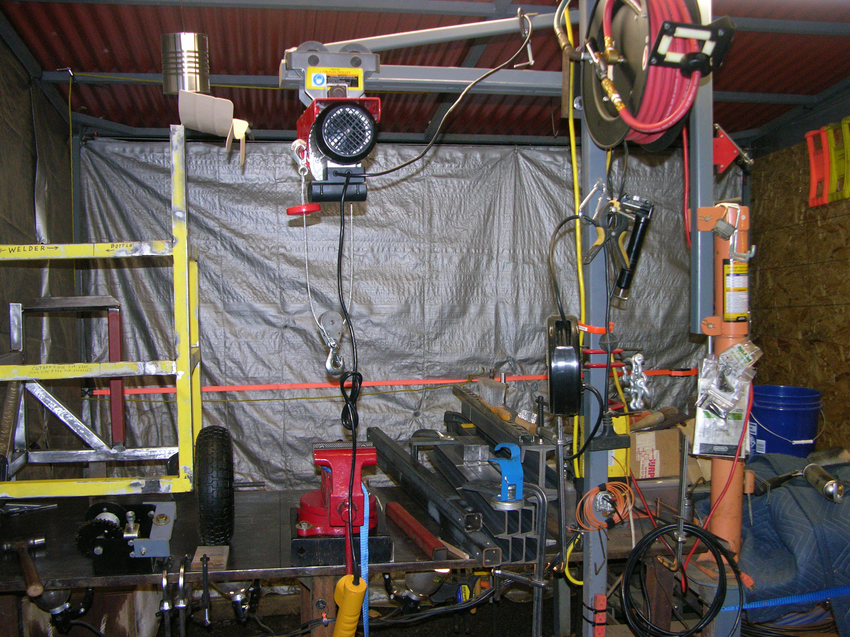

"Fixed the power cord thang"
Here ya go - thought I posted the "mini-jib" build on here, but I'll add a few pics... SteveDSCN2903.JPGDSCN2904.JPGDSCN2906.JPG
Amish cad and a few more -
BTW, ZERO mods to the HF pickup crane, just don't USE a couple of the pieces...

I would not bet my life on HF engineering...please be careful with that crane until you prove it out.
pics were great
/ Todays shop time. #379
Thanks, glad you like -
"I would not bet my life on HF engineering" -
Nor do I :rolleyes: - they rate that crane at 500# with boom fully extended and 1000# at shortest position - my general rule of thumb with their stuff is to cut their rating in HALF, then try to keep it at half of THAT most of the time :D
The crane's mounted to a steel table that weighs around 500# - that table is ALSO clamped to my 3'x7'x1" thick, 800# table - I weigh about 190 fully dressed, and have swung/bounced my weight at the outer end of the jib and nothing moved or flexed.
Heaviest thing I've lifted so far weighs a little over 100#, and no intentions of doing anything more than maybe 200.
In fact, it's worked so well I plan on doing a nearly identical one for my milling machine - I have an 8" rotary table with a 6" chuck attached, an auxiliary angled table and a 6" Kurt vise that get swapped out depending on need, and that size jib will let me keep those on the roll-around cart they're stored on and swap back and forth without wishing they were lighter. When THAT project makes it to the top of the list I'll take the mill off the shipping pallet it came on, and make a "pallet-jack friendly" base for it that'll incorporate a mount platform for the crane (using the 1000# mill for a counterweight)
Spending the last 35 years in heavy industry taught me quite a bit on how to survive this type of operations, and a healthy dose of pessimism is a large part of it... Steve
/ Todays shop time. #380
I had one of those bolted to a dual axel trailer that I used for years, until I got the tractor. It lifted 400lb outboards fully extended all the time without failure, course I never put any personal parts under them;)
