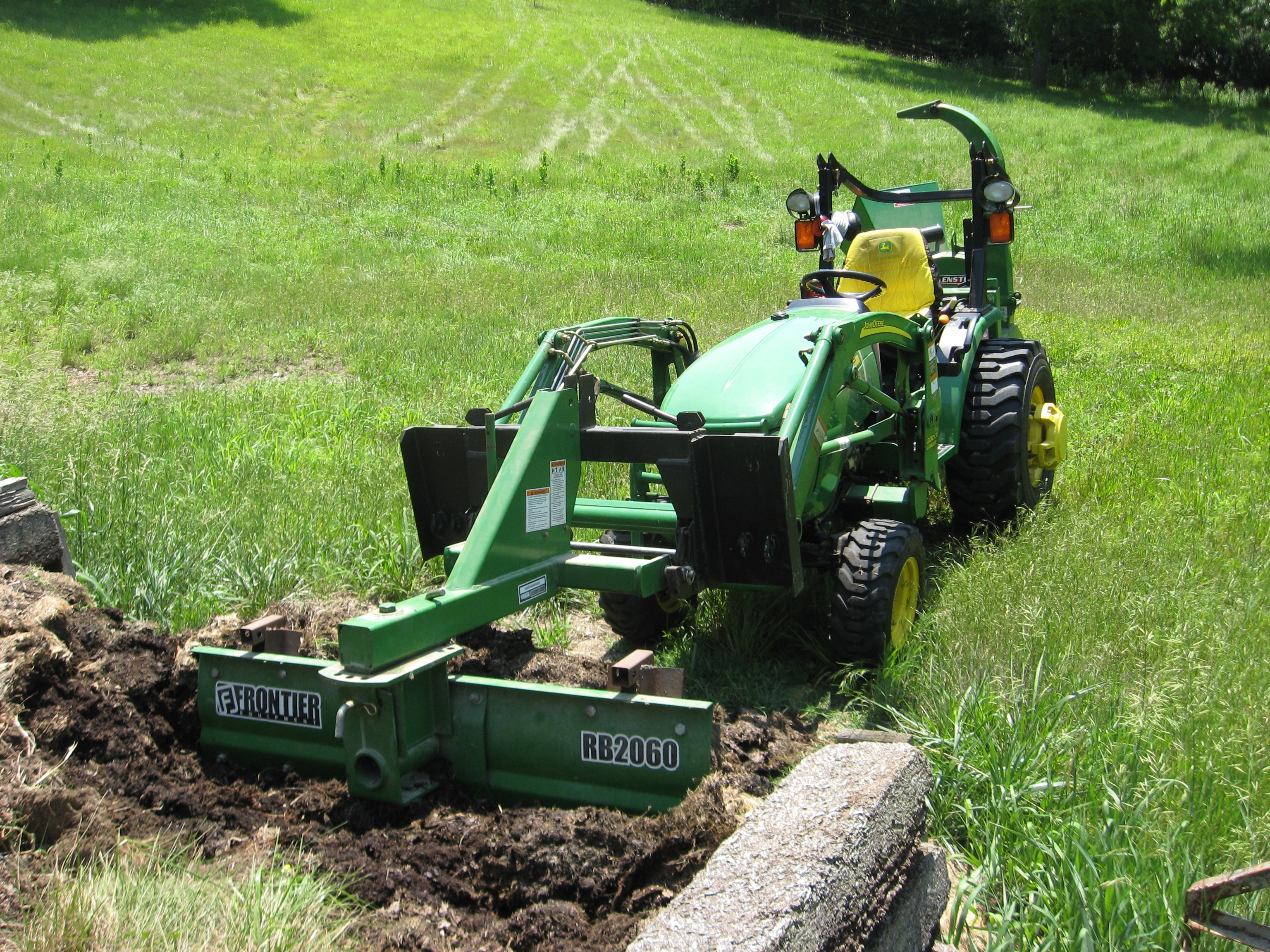

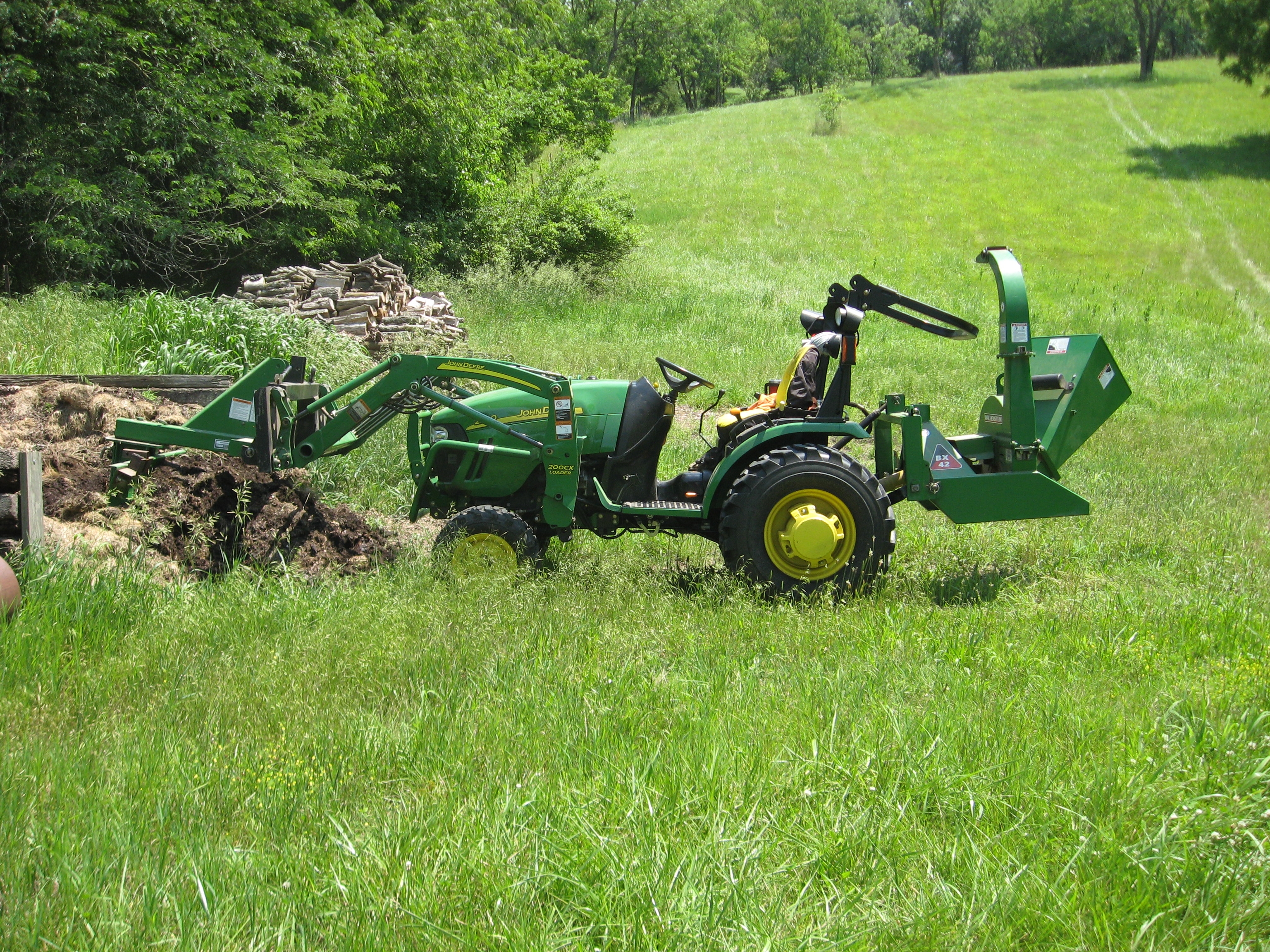

Don't try this at home, kids: Used the rear blade on the loader to work the compost pile - and the bucket for some clean-up work, etc.

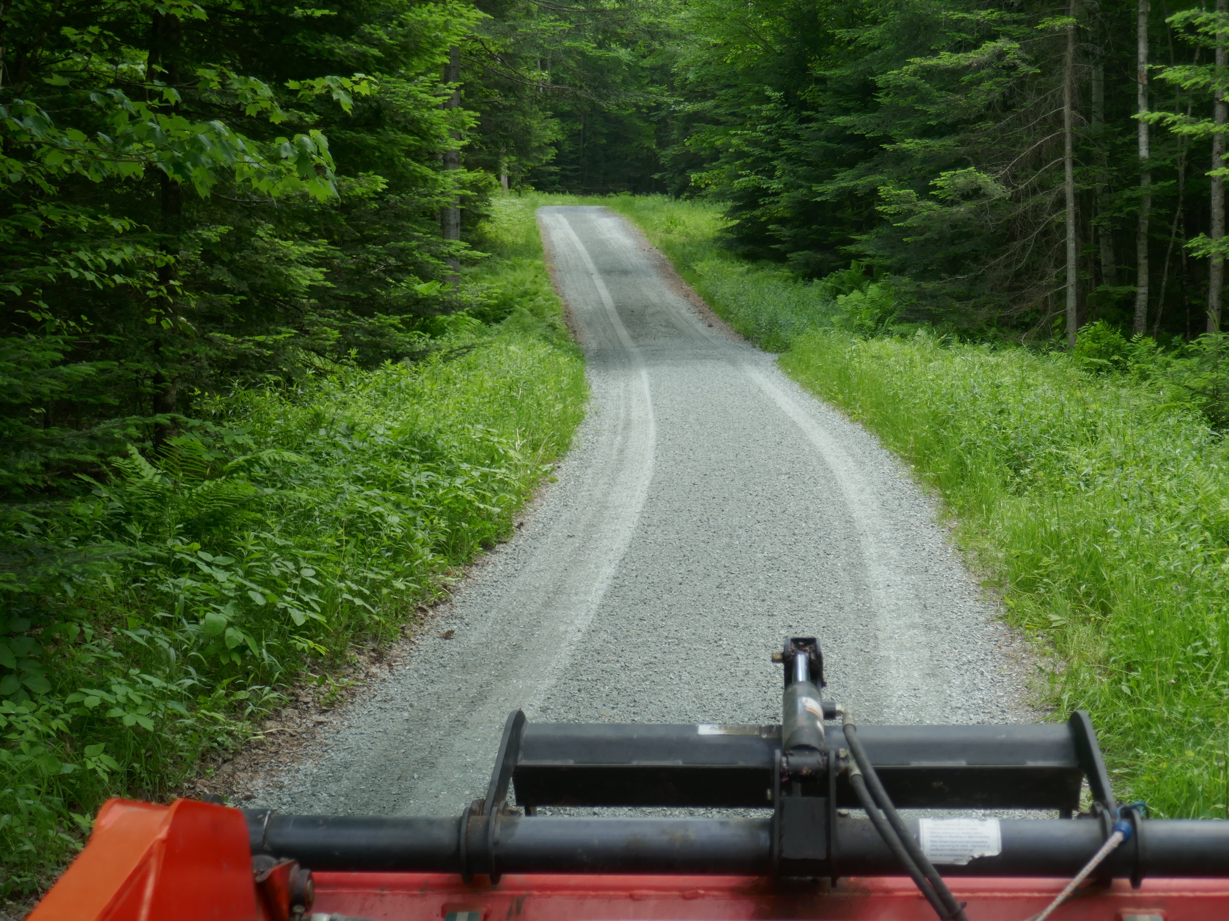

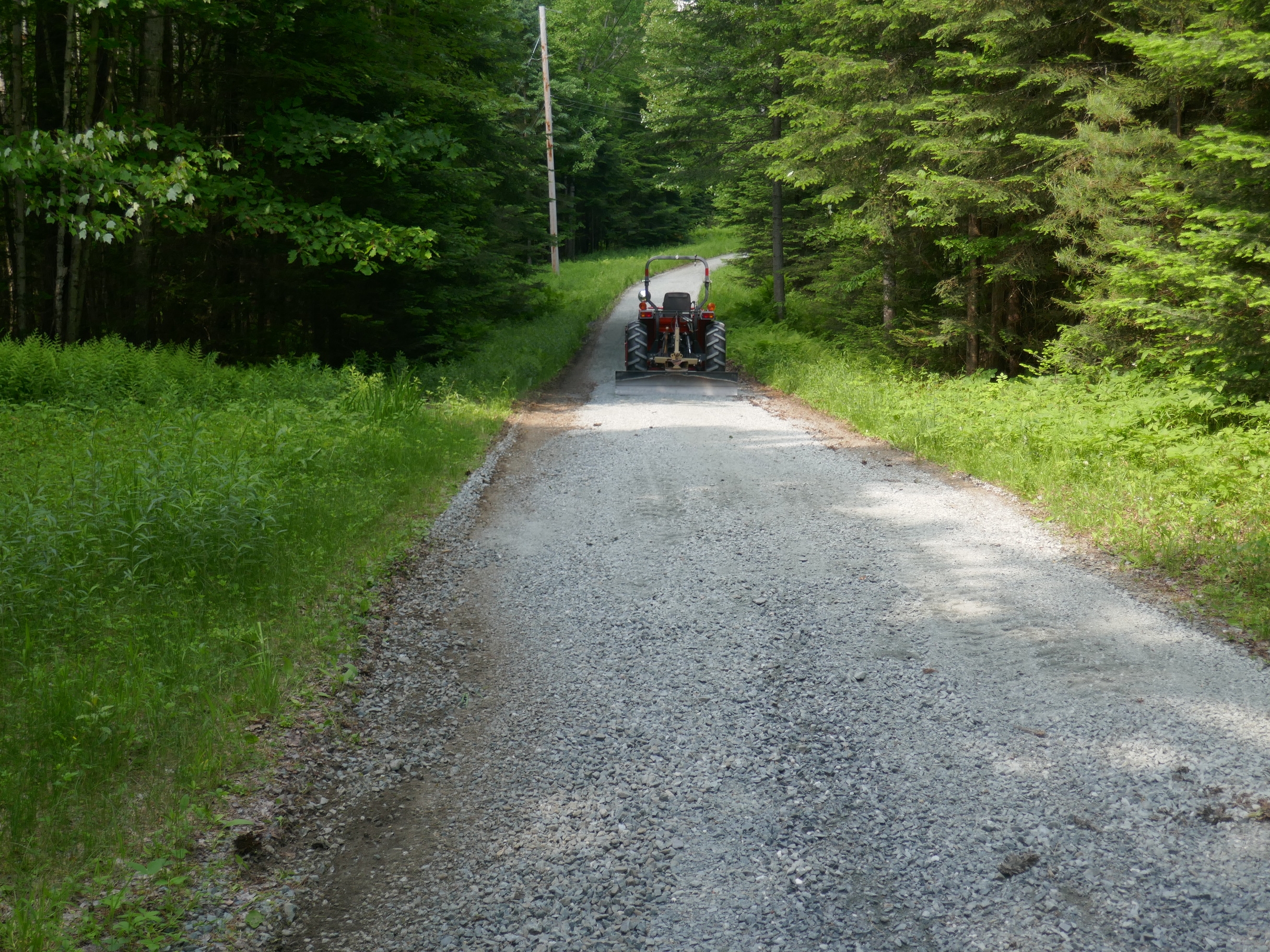

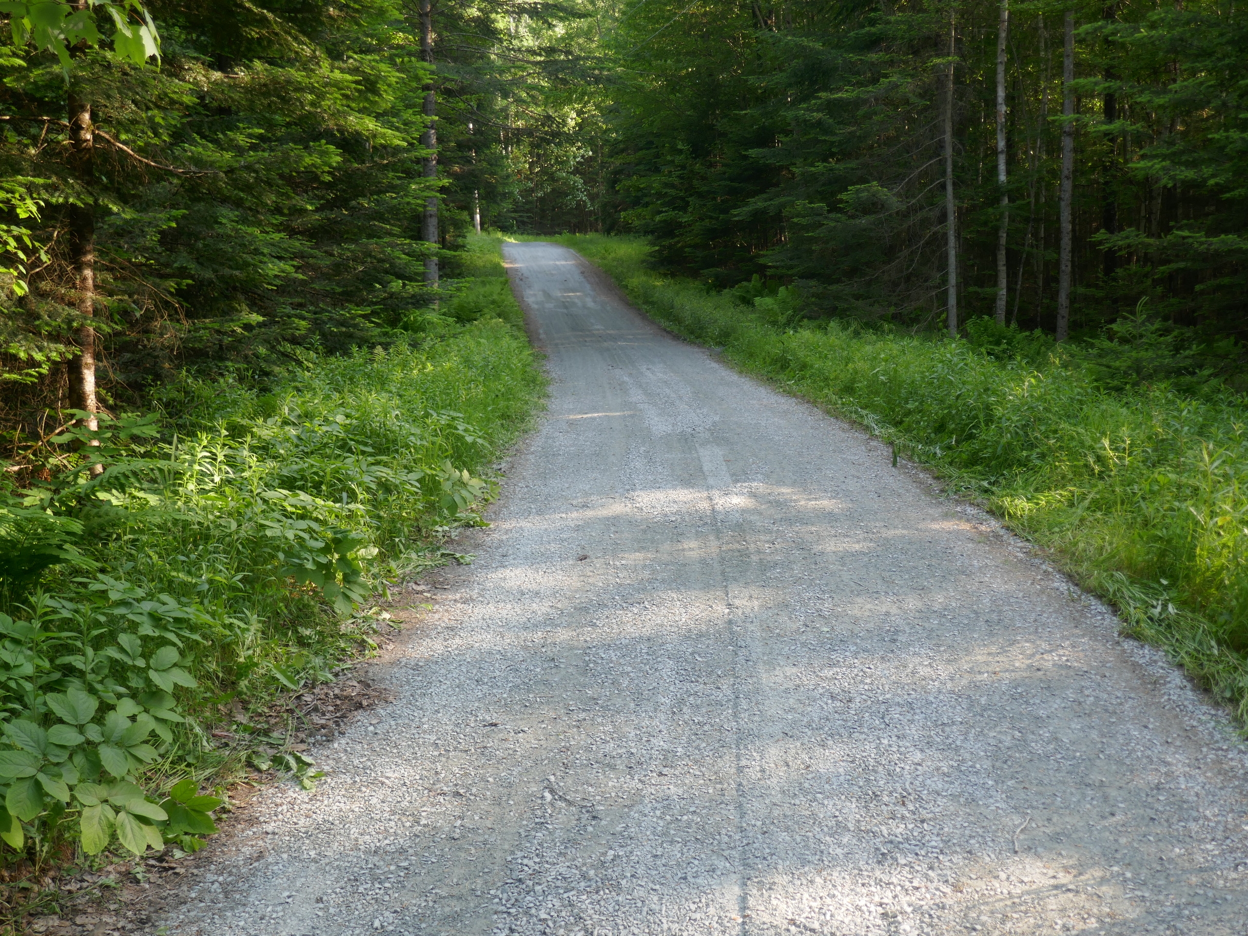

I had a section of drive/road where I couldn't grade out the wheel ruts any more, So today I tail gate spread from the one-ton 4 loads, 12.6 ton, of 3/4" Stay-Mat over 350' of road.
Then I shaped it with the back of my rear blade to make an even crown.
Last I packed it with the one-ton. Couldn't quite reach a narrow strip in the center.

The first picture looks unbelievably smooth !
What is “stay-mat” ?
I guess it is a local name here that applies to a road surface gravel mix that packs well - like "crusher run". What I get is from a local Pike plant. It is all crushed ledge and is a mix from 3/4" crushed rock down to stone dust with a little clay added.
With a little practice it tail gates out pretty well. On that stretch I ran down each side of the road with a load so there was double coverage in the center and thin on the edges. Makes it easy to crown.
