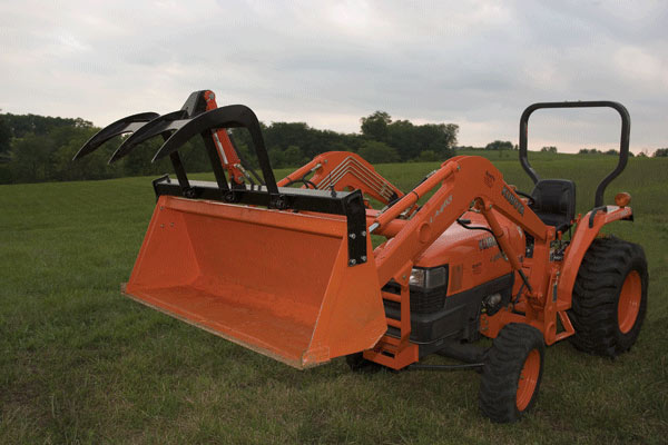

   / To grapple or to not grapple... #46
   / To grapple or to not grapple... #47
That approach is definitely worth considering to save a lot of $$$ and still add a whole lot of functionality to your bucket. Obviously not as effective as a regular grapple, and it might be tough to grab a log, but maybe you could add some stubby bolt-on pallet forks to the bottom edge of the bucket?
Haven't seen that particular brand before but it looks pretty well-made.
