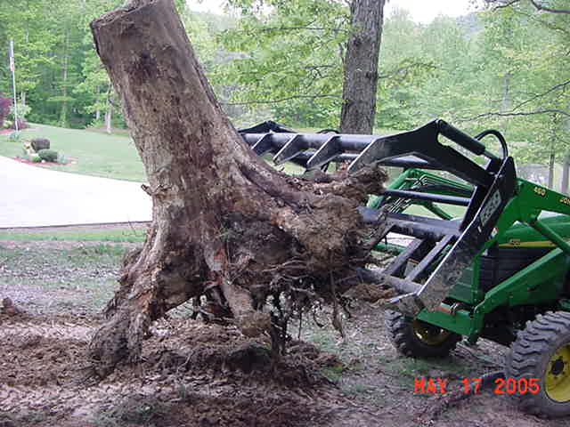

pic 3

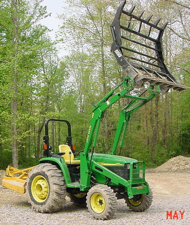

pic 4

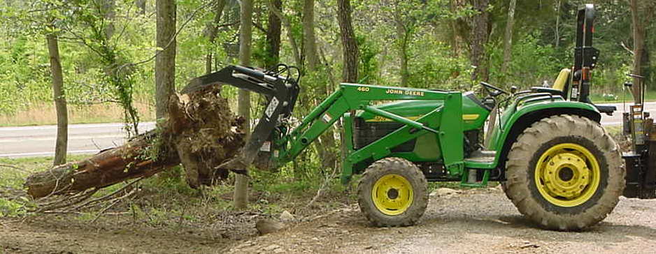

pic 5

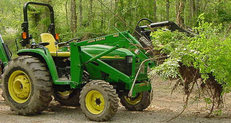

pic 6

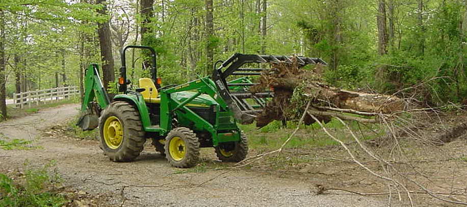

One more.
BTW - this is a 72" RGB from WR Long on a JD 4710 with a 460 FEL. This grapple weighs over 800 lbs. not counting the weight of the loader so you need some decent ballast on the back. The 48 BH works great.
Here is a link to their website - WR Long
I'll try to find some pics of the joystick control and the diverter valve setup.
