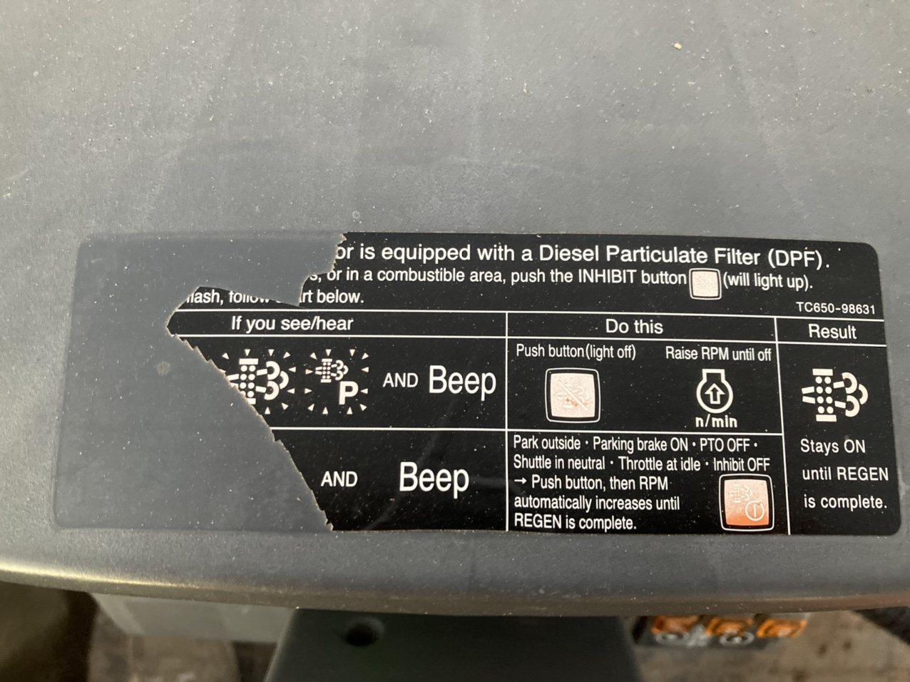

Does anyone have this complete sticker?
Don... If you look in your Kubota owners manual or in the WSM if you have it, Kubota will call out every sticker placed on the unit and the location. If not, your local dealer can help you out.
I cannot hear any beeps, they must be at a frequency my hearing aids do not pick up with the tractor running.
The manual does not say what the difference between the flashing and the non flashing regeneration icon is.
I had hoped someone had the same sticker on top of their dash so I could find the missing part, it is not in the online owners manual.
