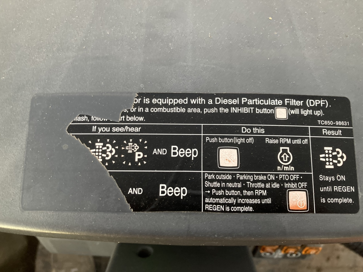

At work (if you want to call it work) I'm driving a Kubota that uses DEF Fluid. The tractor runs almost continuously during a 9 hour shift, it has some instructions on top of the dash about the icons but it is not readable half of it has been torn off. it is a Kubota M6H-101 Hydraulic shuttle (no cab). I'm mostly concerned about When it regenerates, the RPMs, What happens if it is interrupted etc. . . I was told it should run at 2,000 RPM at all times, not just during regeneration, but that just seems a waste of fuel and very loud.

As far as the dpf concerns, the rpm recommendations during normal use are reasonable. If there is any confusion about the various Regen lights or controls, those should be addressed and the controls relabeled.
I personally run my machine at a 1500 rpm idle, but when a Regen is called for I need to raise the rpm for the process to start. Better know where the "raise rpm" light is.
My other recommendations would be to not delay or interrupt a Regen. If the machine is in a combustible area, go somewhere else rather than delay or interrupt. I have worked through all of the Regen cycles on my machine.
For dashes that report dpf status on the LCD screen it's easy enough to plan around a Regen. I save up 15 minute jobs to do during a Regen if I don't have current (real) work to do. Over the past 6 years my L4060 (no DEF) has regened 13 times, average of every 50 hours, taking about 12-15 minutes each.

^This is what I've found also.
I was very concerned about the regen process when I first bought my Kubota nearly 5 years ago. And the above is what experience has taught me. Keep the rpms up, and keep working. I see the regen light in the dash come on...and then 15 or so minutes later it goes off. That's all there is to it. No input from me is needed.
There has been a time or two when I was doing something such as hooking up an implement and the engine is at idle and the regen light comes on - but in those cases there is a second light that starts blinking, telling me to raise the rpms until that blinking light goes out. So I apply throttle until that blinking light goes out; the regen process then proceeds. When the regen lights in the dash go out I then can return the engine to idle.
