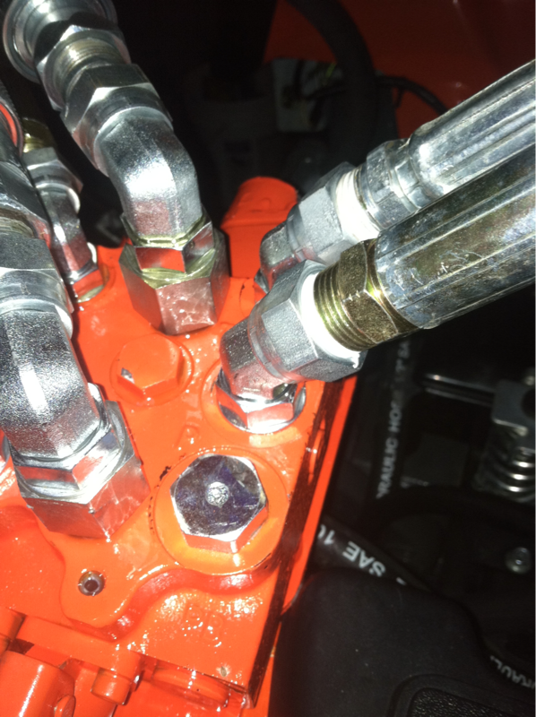

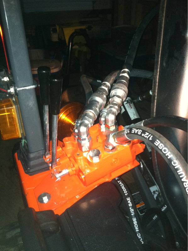

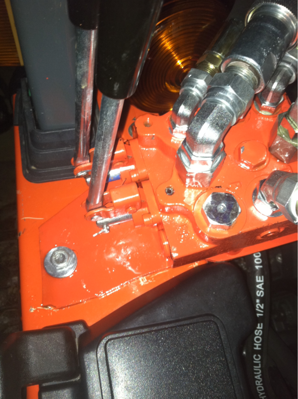

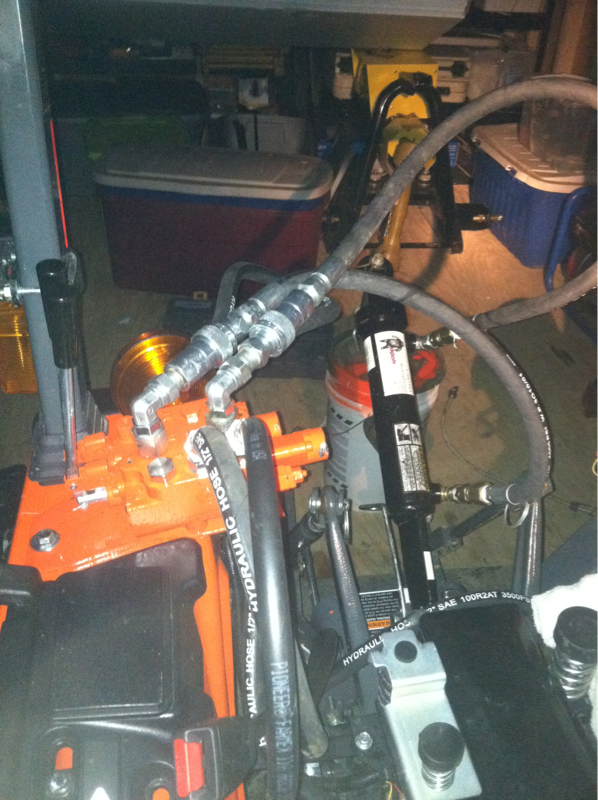

K folks it's finally in but I got hydraulic power to the back witha 2 spool remote and top lol installed, remote $219, cyl $129, shop work to pull the Hydraulic power $310.,, hoses and fittings about $160, and I am still looking for tje splurged to be able to choose between TNT and hoe ( push or pull a knob)
As you can see in the pics, I put the remote just behind the right fender, with the supply and return hoses running.
Any questions or recommendations , the second spool is primarily for snow chute rotator motor when I her around to figuring it out

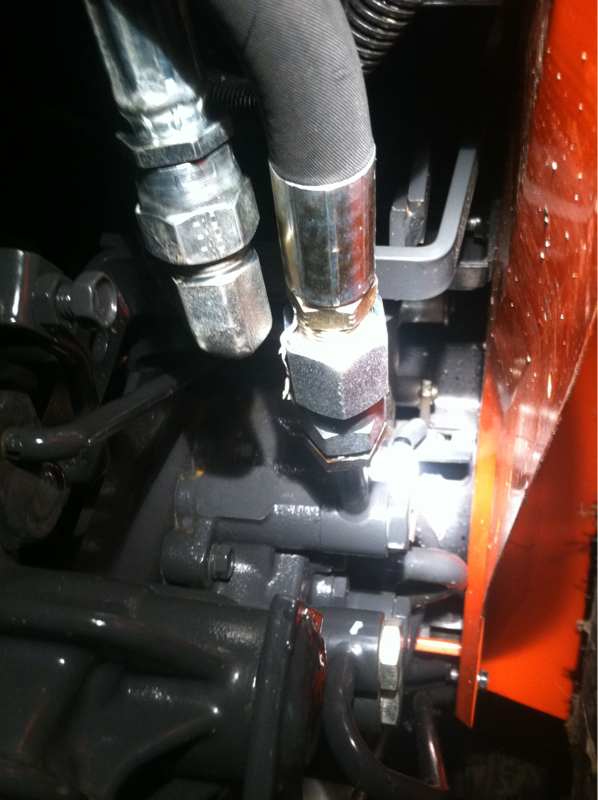

Where did you get the fittings that connect the hoses to the loader valve? Were those Kubota parts? Or do you have a BH and those are the hoses/fittings that run it?
I'm getting ready to put a set of rear remotes on my B3200, still trying to decide how to tie it in to the tractor hydraulics though.

Looks great... only change I can think of is... you could have gone 2 steps smaller on the hoses that go to & from the TNT cylinder... You really don't need the flow rate of a 1/2 inch hose...
Looks good. KennyV

Vertical ,, the. Dealer took a Kubota fitting and braced a #9 jic male fitting onto it,, I am putting in a selector valve that will allow me to mount a set of QCs on the other side for the BH,,

The 1/2" hoses were cheap
