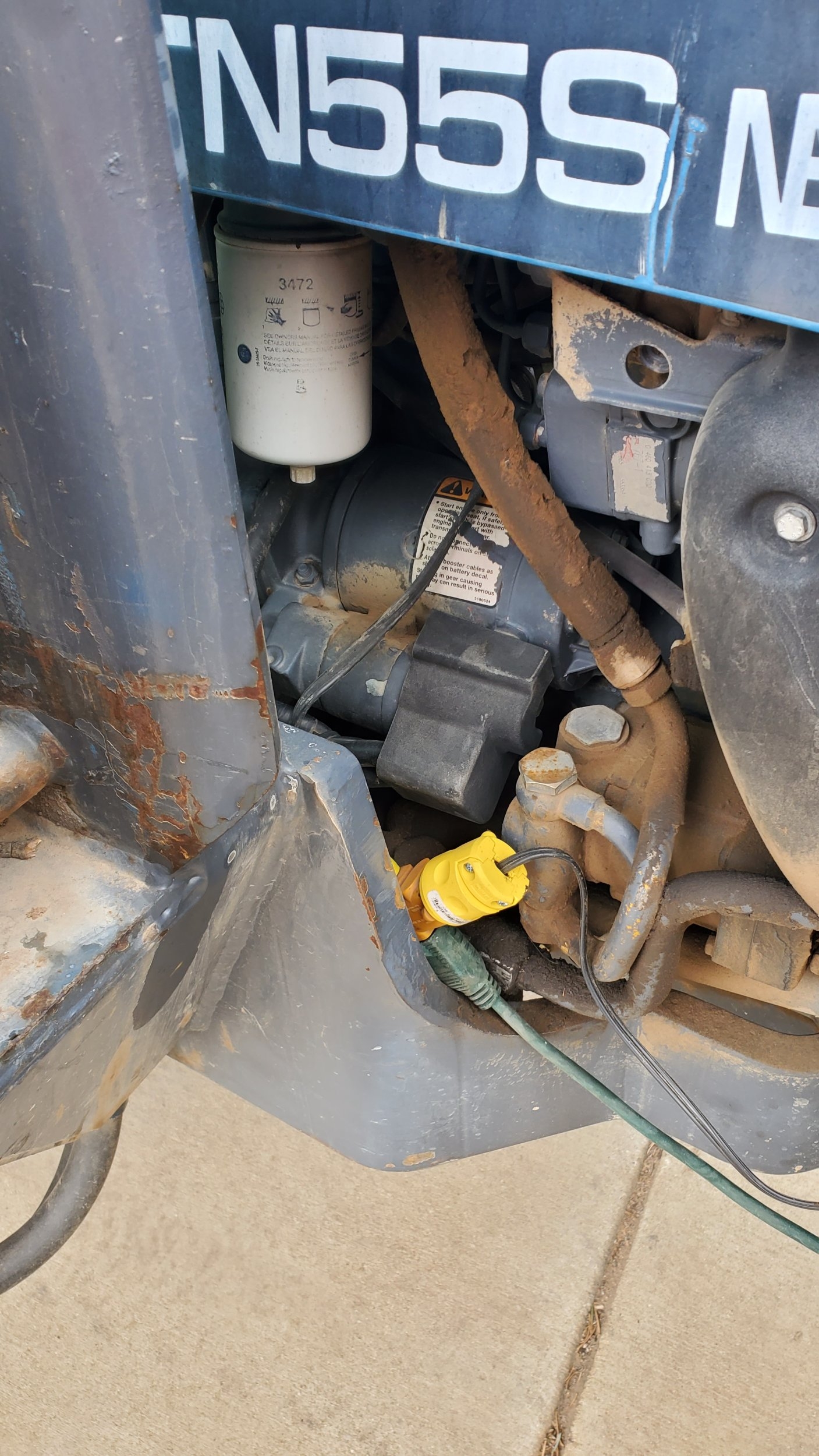

Hello Folks, the starter/solenoid appears to be dieing. It sounds like a box of rocks (vs the solenoid just skipping in and out -- not a gear meshing sound to me). Intermittent while cranking.
Looking at the repair manual and at the starter (I haven't pulled the plastic wire cover/cap yet) it looks like the hydraulic pump has to be removed to get the starter out. This is a 1998 with the first gen loader brackets (S model is supposed to have the higher output pump too).
Anyone able to comment on the removal process? I can see the 2 top flange bolts, I can't see if the 3rd one is at the end of the motor or if I would have access to it at the flange (not a lot of room in there). I'll likely pop the plastic cover off this afternoon. Of course we have a good sized snow storm on its way.

Well, gave it the delco-remy tune up: smacked it with a hammer. Working for now, but this week is warming up enough to change it.
Looks ugly. The hydraulic pump almost touched it & the fuel filter is right above it, loader mount next to it.

Should be the same starter for a bunch of Case and New Holland models, including: tn55, tn60, tn65, tn70, tn75.

Finally found the time and weather to get this done. Starter, 3 point lift pivot arm ('flex shaft'), and miscellaneous filters. Still to put the loader bracket on, but I'm calling it a win.
