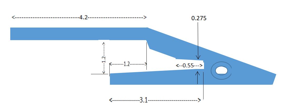

This is the profile of the piece which slips over the bucket edge. Click the attachment to expand. All dimensions are in inches.

/ titan toothbar kit #5
See if this works. I hate attachments on this site.

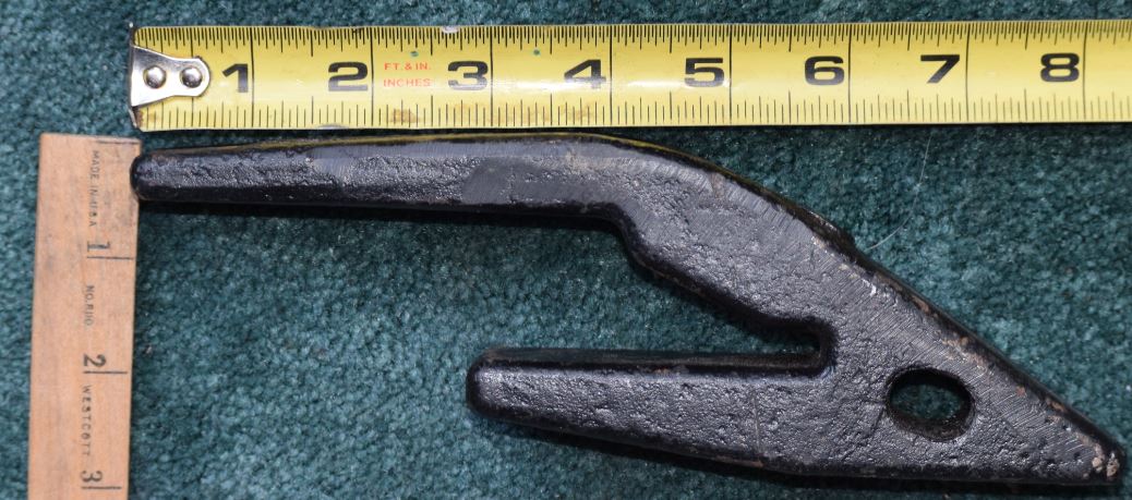

/ titan toothbar kit #7
Yes. I am nearly certain it is exactly what you are looking at buying. I bought one from Titan and did not use one of the tooth mounts. Better image attached. You could scale it to print out so it matches the tape measure and make a wood replica to test fit.
thanks again otiski, that's exactly what I'm looking for. You've been very helpful.
/ titan toothbar kit #9
Cool. Good luck Chuck.
