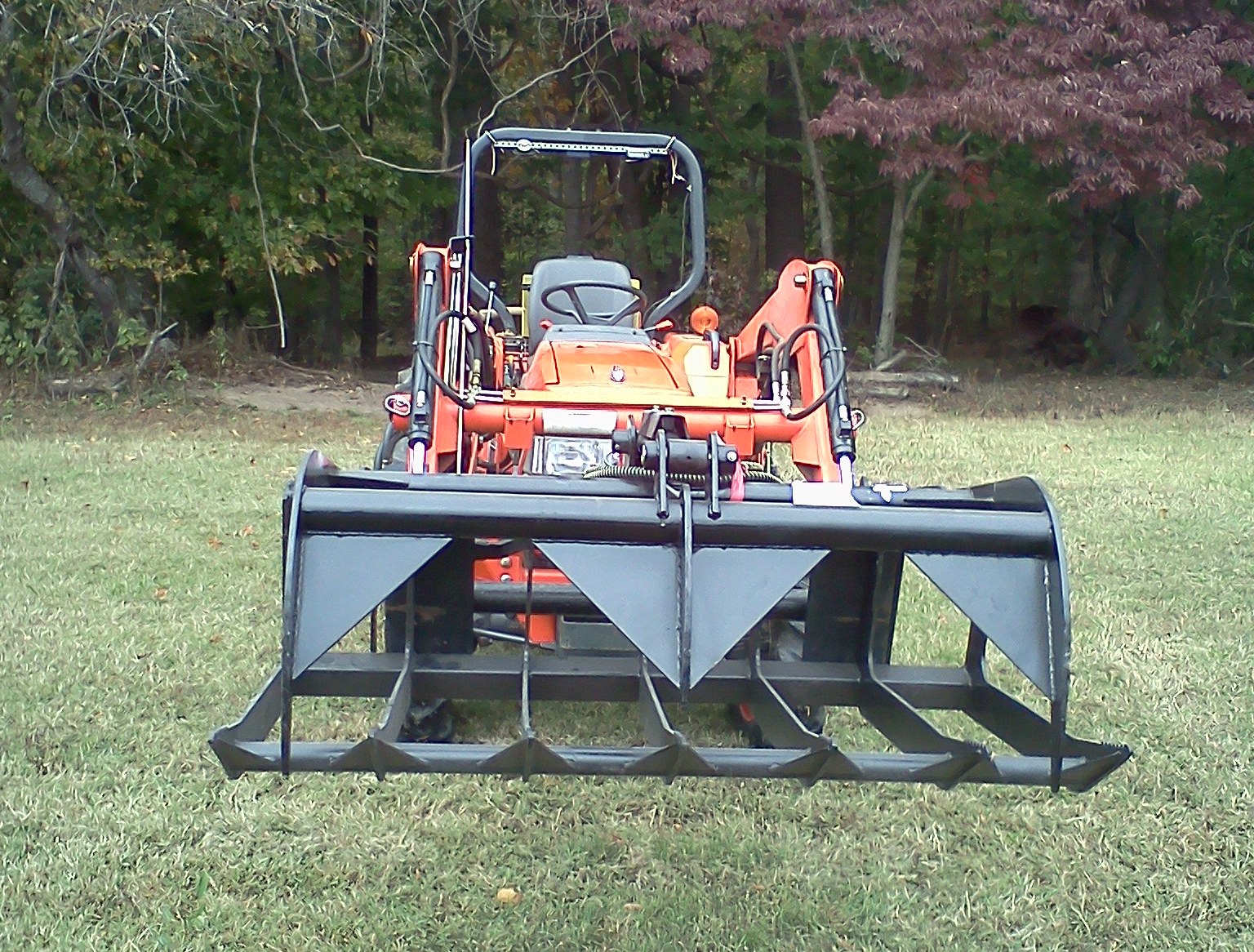

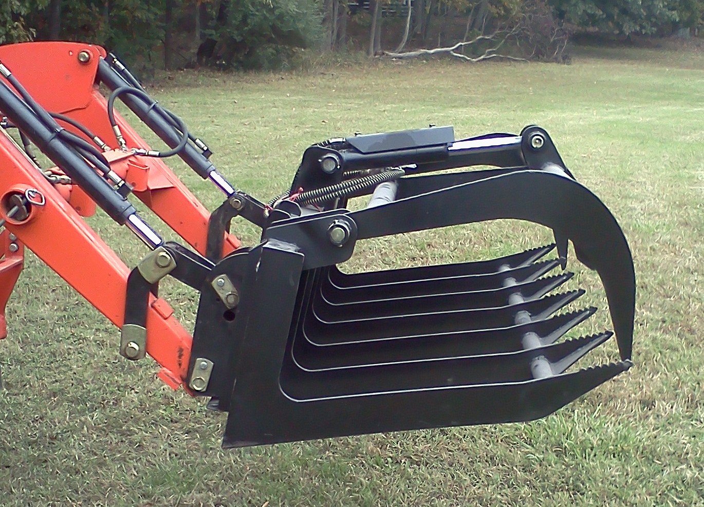

Here are some photos on the tractor:

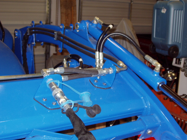

Another thing that is killing me is that I haven't plumbed in the hydraulic lines from the rear remotes. I wanted to get it on the tractor so I could see what all I needed. Here is a picture of the front hydraulic ports on my Woods loader
The grapple came with 1/2" flat face couplers so I will have to change either the couplers on the grapple or the couplers on the tractor. Those 1/2" flat face couplers are massive and I'm worried about all of that weight hanging on the hard lines. The hoses that came on the grapple are over 7 feet long. With it tilted all the way down I only need 5 feet of hose.
Here are my questions:
Should I mount the couplers to a bracket on the cross member and run hoses to the hard lines?
Is two extra feet of hose going to get in the way? Should I get shorter hoses?
Thanks

There's another thread on here somewhere in which someone suggests that it's better if the hoses are loose rather than attached to a bracket. As far as the hose length goes, just get your hoses to the rear remotes made to a proper length to connect to your front hoses.
When I recently measured for the rear hoses, my dealer made the (good) suggestion that rather than using just a tape measure, thread a water hose where the hydraulic hoses will be, mark it, then measure the water hose to the mark.
/ Titan Grapple - It's killing me #10
When I plumbed my grapple, I left the SS flat-face couplers in place because I wanted to be compatible with other SS hydraulic implements (someday I hope to have a hydraulic auger). In your case, since the hard-plumbed outlets on the FEL arms are already Pioneer(?) fittings, I'm guessing it would be easier to replace the ones on the grapple...and you could slightly shorten the hoses at the same time; just be sure that nowhere in the range of motion can the hoses be pulled tight.

It is unusual to have extra remotes hard plumbed to the FEL. That said, it looks nice. Is this set up to a diverter valve or electric over hydraulic?
Regarding how to hook up to the grapple, I'd base that on how much it costs. I'd also just connect the line directly from the grapple to your hard plumbed port without setting up another hydraulic fitting on the torque tube. No reason to have an intermediate line. Probably cheapest solution is to take off the whole hose system that come with the grapple. Instead get two approx. 6 foot lengths of 3/8 inch hose with the appropriate SAE or JIC connector on the hydraulic cylinder side and then put male Pioneer fittings on the tractor side. You will need to have enough line to allow full dump but not so much that you have loose line flopping about and in danger of snagging. What I do is to wrap a bungee cord around the middle of the line from the grapple and attach it to the torque tube. That puts just a tad of tension on the line and keeps it out of harms way. If you want to be fancy then instead of wrapping the bungee, install a two line clamp in the middle of the cylinder to tractor lines and attach the bungee there. Weld or bolt a small fitting on the torque tube to accept the other end of the bungee.

"It is unusual to have extra remotes hard plumbed to the FEL. That said, it looks nice. Is this set up to a diverter valve or electric over hydraulic?"
Neither, I ordered the front remote kit shortly after I got the loader so I would have it on hand when I got a grapple. I just installed the hard lines last night. The plan is to connect them to my rear remotes and put disconnects in the middle near the loader lift and curl disconnects.

With a starting place on the hydraulic system established pre-measure the hose run long and adding another foot, go to your hydraulic shop and buy the hoses with only the upstream fitting attached, take them home, insert up stream fitting, temp strap the hoses where you want them, mark and take back for the down stream fitting. You must have the next downstream terminal pre-installed to do it this way. I did this on each run and although it took more time several trips to the shop, it worked ou well.
As far as how many sets of QCs to use, take in to consideration at least the grapple and FEL removal.
I would. All that weight cantilevered that far out will fatigue the tubing eventually. Also, sometimes (most times) you have to push really hard to connect the couplers, especially flat-faced ones. Keep that in mind when you determine the spacing between couplers on your bracket. If they're too close, you can't get a good grip on the second one when you connect it.

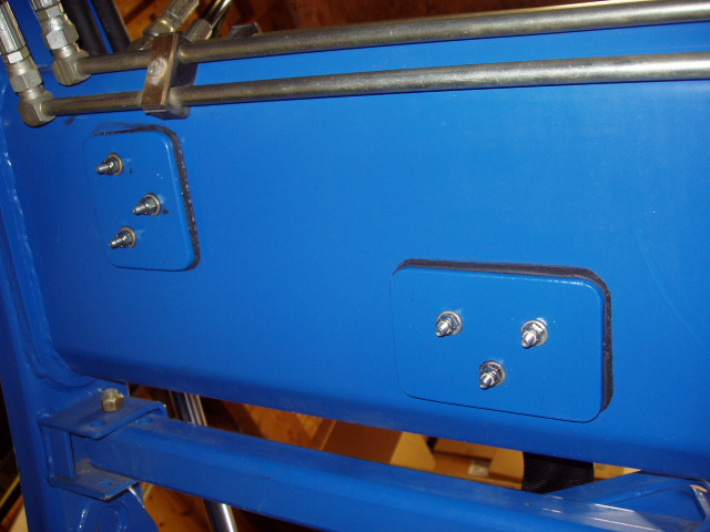

Here is a picture of the other end of the hard lines. As you can see, the ones with the red plugs don't have anything connected. That's why I'm asking for advice. I take you point about single hoses running from the hard line directly to the rear remotes. I don't remove the loader all that often so I'll take you're advice and do it that way. I'll just make sure it's clamped in a way that's easy to remove when I need to remove the loader.
Next question: Do I need to bleed the air out of the lines and cylinder after I get everything connected?
Thanks again

/ Titan Grapple - It's killing me #20
No need to bleed air. Just check hydraulic fluid level after you have cycled the loader a few times. You probably won't even notice the difference.
