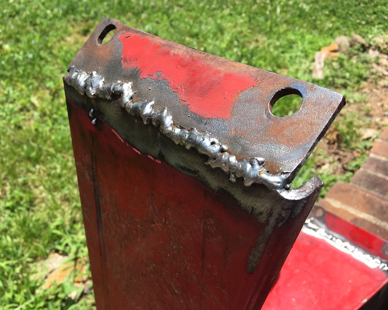

I had a friend of mine weld the broken mount edges back on. Have not had a chance to mount and test. I am painting it first.
I think welding the broken edges back on won't be enough. On mine, I bought plate steel in similar thickness to the support towers, cut it to fit inside, heated it with a torch, and bent it to match. Then I welded the plate to the towers on both sides, along with welding the broken mounting edges to themselves and the plate.

I agree, but this was a quick, free weld and he didn't want to do more. I have another source that will be able to improve on it. I am thinking of a simple bridge between the angle to make it a triangle of sorts, probably using 1/4 steel.
Sorry Guidshir that's about what the weld is worth . . .:eek:

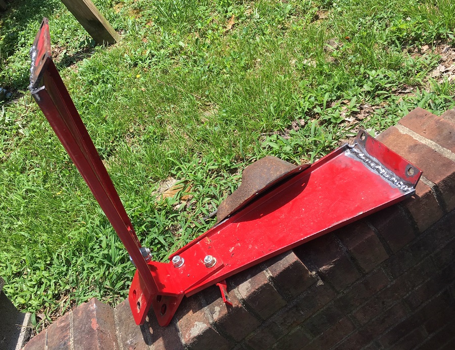

I don't have a picture, but I have a different friend with some scrap metal and he welded some braces on and gave me a 5 minute lesson in welding to boot. After welding we pried on it a little with another scrap piece and I think it will be stronger than before. Strong enough? Only time will tell.

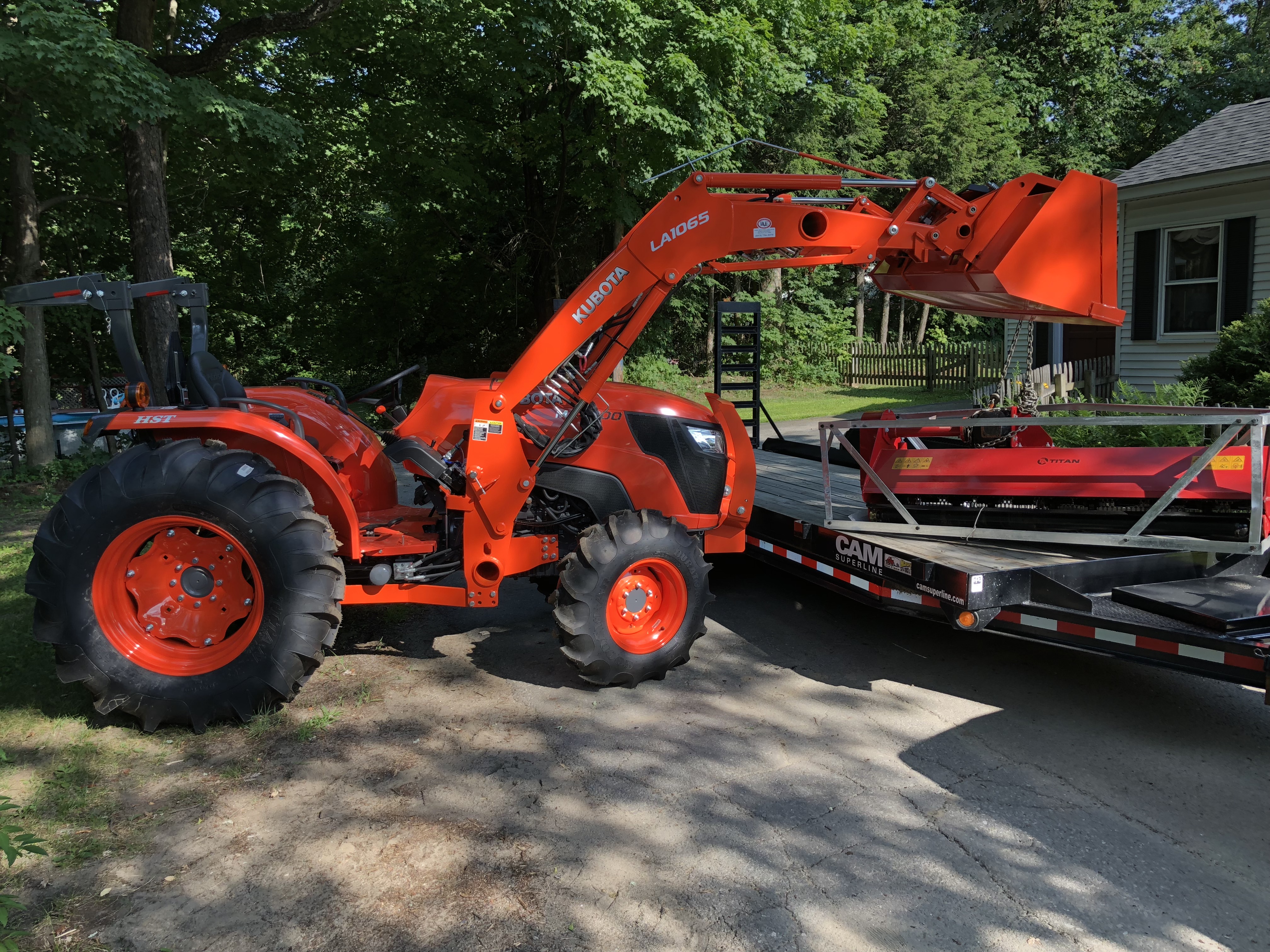

My Titan flail has been sitting awaiting new top link brackets. They arrived and I installed them today allowing further assessment of the original top link brackets that were just beginning to show cracks in the paint at the lower bends. I torqued the new brackets dry to 70 ft. lb. using the new hardware provided with the new brackets.
Next, I attempted to fit my quick Hitch to the Titan. The Titan lower Cat1 points are too close together to allow engagement and the top link design on the Titan would not allow hook engagement. Boy, that mower is a struggle to get connected to my M-F 231 but, the M-F doesn’t even know its back there.
If I replace the Titan, I’ll make sure the new mower is QH compatible. I have been looking at Woodmaxx flail mowers. I’m inclined to discount the Italian mowers due to cost and some belt issues.
I thoroughly greased both the tractor and mower, checked the belts (they are original and looked new and snug), then ran out of grease in my gun, installed a new grease cartridge and finished greasing everything….Pheeeew.
Just before dinner, I took the rig out and did a short mow of my 2 foot high field…no runs, no hits, no errors, no vibration. All is well so, tomorrow I’ll cut the whole orchard after insuring the beer fridge in the garage is well stocked with Yuengling.
After mowing the orchard, I’ve got to decide whether to rebuild my almost new Craftsman 30cc 4-cycle weed eater or buy another. The Craftsman engine is very rugged and ran fine. However, the recoil starting design is junk and Craftsman wants me to buy the whole engine to repair the defective starting system. I think I’ll pass. The item is under warranty and they don’t want to repair it so, they refunded my money. Terrific warranty policy so, I think I’ll buy another Craftsman weed eater…does that sound crazy?
Wish me luck tomorrow when I’ll be mowing and imbibing (in the correct order, of course). Greetings from Dixieland. Roll Tide.
