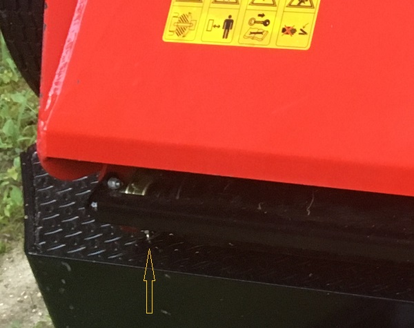

I used my 60" Titan flail today. I think this is the 6th usage of it, maybe 7th. I mowed about 6 acres and noticed that the base of the top/middle 3-point connection was broken off on both sides.
The design is what looks like 1/8" steel bolted. Each side is it's own piece and I had to assemble when I bought this last year. The two sides bolt to the mower and to a top piece where the top 3-pt tractor connector attaches.
I didn't even know when it broke until I looked back and saw it. The mower works otherwise, so I will probably find someone to weld these back and strengthen it. But still, it's pretty bad that it broke like this.
If your mower is <1yr old you can probably get replacement parts shipped to you under warranty at no cost. I have contacted Titan on a few occasions and their customer service is extremely helpful and responsive.

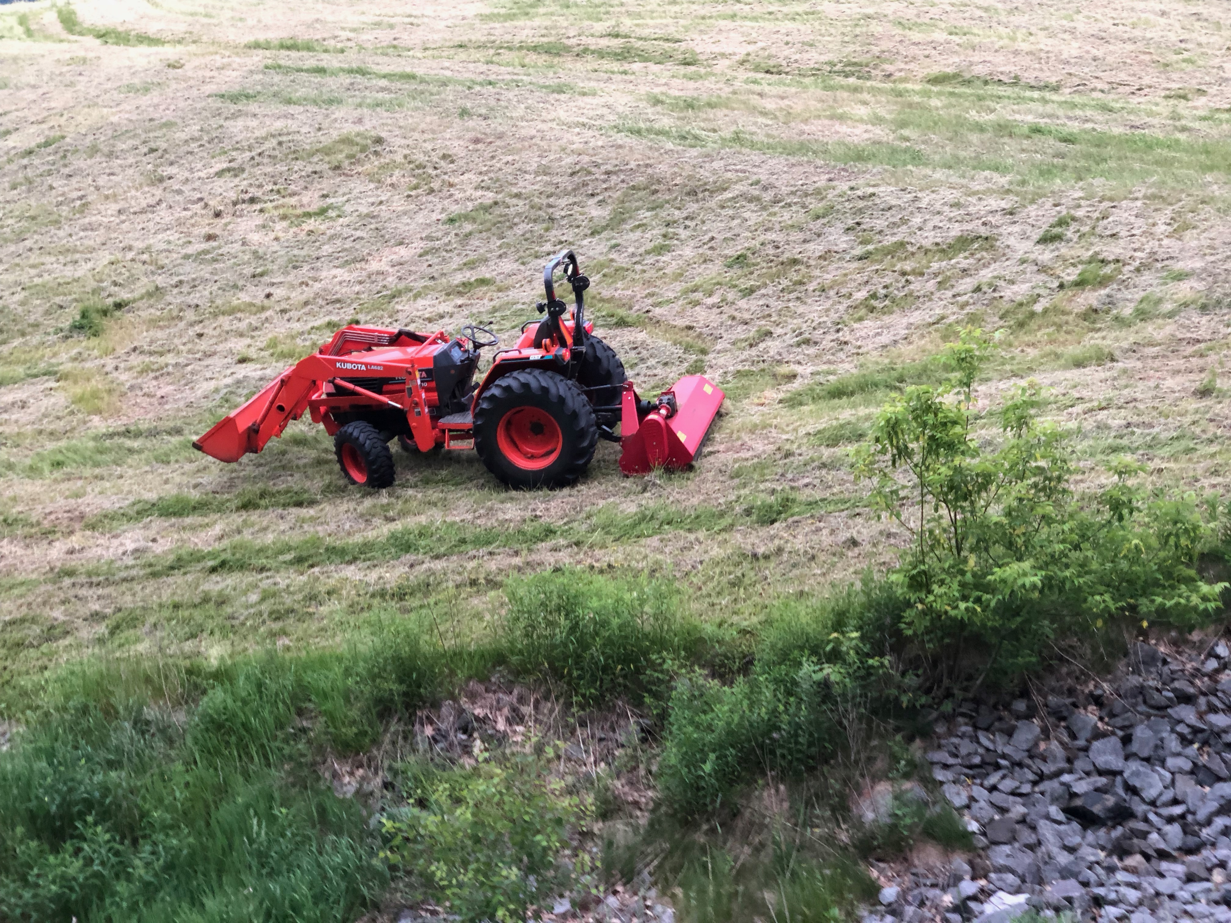

You guys are making me really worry about my recent purchase, I wish I would have seen this sooner! I purchased this less than a month ago and I have used it several times on my very steep and rocky property. I have hit a few big hidden rocks and cleared brush that was for sure pushing the 3" diameter mark, I have not damaged anything yet (that I know of) aside from a few chipped knives, but it looks like I need to be careful. On the hills that I am working on, I have accidentally jammed the mower into the ground on the downhill side a few times as the tractor started up another hill or off angle, the housing does not seem bent. Mostly when this happens it is the piece of metal that holds on the rear roller that digs in. I do think that Titan has changed their design somewhat because mine was delivered with the grease fittings for the rear roller on the outside of the housing, on the sides of the mower.
I may add a few pieces of 2x2x1/4 angle across the housing just in case to try to keep it from bending, but what are you guys doing about the 3-point top link supports breaking? Does anyone have pictures that they could share?

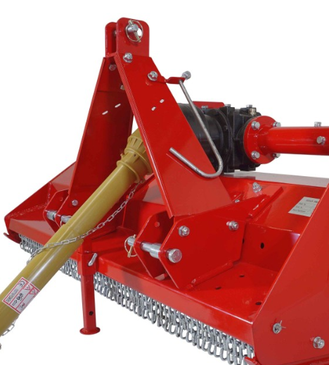

thekkfan, I had to do the same thing on my mower, I am not sure if he had the same problem as I did but on mine the formed angles on the brackets did not allow me to get the bolts in for any other position even thought the manual shows it as you are suggesting.
This is from the titan site. I only say this because my BETSTCO had the same assembly and I had no trouble assembling the way I described. I wondered if that issue stressed the folds, especially if there was any side to side movement (ie. smacked side of a tree, etc).

Hello hawk10,
The weldment with the tab weldments goes on the outside and you can reinforce it with a piece of flat stock ONLY IF you have the clearance so that the knives do not impact the nuts and the flat stock that is bolted to the inside.

Yeah, I am sure the knives hitting the nuts on the inside would make for a bad day! I had that backwards, I thought we were talking about putting the reinforcement on the inside of the mower. I am probably going to draw it in Solidworks so that I can be sure of everything before modifying it, I can check for clearance in the model. Now all that I have to do is find the time to work on it! Thank you for the feedback! :)
