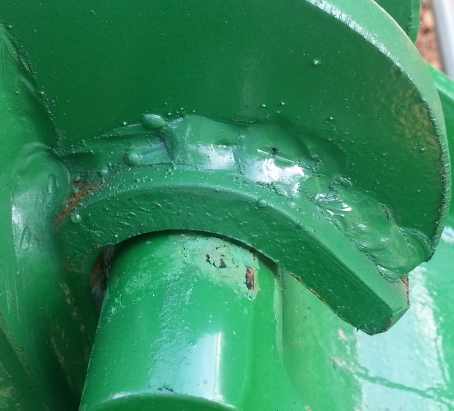

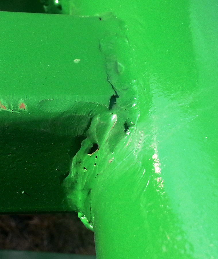

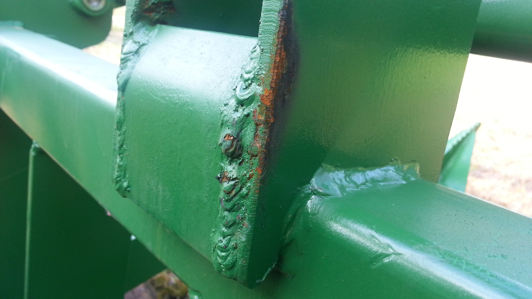

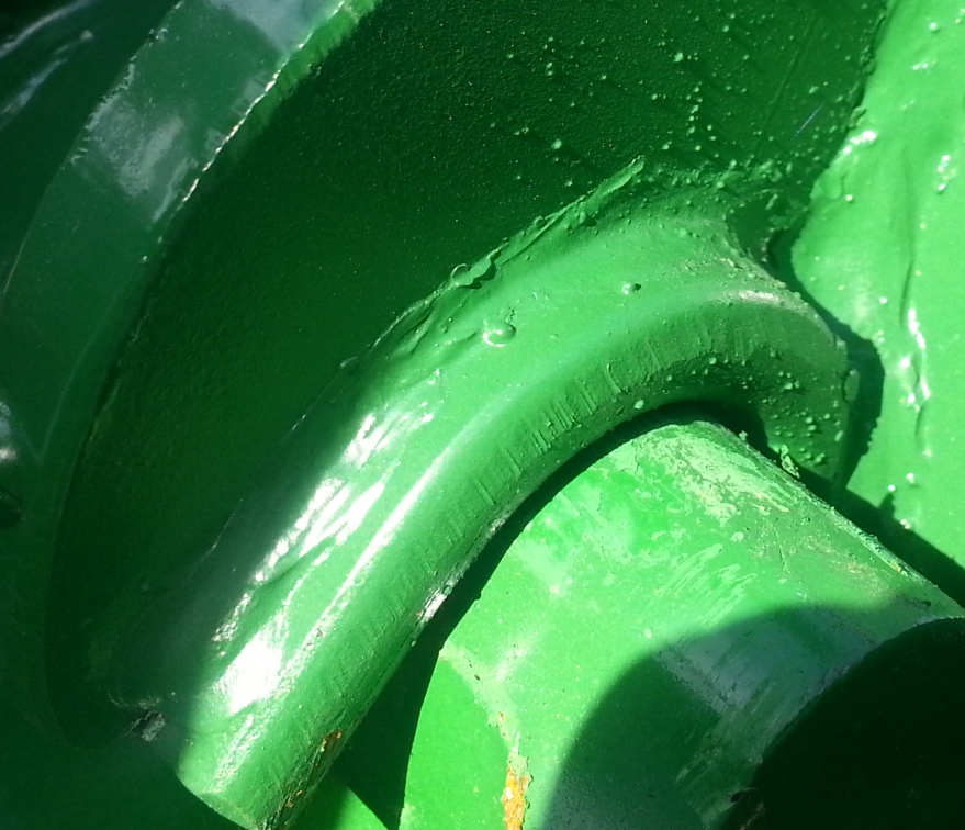

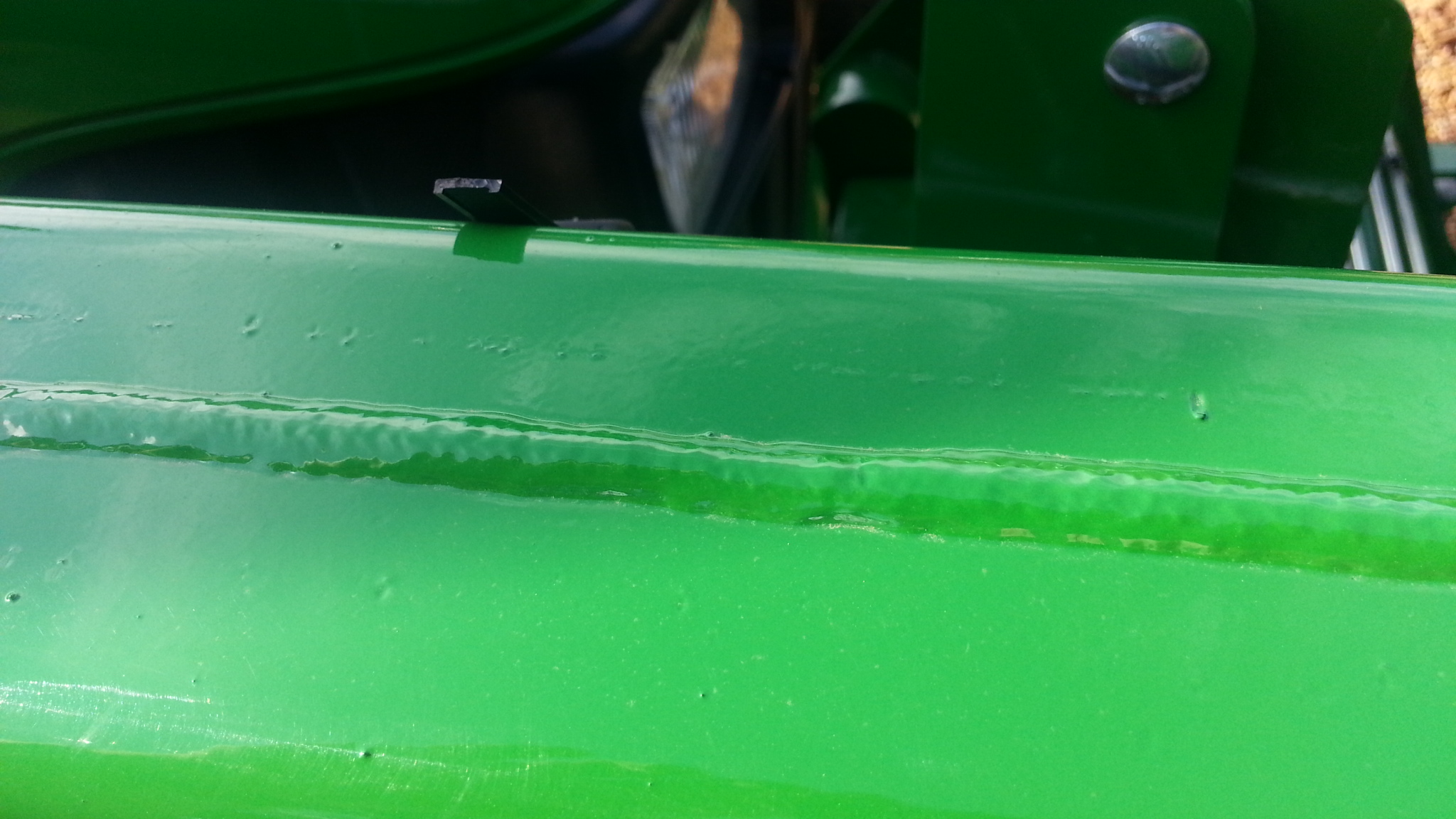

As previously stated, the welds are not very good and I hope they hold. It appears they were in a hurry because of high product demand and simply went way too fast when welding. I will take pictures and post them sometime this weekend.
   / Titan Attachments Experience #82
Here are some pics. The good looking weld on the right is a factory weld on a JD 553 loader for comparison purposes.

Yes, you identified the nice weld. It's what I like to call a normal weld......

The first one isn't really that bad... all cheap implement manufacturer welds look like that. I have a few on my KKs that wish they were that nice.
The second pic is awful. I think not only is the weld bad, but that was probably a result of fit up issues as well.
I'm somewhat surprised that the loader arms aren't robotically-welded on the JD loader.
