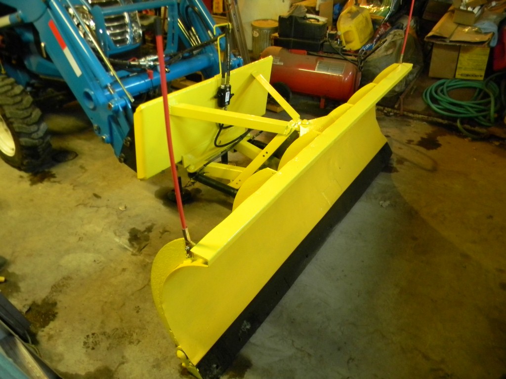

I bought their 1/2" plate and adapted it to a 7.5' truck plow for my tractor. The 5/16" would probably have been strong enough but I wanted overkill. There is a thread on my plow build.
Snow Plow Build - Page 3

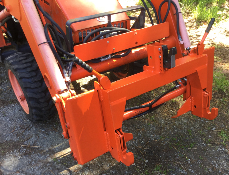

I used a 5/16" Titan plate for this ssqa-to-3pt adapter. No issues.

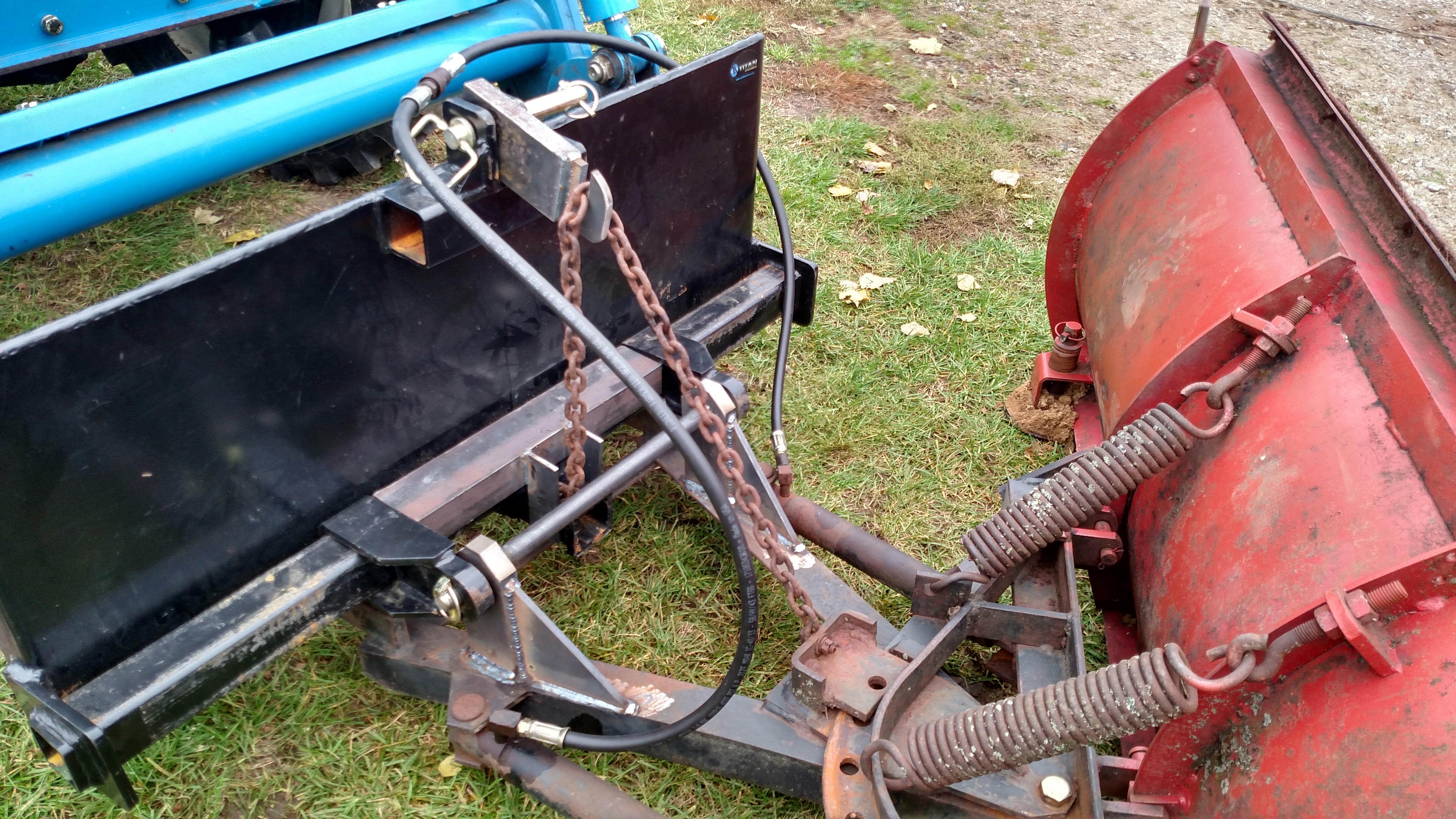

I used a titan quick attach with a 3 pt adapter to attach plow and still able to use just the three point adapter
/ Titan Attachments 5/16 quick attach plate #11
I built my plow attachment basically the same way. Random SSQA plate (large hole punched in it rather than a solid plate. Just welded a cheap used 3pt QH to it.
