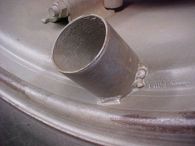

My property is a jungle. It is rough nasty terrain. Lots of sticks limbs and stuff that either pops off valve stems, jams into rim seals and causes leaks or the worst, punctures sidewalls (I have never punctured a tire in a "normal through the tread fashion).
Also most of my rims are in tough shape.
I have converted all my rims to metal stems. But now due to a couple of side wall punctures I am going to have to tube some tires. The previous results have been bad. Valve stems completely ripped off and have to replace the tube.
Now I have a crazy idea. What if I were to weld "guards" around the tube valve stems. Like a 1" piece of pipe. Just long enough to go past the stem. Close enough to service. It would have to be notched and stuff. Not an easy peasy process but... Then maybe throw in some of my gemplers stuff that I have been sitting on for more than a year.
I have spent so much converting to metal valve stems this solution sucks but.
Anyway, wanting to get your guys thoughts on this... No sense throwing good money after bad...

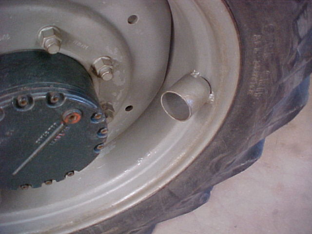

MVC-026F.JPGWe've found guards to be the anwer to broken valve stems. We use our tractors close to vine rows and used to have the stems broken too regularly.
We use steel tube of about 2" OD welded on in three little spots where the square cut end touches the rim. (see photos)
From memory we even managed to do the small welds without removing the water filled tube (and tyre) from the rim.
For damaged tubes it's possible (in Australia anyway) to buy glue on valve stems and they work. I think the stems and adhesive were made by Rema?
Regards Allen

Exactly what I am looking to do. Thank you for the pix. My only real issue is that the PT rims are the same size of a small cars tire... 12" thick (30cm) but not all that tall.
