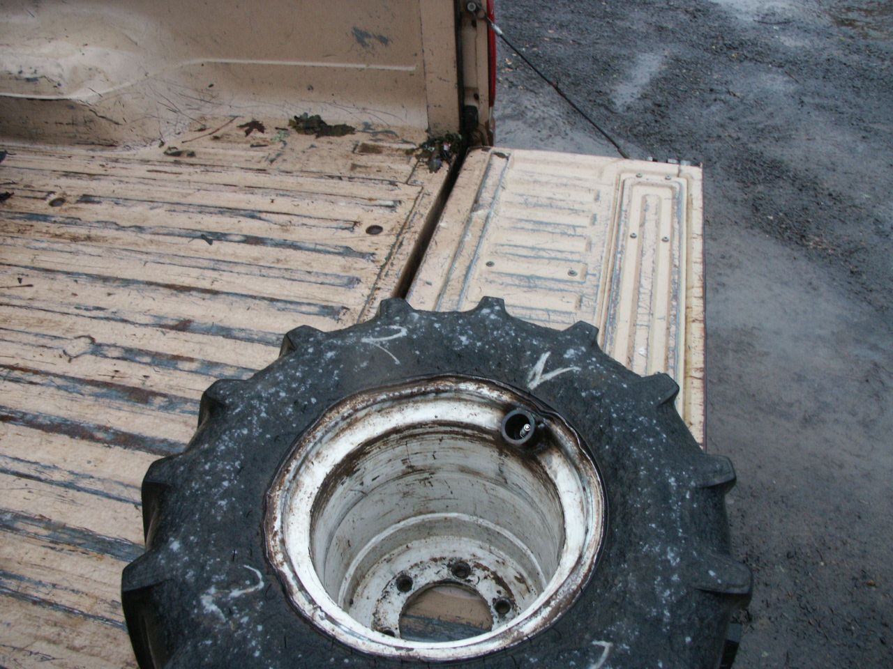

And finally, I had 3 of my tires tubed. My intent was to put in some Gemplers Super Junk that I have had sitting for nearly a year.
Well best laid plans.. The caps were made up and welded on, based on my current tubed tires. Dropped them off at the same tire store and dangit, they used different tubes. These had short little stems, so they had to put stem extenders on, and they point in an entirely different direction. I complained to the shop manager but he said this was all they would ever be getting in.
Grumble... Grumble.. Grumble... Now I have to figure out Plan B. How to get gemplers down these friggin pie holes..
Carl

Carl, How in the heck did you beat that rim up so badly? I can see where it wouldn't hold air without a tube.
   / Tires, Rims and Tubes.
#15
Rims were used to begin with and pretty thrashed. But, between the 1" canes on the blackberries, and the 3" alders, everything gets beaten up all that much more.

Carl.
Did you get the Gemplers to go in the tires? If not, this is what I do. Remove the valve core, and compress the tire ,and put a tube over the valve stem. and to the bottle of Gemplers. When you let up on the compression, vacuum in the tire will help to suck in the Gompers .
If it is a tube, you might have to heat it a little and squirt it in.

Good idea. I got the bottle and was wondering how I was going to get it in...
Actually, I got the 5 gallon jug... 10 tires, 1/2 gallon per...
Glad you guys like the rims. Was going to chrome them but will wait until next year...
