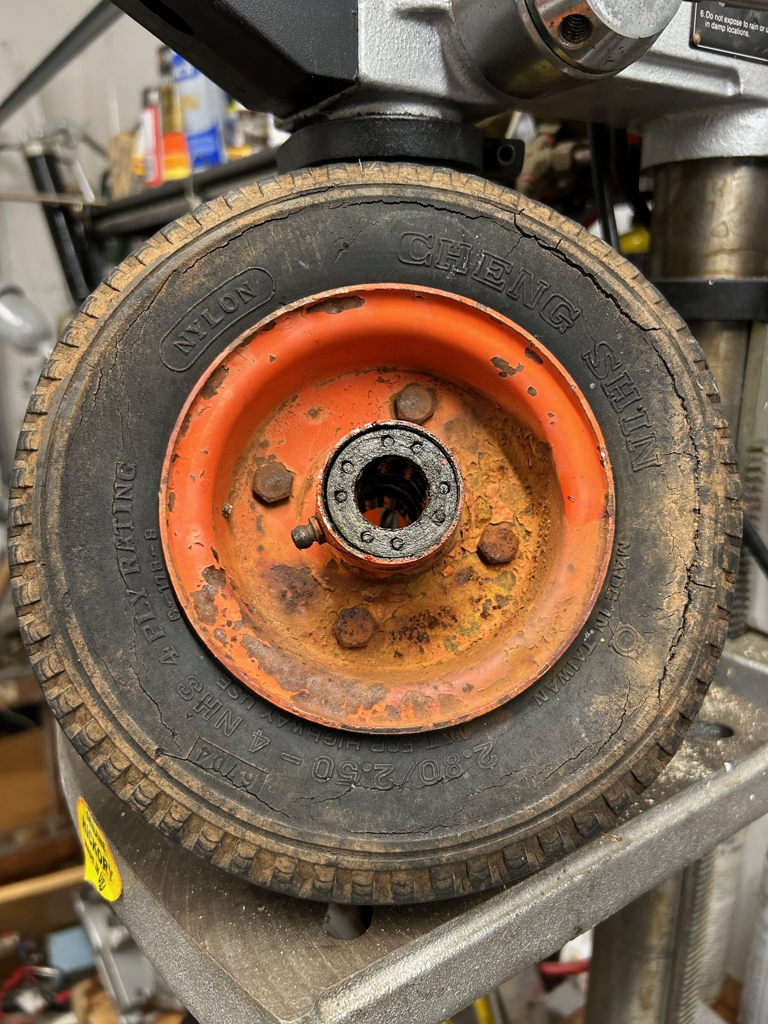

What are folks using to successfully replace the original tires on these mower decks? I have tried replacing one with new chinese tire and tube, and it failed after a few hours use. Photo attached of an (I believe) original tire. Size is 2.80/2.50-4. Outer diameter is roughly 8 inches.

Those look like basically hand truck or wheel borrow tires... Would think some "flat free" tires/wheel may be appropriate...

I ended up switching to a solid rubber tire from a local hardware store, and it’s been holding up great. You lose the air cushioning, but no more flats.

I have looked, and the only tires I am finding are tail wheel tires for small aircraft. No way to tell where they are made, but they are about $80.00 each. At $80.00 each, I would like some assurance they are robust and can be used reliably in this application. Whatever the case, components certified for aircraft use always come development and liability costs included in the price tag.
The original Kubota tires were made in Taiwan and lasted decades.
Is there another source?
Russ
Good thoughts. Did you find tires only or did they come formed on the non-split rims? I bought some like this on Amazon but upon inspection, doubt the rims will take the punishment. Will try them.

I'll take either one. Pneumatic tires as originally fitted would be fine. However, a solid-rubber tire that would fit the Kubota split rim might be fine. The bearings in the stock Kubota wheel are wide roller bearings and spread the load very well. New wheels seem to come fitted with cheap ball bearings.
