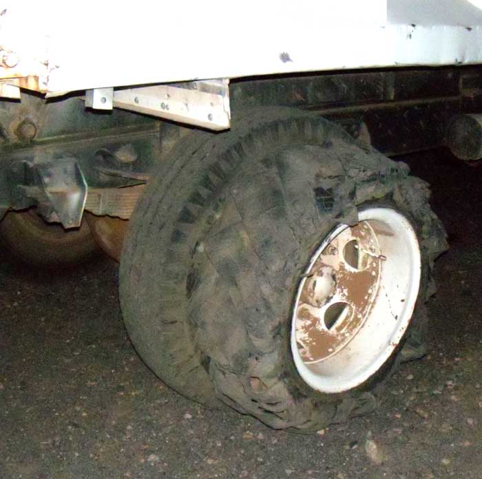

I have a little problem with this tire. The tread sort of fell off and I think the tube leaks.
Maybe a patch and some super glue to put the tread back on??

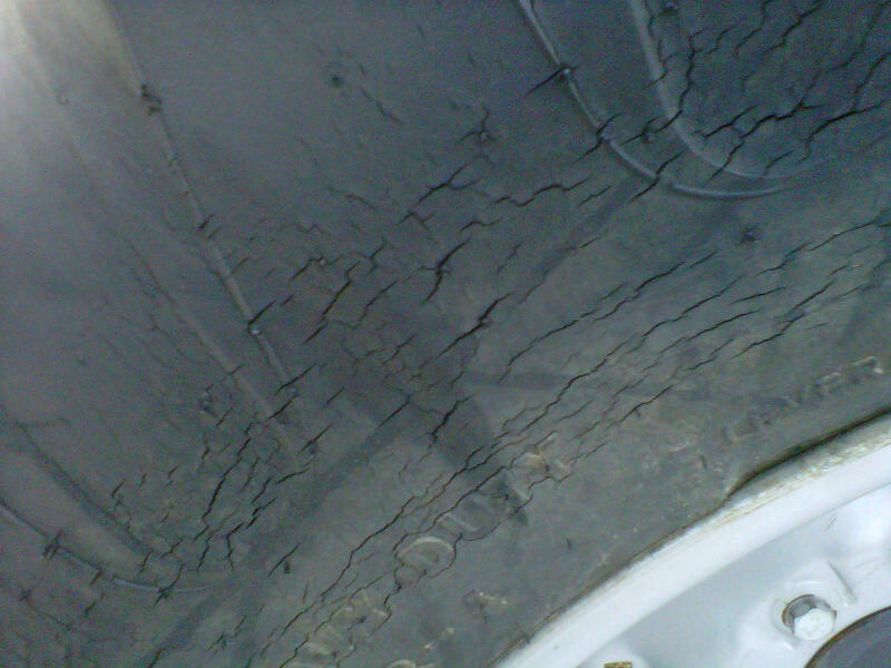

Here is a photo of the sidewall. This is typical on both rear tires.View attachment 202553
Yep rider thats one of the issues with the Titans. The picture that rd_macgregor posted is another one of the issues. Titan never told me what they thought caused the problem but they know about it.

Crash...uh.....did you choose your name before or after taking that photo:laughing:
I would agree, there are just a few cracks in that tire:D
/ Tire side wall cracks? #48
Do you work for Titan, cause that sounds like the company line. These tires absolutly s#ck. It is a problem that Titan knows about and does nothing to fix. They had an extremely bad batch of tires and do nothing for the customers that have them. The cracks are not from inflation issues or overloading. Believe me I have been thru THREE sets of these pieces of trash.
Gee, sorry I hit an obvious sore point with you. I was just sharing the fact that one of a pair of new tires looked EXACTLY like the one in the photo and the other one was fine. This was due to underinflation.
As for being a company man, you should have taken the time to look at my past posts and you would have seen this is my only reference to tire :rolleyes:
