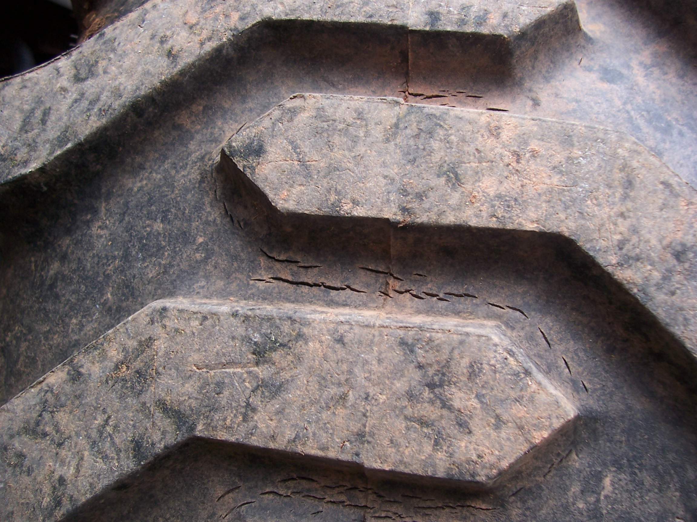

My Kioti DK45 has Titan R4s front and rear. The first winter I had it, I noticed cracks in the front treads...the rears are fine. The dealer seemed to think it was just cosmetic, but I've documented it just in case it is a more serious issue. I've attached a close-up of the front tread to show what I'm talking about.
BOB
That looks a lot like a tire that was underinflated and/or a lot of heavy loader work. Had a replacement rear tire on my tlb do the same thing within a year. Normal sunlight or uv cracks usually start around the sidewalls.
Or just a bad batch of what they had on hand the day they made them :(

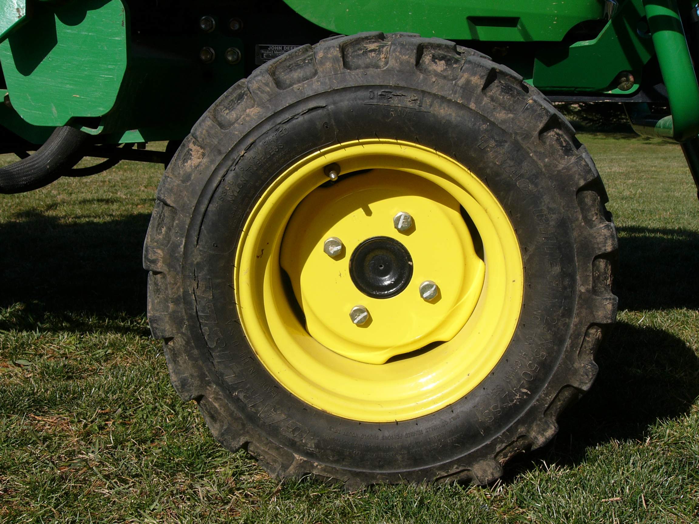

I have Carlisle on the front of my JD 2520 and am not very happy with the condition of their sidewall.
