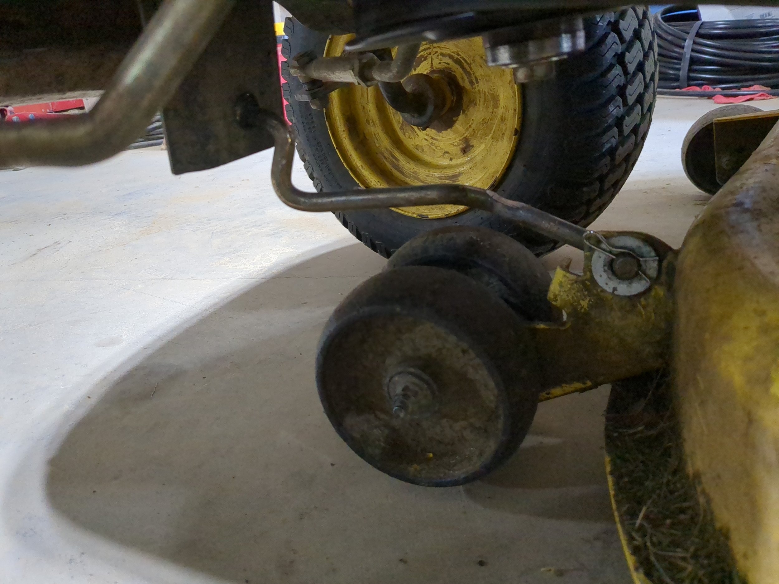

I have a JD mower with a 54" mower deck. I bought it used from a guy who should throw their tools away. I can't understand why the mower deck sets at an angle under the frame. Plenty of clearance between left tire but right tire rubs on deck. Further, nothing I do prevents the front deck wheels from riding on the ground. I followed the JD instructions but the front hanger adjustment makes no difference. Also, the right front sets higher than the left. With the wheels off, the deck sets level on the floor so I assume the deck is not bent. I cannot confirm this mower came with this deck but it was at least an option.
Any suggestions?
thank you

190ca
The height of the deck is the same in the back but the right front is lower
I tweaked the mounting bar shown here a little so it would pull the deck to the left a little. That helped but some thing just isn't right.
Thanks for the help

Your deck is most likely not a JD deck if you can't adjust with the hangers. Its something the prior owner probably cobbled together with a deck from another brand. This will be a tough one to sort out. Most all garden mowers, these days, use a single front, center deck, hanger mount. I think I'm seeing in your pic that the front hanger is attached to the left wheel side and not the center. Is there a center mounting point? If not, you may have to fabricate something. .

Is the second photo of the deck and the wheel the one that you say is rubbing ?
I see a pretty good wear mark on the rod going to the deck.

Yeah, item 24 really rubbed something hard to turn it blue from heat. Neighbor has that deck I think on one of their tractors.

Well, definitely the bracket for your front draft arm seems to be bent back, but that will mainly affect the pitch. Rear draft arms can get hogged out and rear lift brackets on the deck can get torn away. These are a lot of deck for that chassis. I'd pull the deck and look to see if the frame is cracked through at the transmission mounts and that the bracketry for that large u shaped lift arm are secure.

Not that wheel, but the one on the right that drags
The rod must have come off and rubbed on the mower pulley/clutch at some point.

Looking at neighbors jd, I'd have to say this is a JD deck. May or may not be original on this tractor.
It is a center Mount, picture may make it look likes it's not but it is
The deck seems to have a lot of "slop" in the attachments. I'll pull the deck and examine everything.

Most likely that mower was run into a stump or something and the rod got bent. Or the mounting bracket. Personally I'd just buy a new rod for it and try that. They do bend. Especially those ones with pre bent areas on them. Makes them easier to bend even more when you run it into something.
