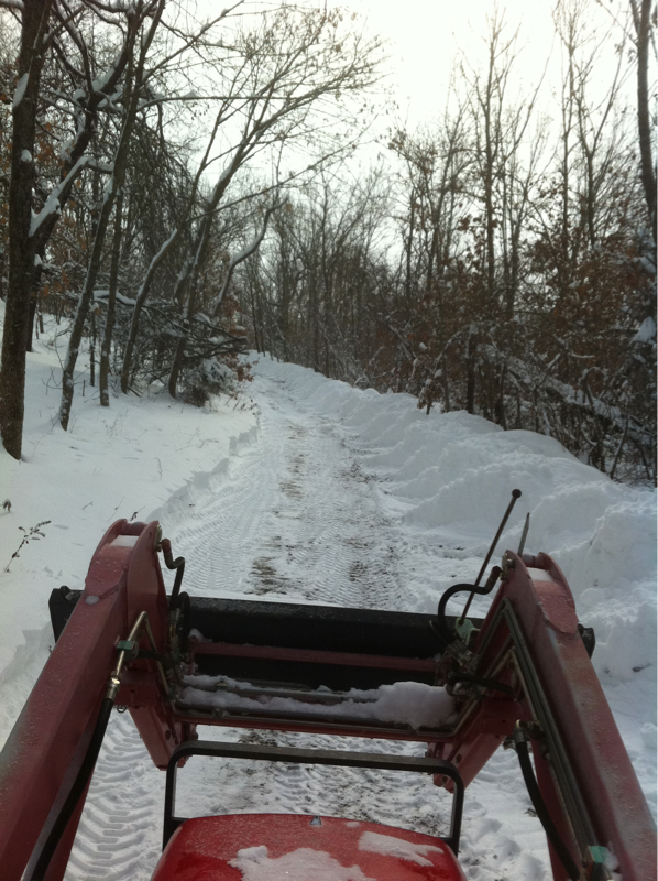

I finally received my tire chains. It is sunny and 70 here today and all the snow is melted. Oh well... I will be ready next time.
The picture is while I was clearing my drive last week... with no chains. 43" in 10 days up that hill was not fun.

Not fun when you have to spoon it out with just a bucket either. :)
But then, you get a lot of seat time.
