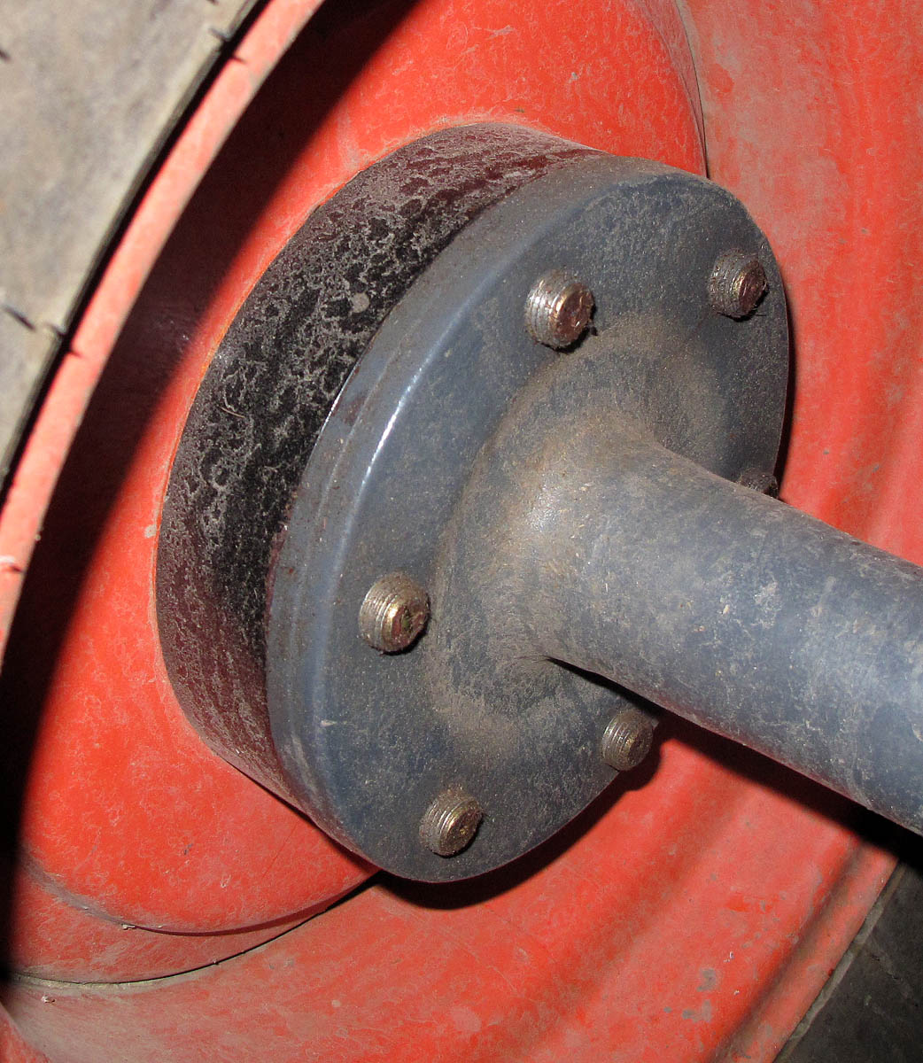

Anyone running chains/turfs on a b3030? I got the chains, now need the spacers. Any pics of the spacers? Anyone make their own or have a set made?
Local dealers can get them but $280 seems high. I have access to a shop with all the necessary equipment. interested in knowing how they attach.
Thanks.
Rob
/ tire chains #2
Ones I've seen are just cold roll steel whatever thickness you want to "space out" that bolt to the axle flange with recess for bolt heads. Then the spacer is drilled and tapped to accept the wheel bolts. Pretty simple if milling tools are available.
So bolt the spacer on in place of the present wheel rim, and bolt the present wheel rim to the spacers.

Here you go. A Kubota 1.5" wheel spacer on my B7800. I attached it with high grade bolts. I forgot what I payed for it but it was around $230. The manual that came with the spacers specified 150-170 lbs of torque and I stripped the thread on a lug and was very mad. The tractor manual (I checked too late and was fuming) specified 130 lbs or so. That worked better.

Thanks to all for the info. E-bay option looks promising although price is similar to Kubota's. Will check with the machine shop this week.
David- Wheel chains will not clear the rear inner fender on my B3030 with turf tires. There is only about an inch between the 2 in it's stock configuration. I need some type of spacer to set the rear wheels out in order to let the chains pass.
When connecting the wheels to the spacer would I use bolts or have studs attached to the spacers? Thinking ahead a bit about the weight of these loaded tires. Hanging the tires on studs might be easier.
Could I use standard thread or is metric recommended (I have better access to STD).

Easygo, I can see that might be a problem. As much as I hate to, I'll have to remove the spacers when installing the deck. The tires are loaded with "beat juice" (I forget the proper brand name but this is how the fluid was described to me) and as I just found out they are heavy!
Machinist friend is going to make the spacers for me. I simply traced the bolt pattern for him. Outside diameter will be 8", width 2". Spacer holes recessed .5" and 6 holes will be drilled and tapped to attached the wheels.
Can anyone tell me the thread size for the factory bolts? I will need 6 new ones 1.5" longer to attach the spacers. Will also need 4 new ones to replace the 2 studs on each wheel.

I will be able to post the proper thread size but I have to check on the box at home. I bought grade 8 if memory serves right.

The spacers are drilled through and supplied with studs. I put on two studs and 4 bolts per wheel.
I checked if I still have the bolt size but unfortunately I tossed the box. My guess is that it is metric thread.

Spacers are completed. Not exactly what I had in mind but they will be functional. Will post pics when a working camera is available.
I now need bolts. Does anyone know for certain what the size is? I am thinking they are M16 x 2mm but would like to be certain before ordering. I have heard that a 5/8 fine thread will work but would like to use the right size.

Thanks for the response. I found the size today with a machinist's help. Of coarse it is not a common one. 16mm x 1.5mm. Fastenal can get them locally for me, $4.45 each. I want to verify the length I need before ordering. 5/8th fine thread bolts are very close and I have a supply of them. Considering these will be removed season to season the proper size/thread is what I am opting for my set up.
