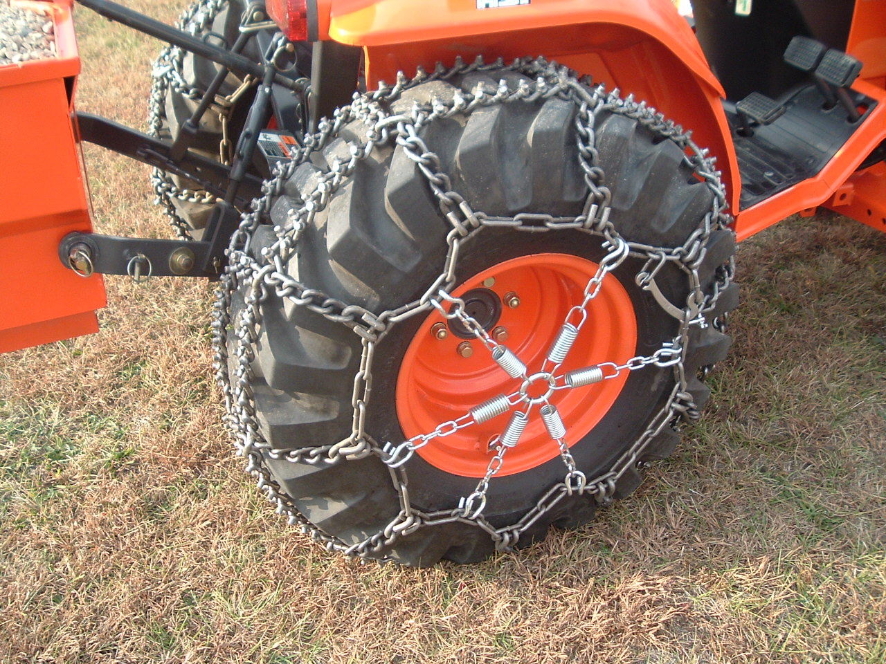

I bought these for $44.99 a pair. These are well made and very heavy duty. I used a nylon ratchet strap hooked to the top of the tire chain and center ring to tension the springs. I like 'em. tirechains
I tried them one time but they didn't hold up. Those 6" black rubbers with the 2 'S' hooks work the best for us. They're on the same shelf as the tarps as TSC.

I looked and your hooks are pointing in, you might want to turn them out as they could chew a nasty tear in the tire. Hope you do not mind the suggestion.
Craig Clayton
I appreciate the suggestion very much. They haven't gotten in to the tires yet but I can see where they could. I'll turn them around.
Craig Clayton
I think you're refering to Whistlepig's post #5 and, yes, those hooks need to be reversed.

I have chains that are similar. I think you and I have compared chains before. You have a much better fit up than I do. My side chains need to be shortened. Just haven't figured a good way to rejoin the chains after cutting the extra links out. Repair links I think is what they call them.

Whistlepig- That is a good looking set of chains. $$$$ Where did you get those?

As I recall I bent the hooks open, shortened the side chains, re-attached the hooks and squeezed them shut again. I had to cut out one or two of the center sections too. If you don't have room to get the levers in, you may have to put the hooks in two links apart on the side chains near the ends instead of three.
It looks like you have about the right amount of wrap around the sides of the tire, if the side chains were shorter you'd be fine I think.
