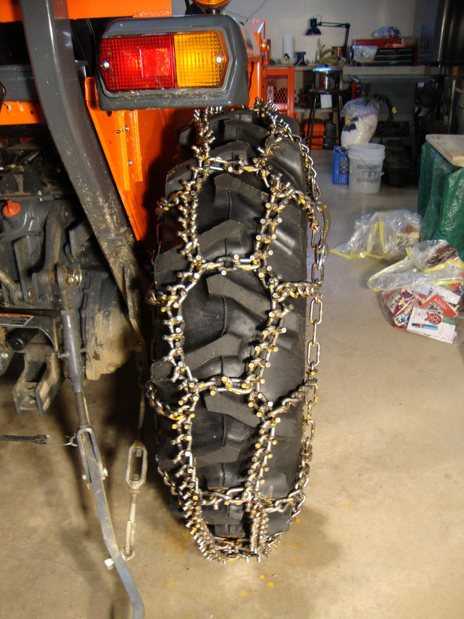

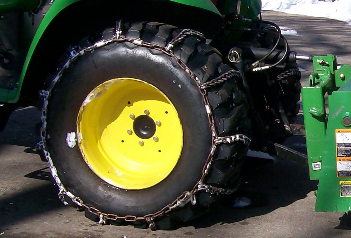

These have worked well for me. Made by Tellefsdal in Norway, also sold as Norse in Canada, and as Aquiline Talon in the US.
Sean

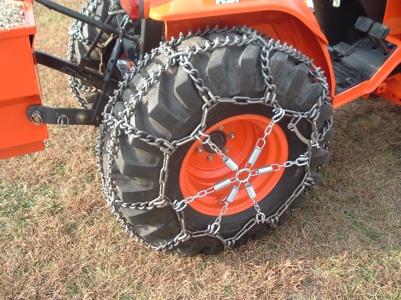

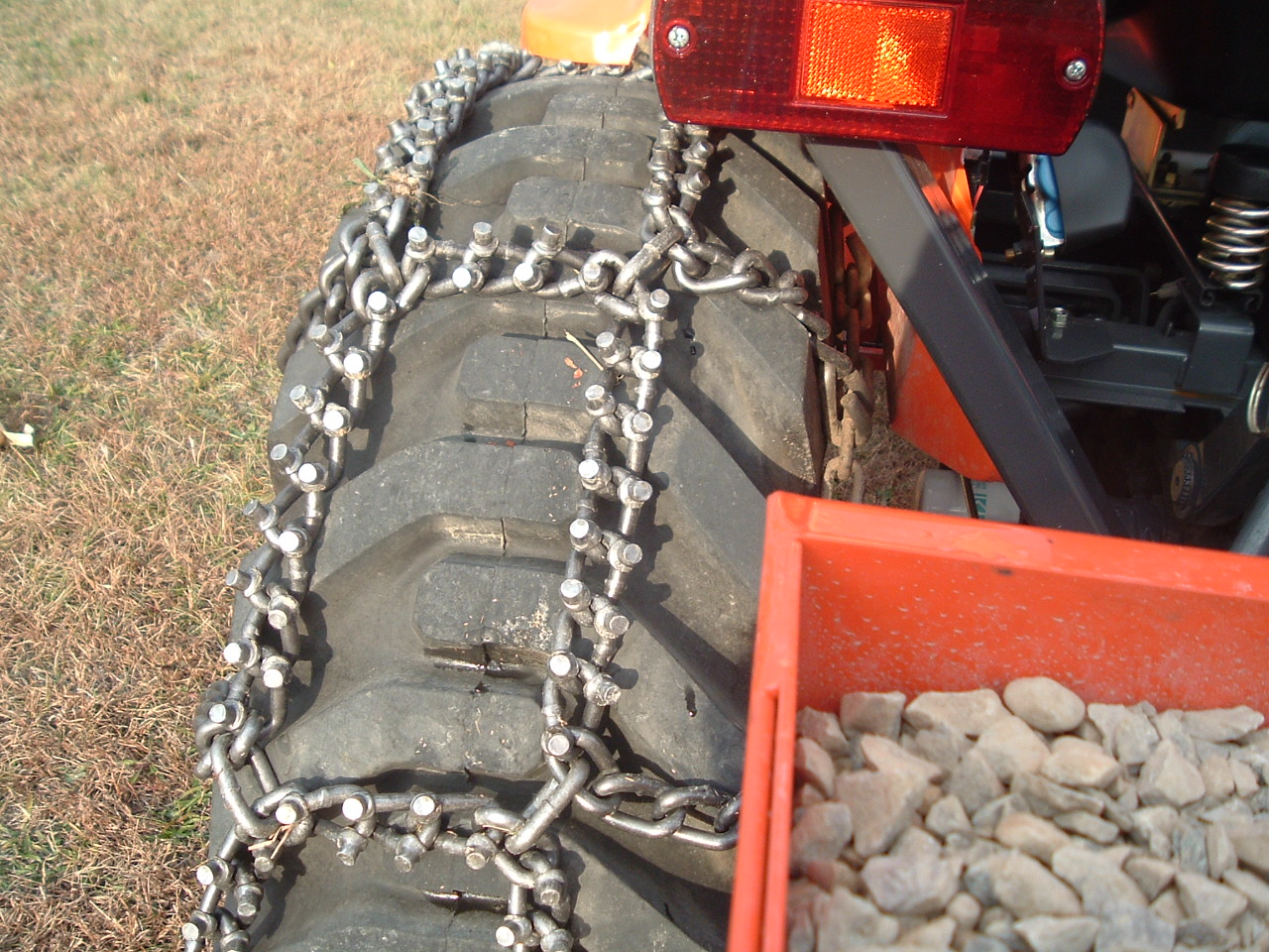

These have worked great the last 12 years.
/ Tire chain recomendations #8
That be strange to me. I ran ladder chains on my Ag tires for 23 years and never had a complaint from the traction dept. I think there is a perceived problem, not a real one.
But anyone is welcome to buy more expensive chains if they prefer.
I don't have a problem with it at all. :D
Just feel it is misleading to our new members looking into putting on chains at reasonable cost as they can get by with, when ladders work ok on R-1 and R-4.
I'm a bit puzzled at it.
HUGE difference between R1s and R4's
