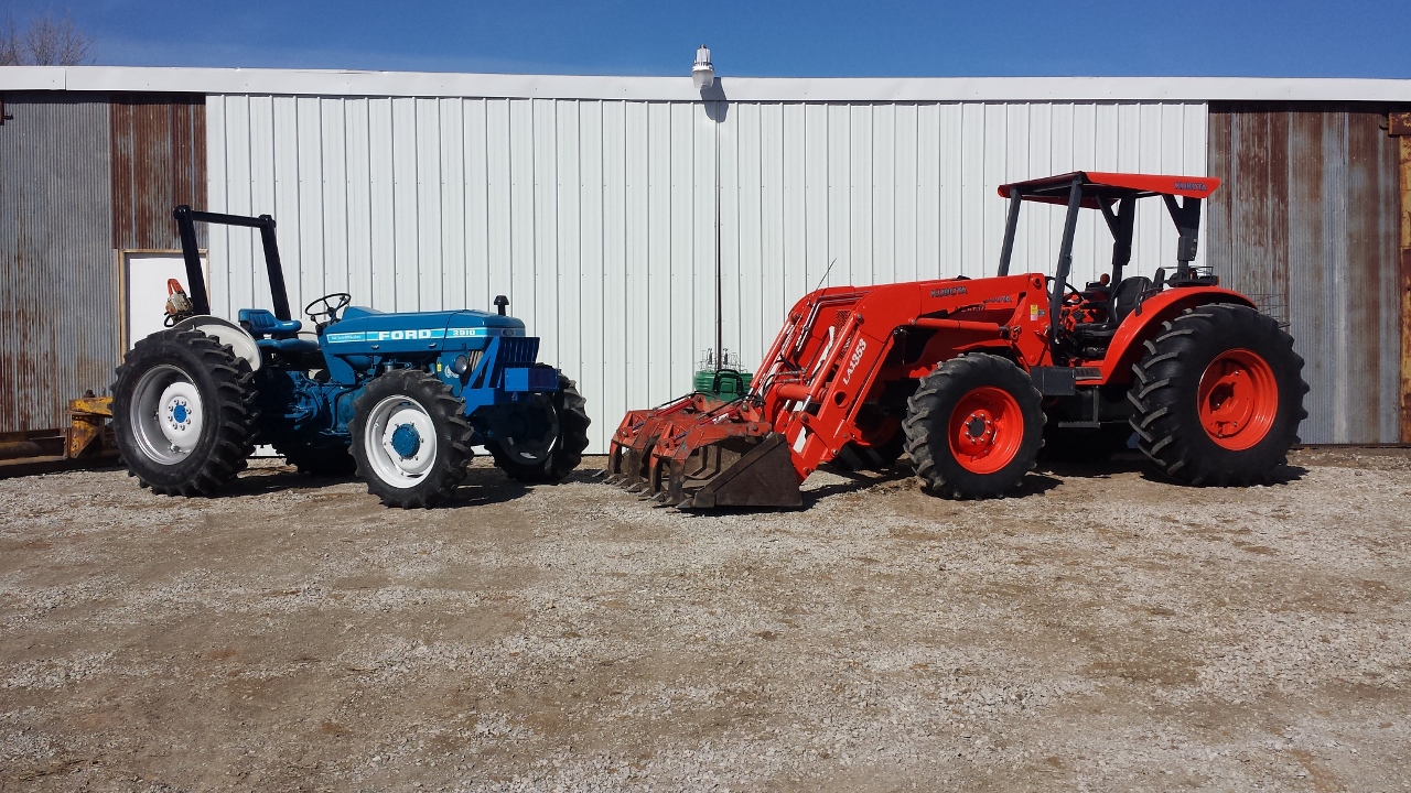

I run fluid and cast iron weight ballast on my Kubota with FEL. I don't run any rear tire ballast weight on my Ford. Reason being I want it to remain lightweight. I am working in the timber now with a tree puller removing small Cedars. The Ford easily moves around in the soft timber terrain. It weighs around 5500lbs. When I take the Kubota into the same area to haul off the pulled trees I have to be cautious about going into the softer areas to prevent severe rutting. The Kubota weighs around 11,000lbs.
