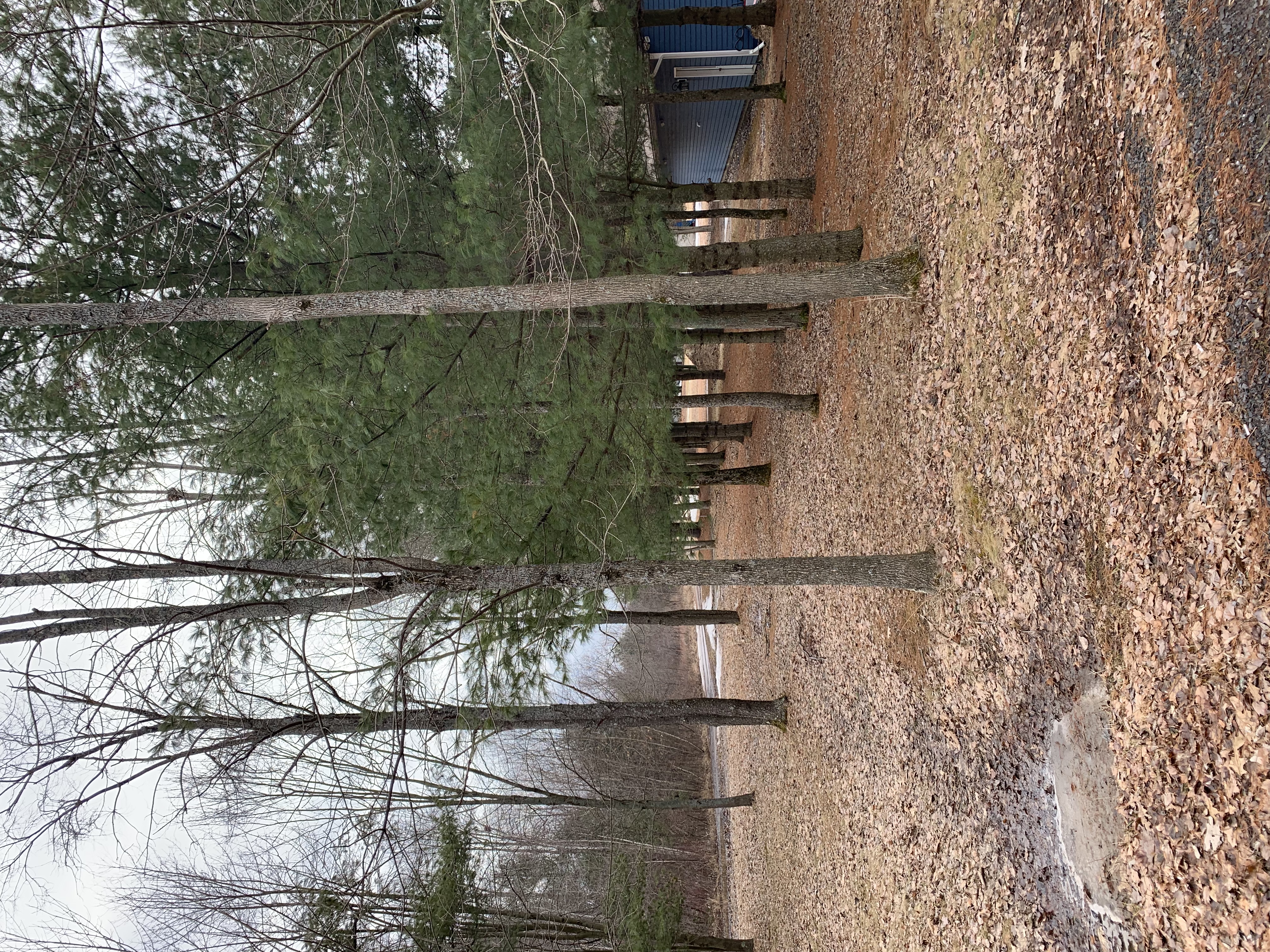

After a few attempts I finally got this to upload!

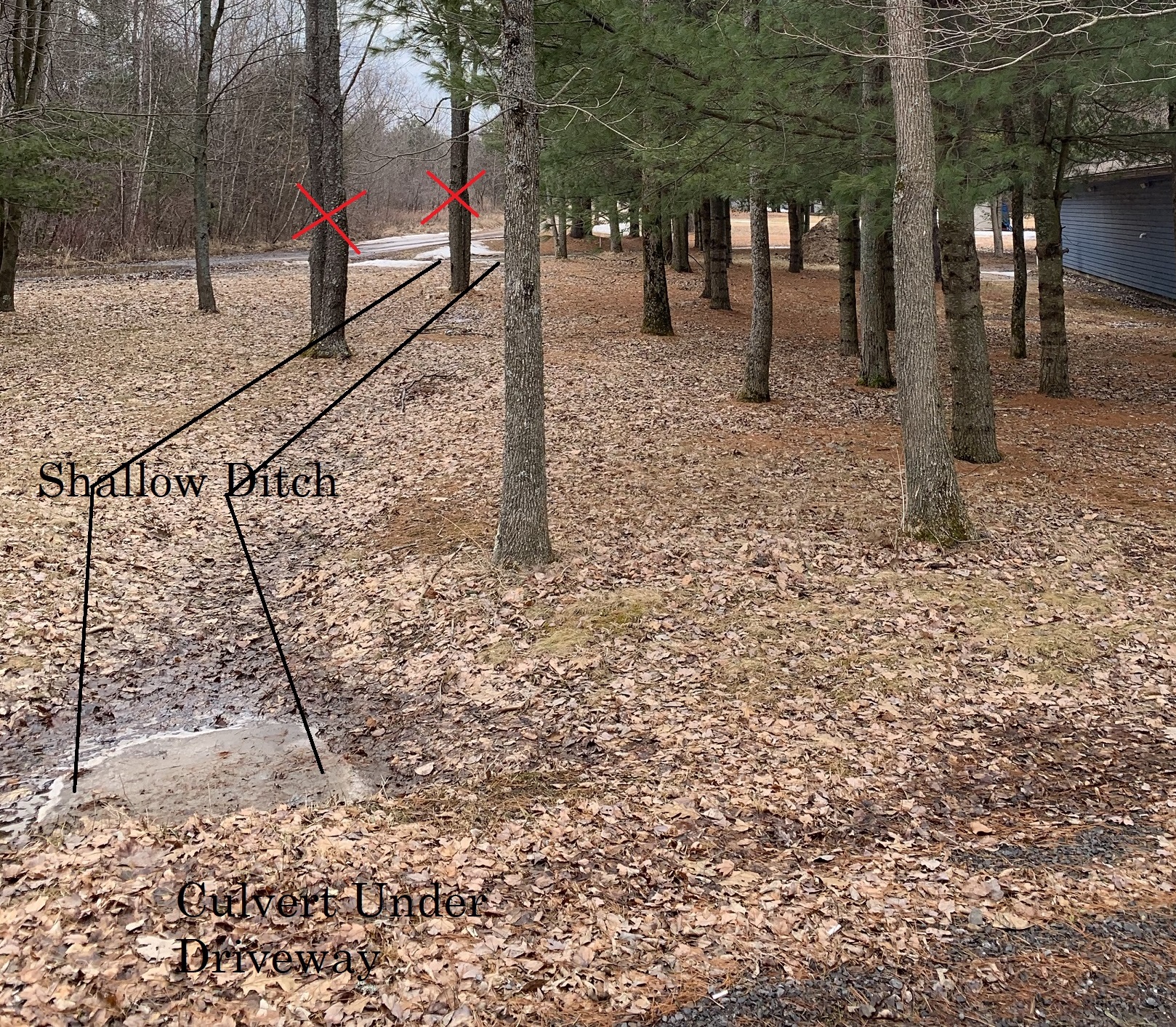

It will be a lot easier to redirect the water. I'm not sure about your water flow, but this would my initial plan.
I got a good chuckle when you knew that puddle was a culvert. You must really know your stuff. I think thats a pretty good idea and I might roll with it. Only problem is I would have to wrap around the side of my garage down to the river bank...or else I'll flood the neighbor. There is a house about 50 feet past the end of the garage.
/ Tips for my spring project?? #26
You really have to determine what the water flow is. Direction, volume, ground saturation. It looks like the ground beside the garage doesn't drain anywhere now, so when it rains, can't absorb any more moisture, so everything just flows off. Keep an eye on things when it's raining, look at the patterns. You can't just dam off things, they have a tendency of washing out, causing more problems. The backhoe gives you a great ability of being able to install 8" culvert, or 4" plastic (drainage tile/french drain). Avoid digging any deep ditches. A gentle swale that allows a riding mower to cut without scalping is just as effective, just takes a bit more room (which you seem to have). Get a plan, do it in sections, evaluate. Nothing worse than getting everything done and finding you still have the same issue.

I think my new plan is going to be to try this in stages. Trees first. Then clean out the pine needles and other foliage. (The culvert has been neglected, on both sides.) Still till and level (it's pretty bumpy under all that.) And then maybe try a swale first down to the river and see what happens.

Why would you get rid of all those trees? Seems like a lot of earth moving and cursing for nothing. Go with water redirection. Plus some of those trees are gonna have a **** of root system down there that your box blade is not gonna contend with.

Yeah, I agree, especially since you have a TLB. Dig a trench, install drain tile (hard PVC would be my first choice) and call it done. Cutting down or working around all those trees to adjust the grade just sounds like a whole lot of work to me. Frankly, if I was feeling lazy, I'd take the picture with the "proposed ditch" on it, put on a plow, and just plow a deep furrow (which will take a few passes because of the tree roots, for sure!) along that path. Level out the scarf with your BB and call it done. I use my plow or my rear blade a lot to move water around, both work well depending on what I'm trying to do. If you do use drain tile, go with 6in, it'll last a lot longer and move a lot more water.
