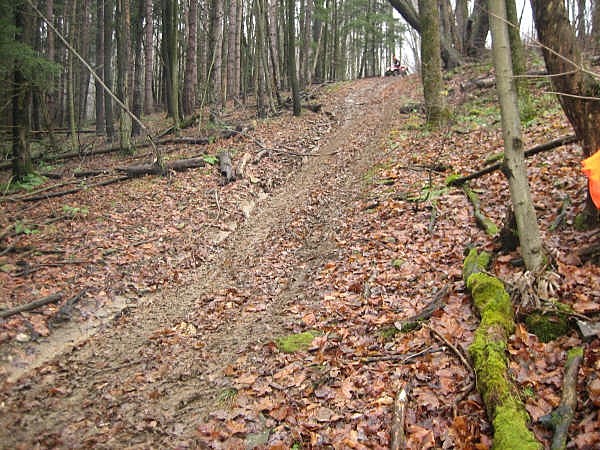

I always back up the hill because I usually don't make it the first couple of tries. It's pretty washed out in the spring from runoff and very difficult to get up. I have a box blade on the back with rippers extended. I carry the box blade low to the ground while climbing in reverse and when I lose traction I drop the blade and drag that little section as smooth as I can when descending. Then I go in reverse again and hopefully the section I just dragged will let me get a little more traction and continue my ascent. When I get to the top I spend all day dragging the trails because it feels like a conquered Everest. Here's a pic of my steeper section but what you can't see is all the off camber washouts....Nice and slow is the only way to go. I wouldn't even think of trying to go straight up with the tractor. Lose traction and then what???
