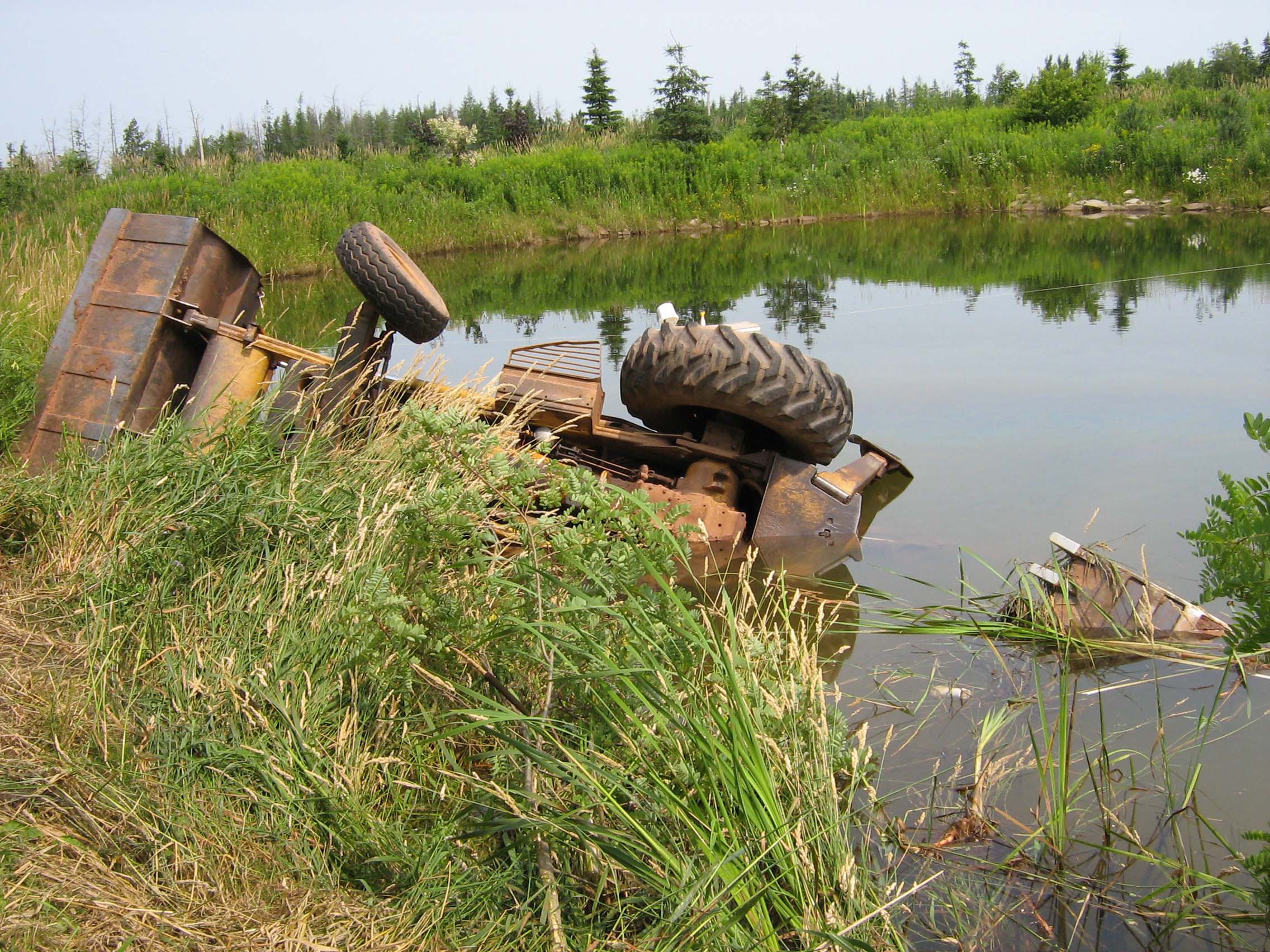

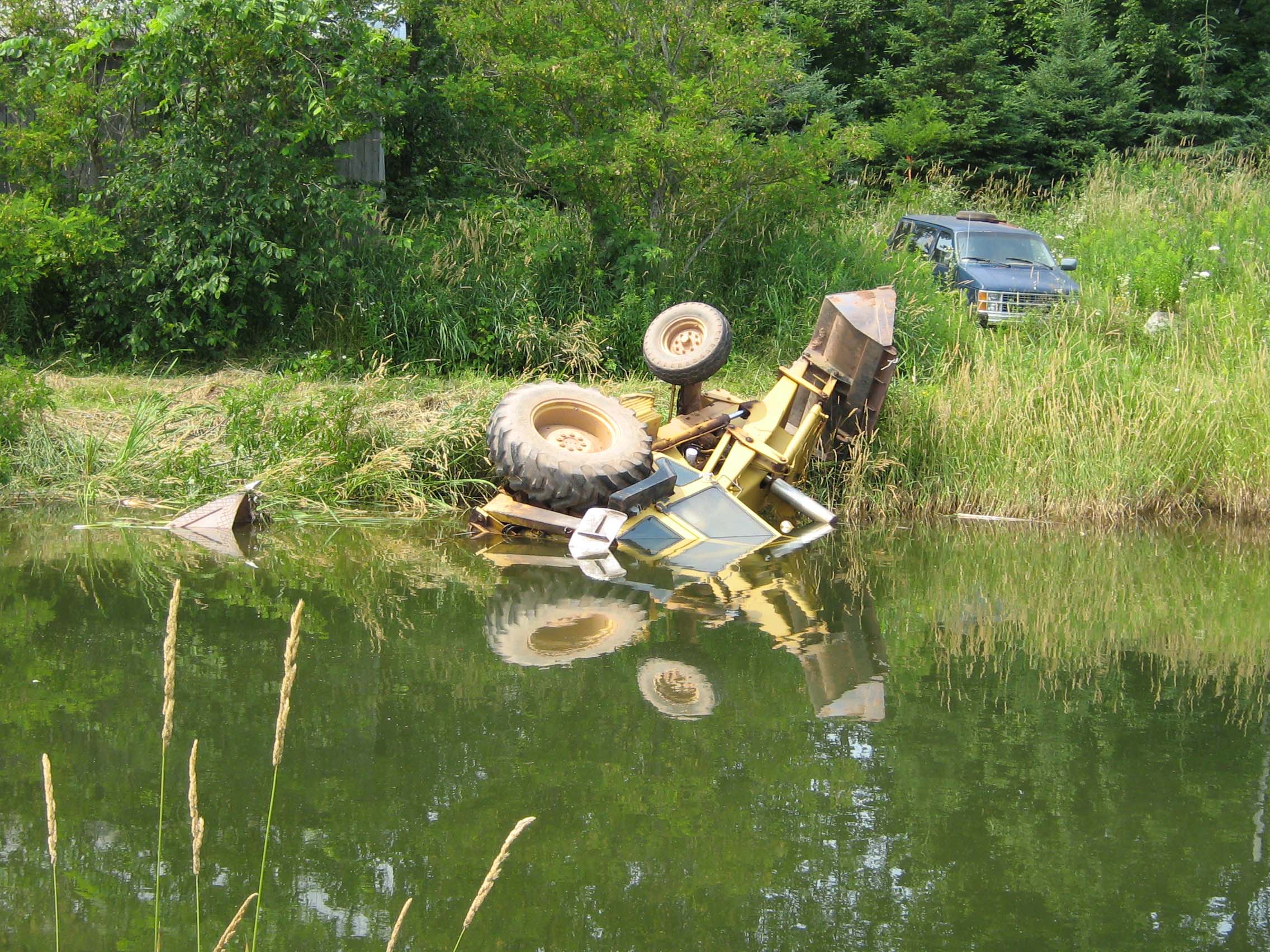

Glad to see you were not hurt in the flip. As the hours rack up on a piece of equipment you get a false sense of security in what it and you can do safe. Sometimes either because its late, your in a hurry, or just plain stupidity it will quickly bite you.
I have over 2,000 hours on my TLB and an early morning slip (coffee didn't kick in) coupled with a tad bit of attitude taught me a lesson last fall I will not forget soon.
I went from having one wheel over the edge to the resulting pictures because I thought I was good enough to get out.

That looks like a real heart breaker. How did you get it back out?

Love to see the recovery photos of that one....

Sorry 96superjet, didn't mean to but into your post. Just pointing out that being carefull on any piece of equipment can be the difference between sipping a cold one and being planted.
As for the aftermath for me it involved a 200ex excavator to dig a hole beside her and tipping it back on its wheels and the taking my old d6 and pulling it onto the bank.
Excavator $400, Front and back window, $600, changing all the fluids (all 35 gallons) $500, being alive to laugh and learn, priceless!
