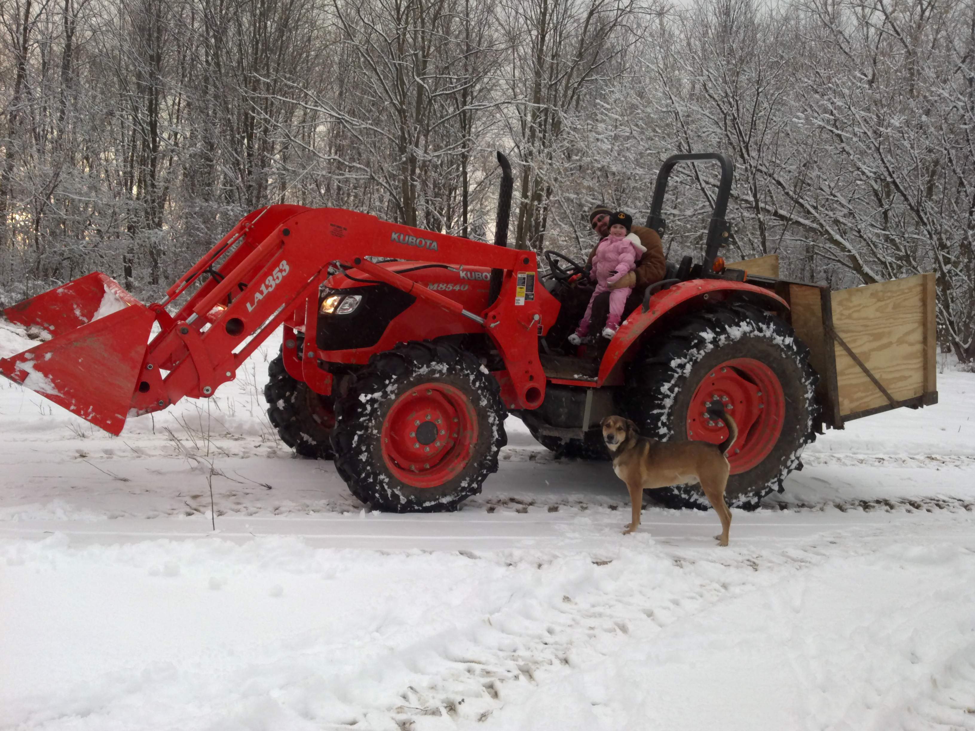

according to the PDF on stability that vtsnowedin posted it can be approximated around 10" above the center line of the rear axle. These pictures show where i normally carry my ballast box aka my carry all if it has weight in it the cg is definitely higher than 10" above the center line of the rear axle. The Cg of most tractors will be several inches below the drivers rear end assuming the loader is down low and 3 pt implements are not really high in the air. I don't want to drive over something like a rock or tree stump and rip my ballast box off my tractor same can be said for backing up.
Sub compact owners are more worse off than larger tractors i would be willing to be that most of the time with their ballast boxes they have the 3pt about as high as it will go to get descent ground clearance and departure angles so they don't get stuck on stuff when changing grade. SCUTS are going to be more likely to tip than larger tractors as a bx is 44" wide larger utility tractors are nearly double that in width. Larger tractors can carry the FEL 3 feet off the ground with a load and lower the CG of the tractor. SCUTS having the loader 3ft off the ground with load likely raises the CG as my buddies Compact B2400's hood is not as tall as my front tires which are about 3feet tall. .
