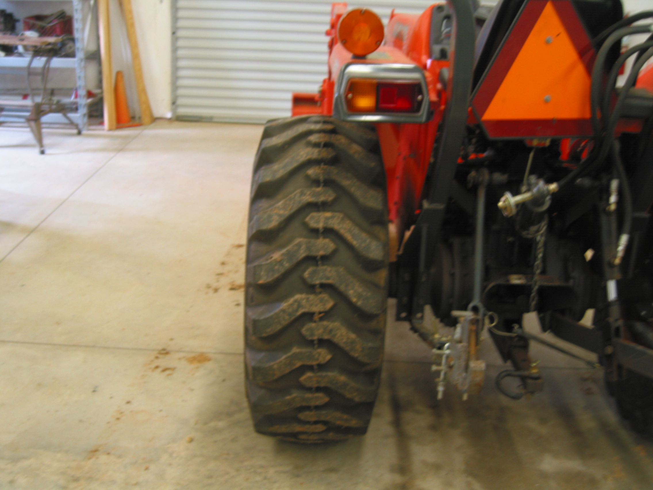

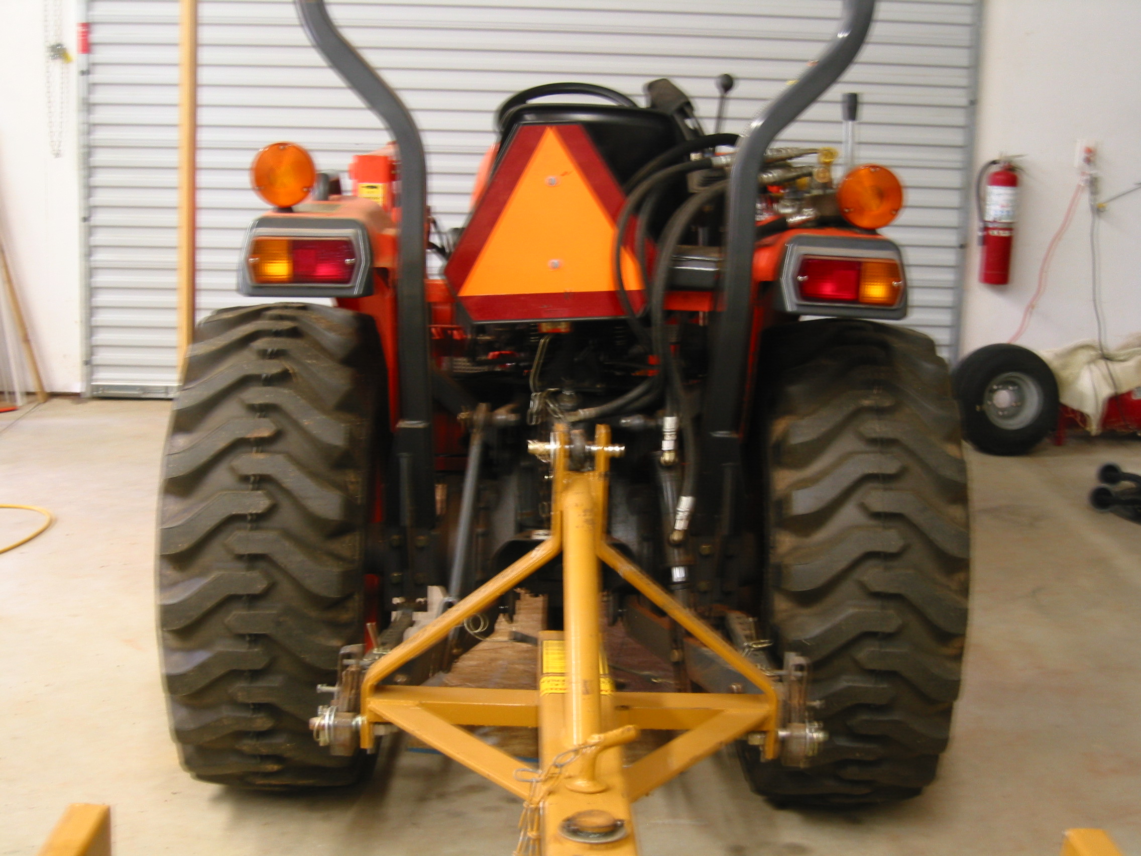

I just bought a set of Bro-Tec wheel spacers for my L3400. Top Quality workmanship, complete package with all the bolts and nuts for your specific tractor. Here's a picture of mine before and after installing a set of 2" spacers - extending the width from 54" to 58".
I can't speak about stability improvements yet as I've not had a chance to get out in the ruff. But I"m hoping to feel a good change - in my opinion the little L3400 is not very stable, as least not compared to my old Fordson Dexta.
