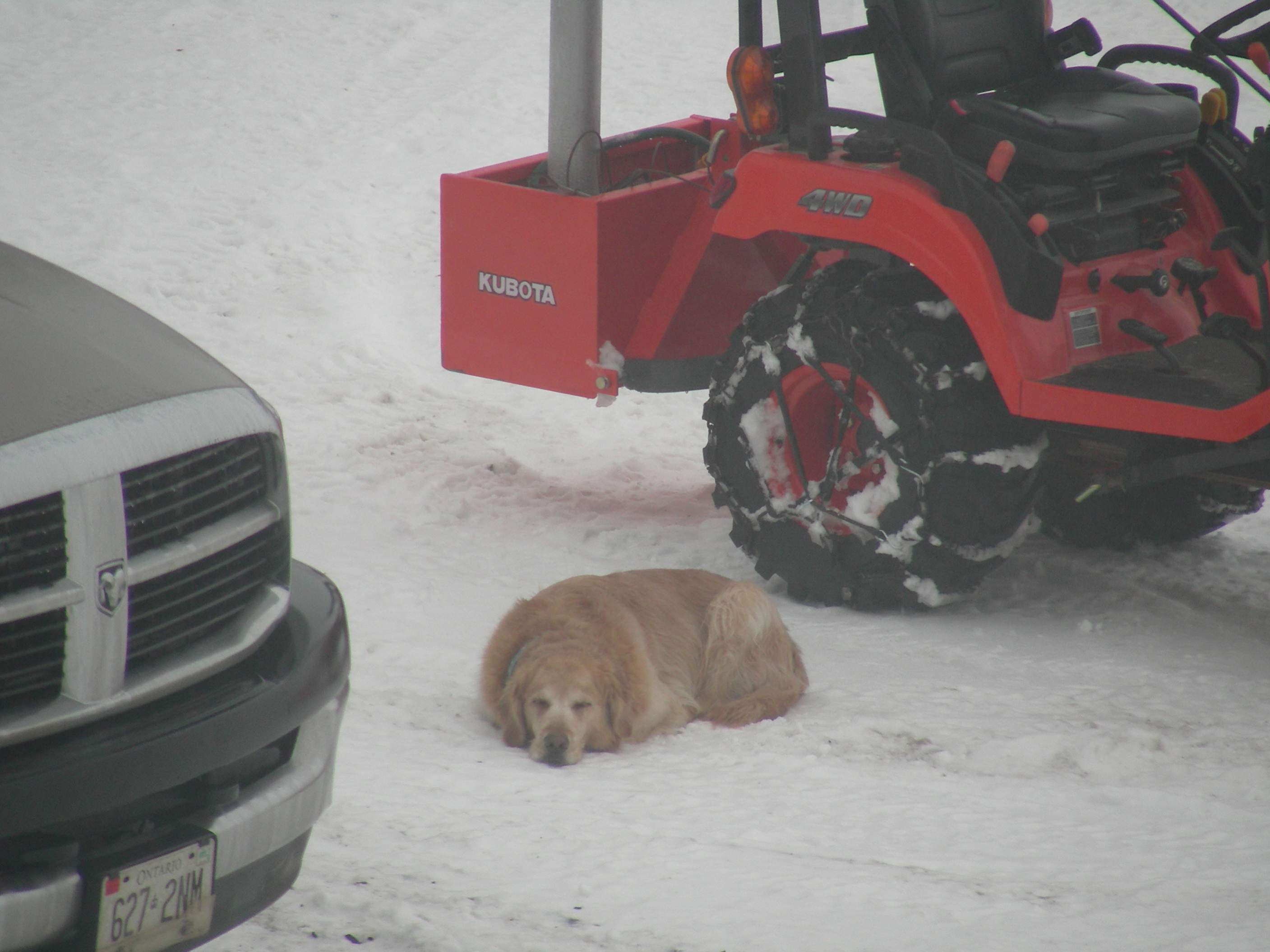

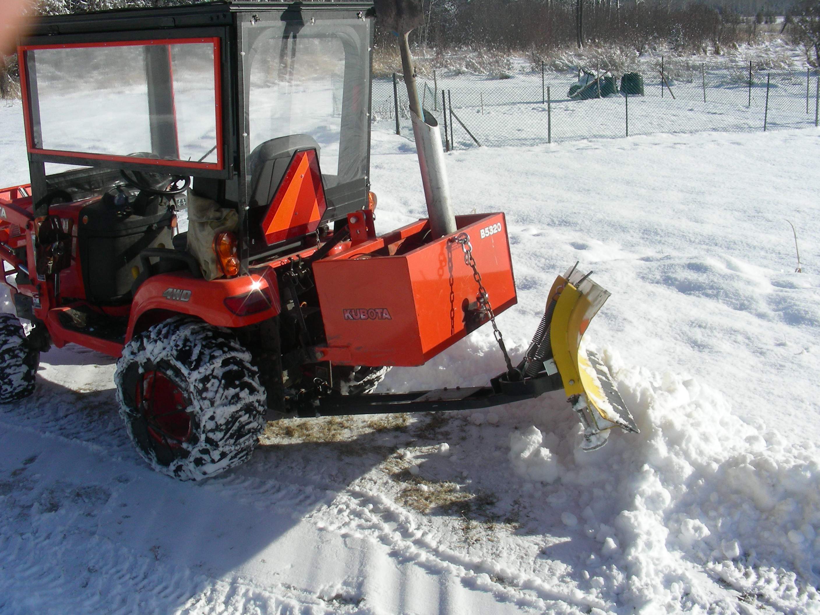

Someone on this thread asked if I had pictures of my tractor with spacers, see the second one below in 2009 before spacers the first one is in 2011 after spacers , you can see how the wheels now protrude past fenders. I guess added 4 inches to tractor width . As for whether I did the math for stability angles etc .....NOPE , same as I don't do the math on whether winter tires or chains give better traction , they just do , you know by the seat of your pants.
Looks like a pretty significant change probably over 10% increase in overall width I love your dog sleeping in the driveway.
Thanks Jake! I might check with my local bota dealer to see if i can get a set. Seems like money well spent, and does not look ridiculous.
I like the pic of your dog napping in the snow.
