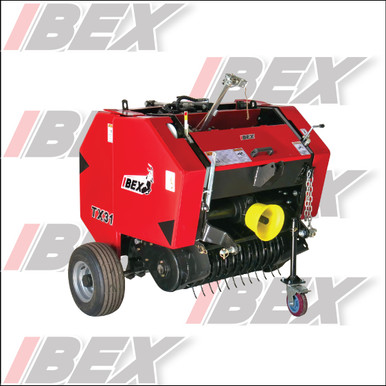

Found a few round balers. As I mentioned, these bales are really small. Maybe have a look. To me a waste of $$$ if you are looking at balancing the budget.
Yanmar YMRB32
/ Tiny tractor hay. #58
Yanmar YMRB32
I agree. For $7k-$13k you can buy a LOT more tractor with that $$ and find a used baler for $2k in working shape all day long. That's exactly why I punted our 35 for 75.. but I went a bit overboard not wanting to make the mistake of buying not enough tractor twice. We probably would have been fine with a 50-60hp tractor if had bought that from the start but by the time I was losing the equity, it wasn't much more to go up a little more $$ for much more hp!
