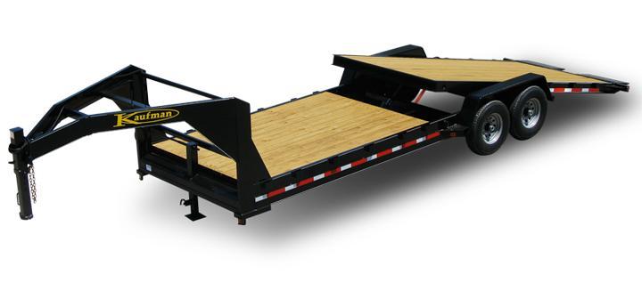

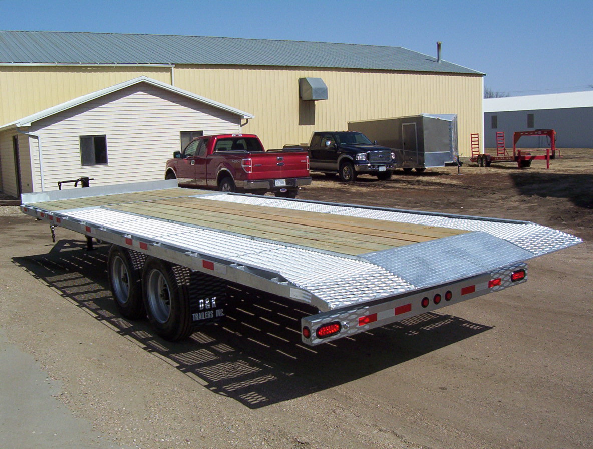

I am fed up with slide in ramps and don't like flip up ramps so I have decided to look at tilt trailers. I like the way Kaufman does their split tilt trailers. I have a second property to mow and would like to be able to take both a Zero Turn and my L5740 with a woods RD8400 on back. The trailer pictured below has a 10' fixed deck and a 14'6 tilt deck. My ZT is 7'5" long and the tractor with mower is 14'4" from the center of the front axle to the rear of the mower. My thought is to load the ZT first backing it up to the front of the trailer. Then load the tractor.
My thought is once the tilt has enough weight to lay down, where should the tractor stop. The ZD in question weighs 1400lbs so I'll have plenty of tongue weight. The tractor weight could be centered on the rear axles. Does this sound like a workable plan?
On tilt trailers in general, once you pull on far enough to tilt back flat, is that general far enough to balance the tongue weight?
This 24' 15k (14k) is about as long as I feel comfortable hauling. I would be interested in other brands with split decks and at least 8' of fixed.

I too got tired of using ramps. In late 2005 I bought a new 2006 20' MX speedloader from an H&H Trailer dealer. I have used the trailer quite a bit and like the way it handles. Mine is a bumper pull but they have goose necks also. I also changed mine from manual tilt (using the manual hyd. jack) to electric / hyd. and added a winch. Mine is power up and gravity down using the lever on the power unit to release pressure. That means it stays tilted till I release pressure on the pump. Check HHtrailer.com to look at their models. On the gravity tilt you mentioned once you pull on far enough to tilt it down I pull fwd. another foot or so but that may differ depending on brand.

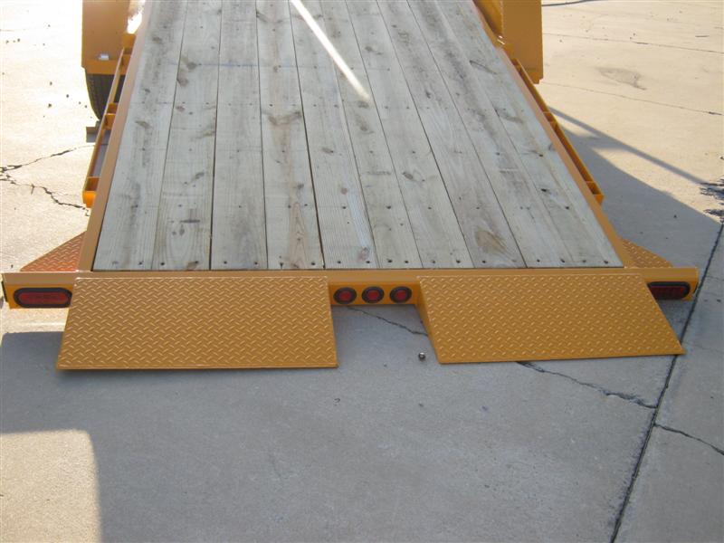

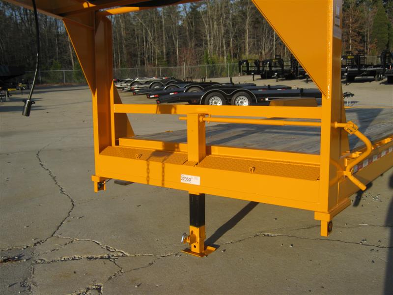

Here are some pictures the Kaufman salesman sent to me.
12-19-11 011 (Medium).jpg 12-19-11 014 (Medium).jpg 12-19-11 020 (Medium).jpg 12-19-11 028 (Medium).jpg 12-19-11 041 (Medium).jpg

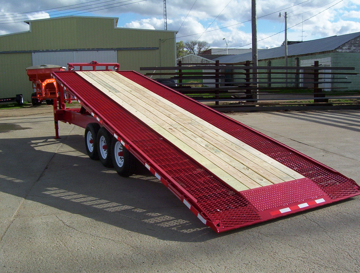

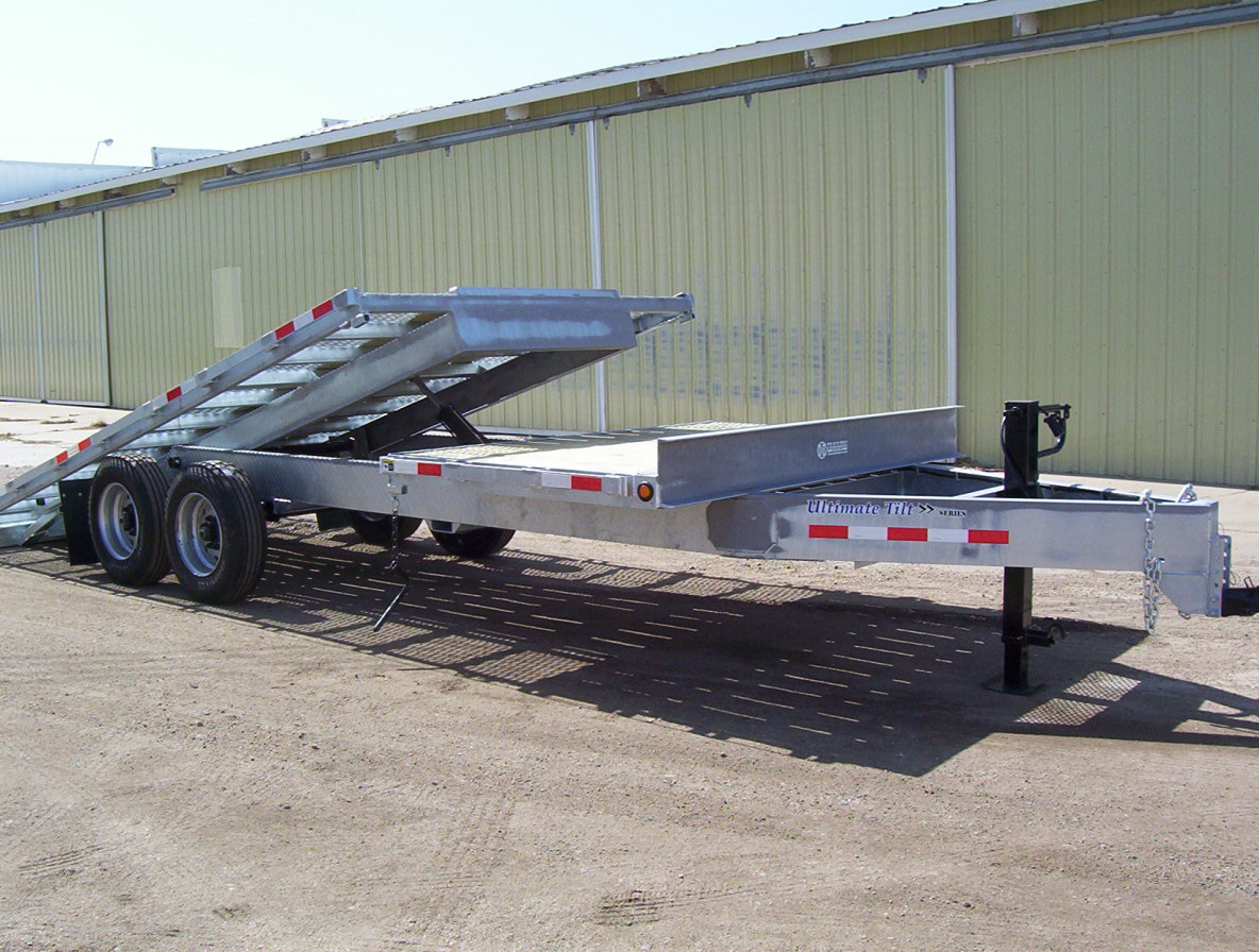

I am looking at a red, 17,000 GVWR / 24 ft. Equipment Tilt Gooseneck Trailer - DELUXE - Kaufman Trailers , with a metal deck.
Then I found two other builders that use metal grating.
I haven't called Frank to see if they would build one with the grating deck and how heavy it would be.
GN usually run 15-20% TW.
youll need to scale the hitch with your standard load to get an idea of were to place the tractor for the recommended TW.
those trailers usually have a curb weight of like 5K lbs so cargo on a 15K trailer is close to 13K with 3K TW.

How can it have. Pair of 8k axles but be rated for 17k?
D.
Yes and look at thieir 15k with dual 7k axles. Even the tire ratings don't quite add up. I think they factor in tongue weight to fudge the numbers up.

They rate the load on the hitch
I have been looking at trailers and really like the looks of the Kaufman trailers but also been looking at Econoline Trailers - Viewing 7 Ton Deck Over Multi-Purpose Tilt (16,100# GVWR) Technical Specifications
I also have gotten a quote on Maxey Trailers Mfg... We Can Do It!
which is the best looking set up I have seen so far. I am considering the Maxey with 8k axles and 17.5 wheels but I am pricing out material to build it my self also as I would rather have it set up a little different and the price is a little steep around $10k
