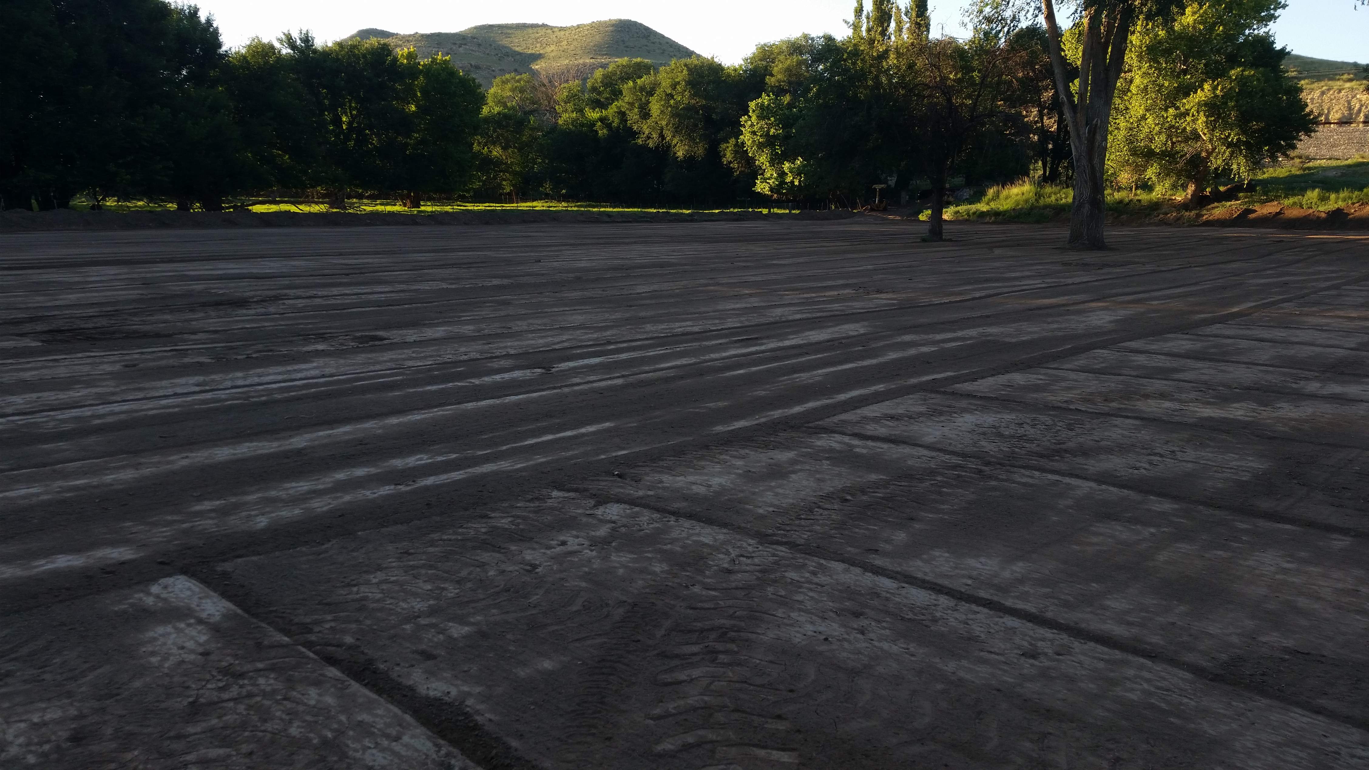

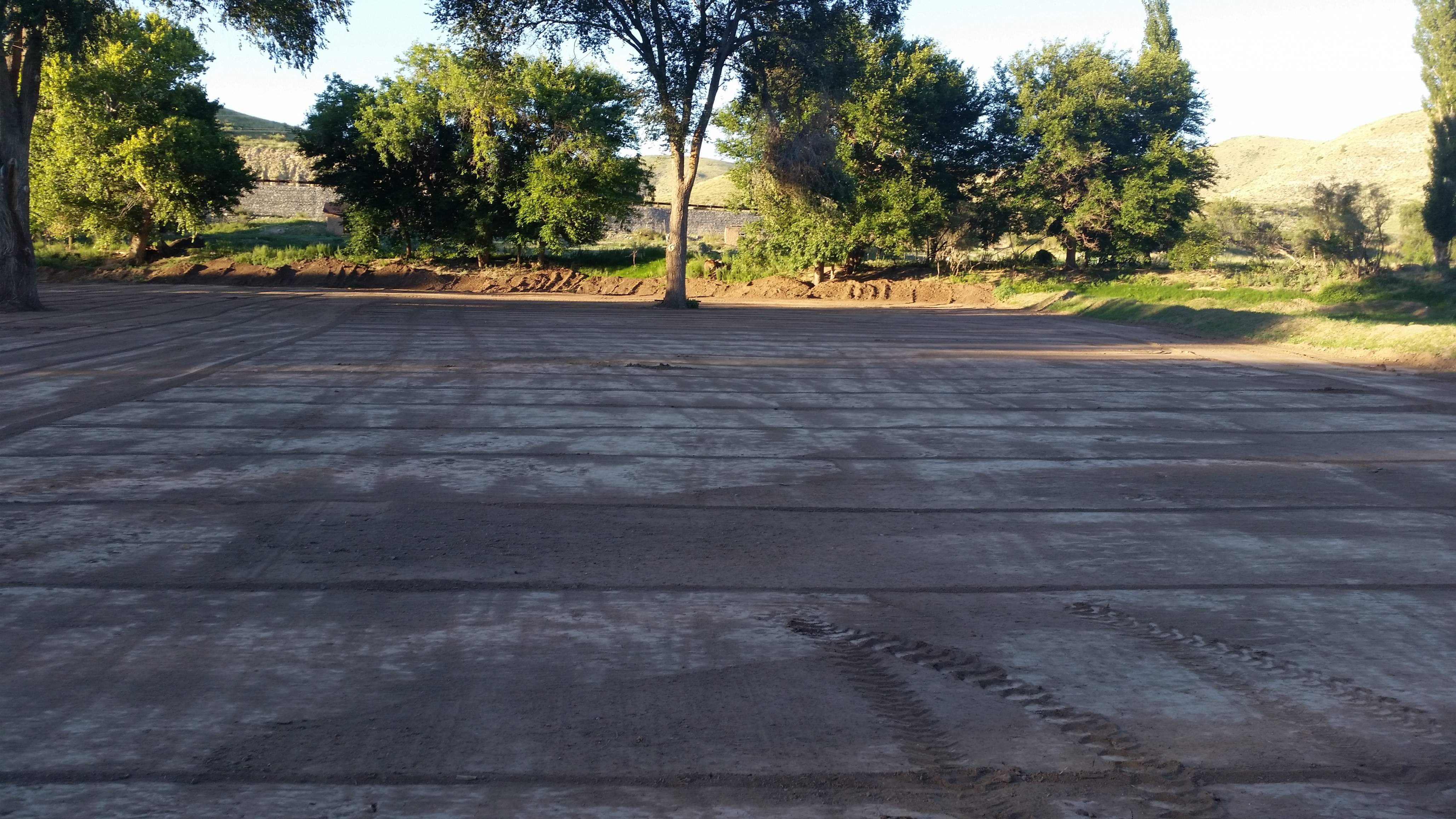

Right now is the perfect time to fix your lawn.
I would till it deep
smooth and grade with box blade
dress up with land plane grader blade
harrow it with a section type or chain drag
seed it heavy
cover with spike tooth harrow or my choice a pine straw rake
roll it to compact the seed
water it and keep it damp for two weeks or so till the seed is germinated.
that is what I did after cleaning up debris, and removing trees and stumps. Here is a picture after completion.
Nice!, but my land is not so flat.
I have a box blade, but what am I looking at for cost of a land plane grader, tiller, chain drag and a rake?
I am thinking till it, box blade it, chain harrow it, throw out seed and roll it with my small roller behind the riding mower?
/ Tiller vs my yard #27
I think you have your answer. You've seen it big and kept it simple. This way you will have a tiller for other uses. As for rolling, you are going to find your low spots after you do. If you aren't interested in a perfect surface, you can roll after you seed. But, if you are a perfectionist, the low spots will bother you. If you can, drag a timber or something behind the harrow. But before you do, spread half of your seed. After the low spots are filled in, sow the rest of the seed crosswise to the direction you sowed the first half. Then you can roll it if you want to.
